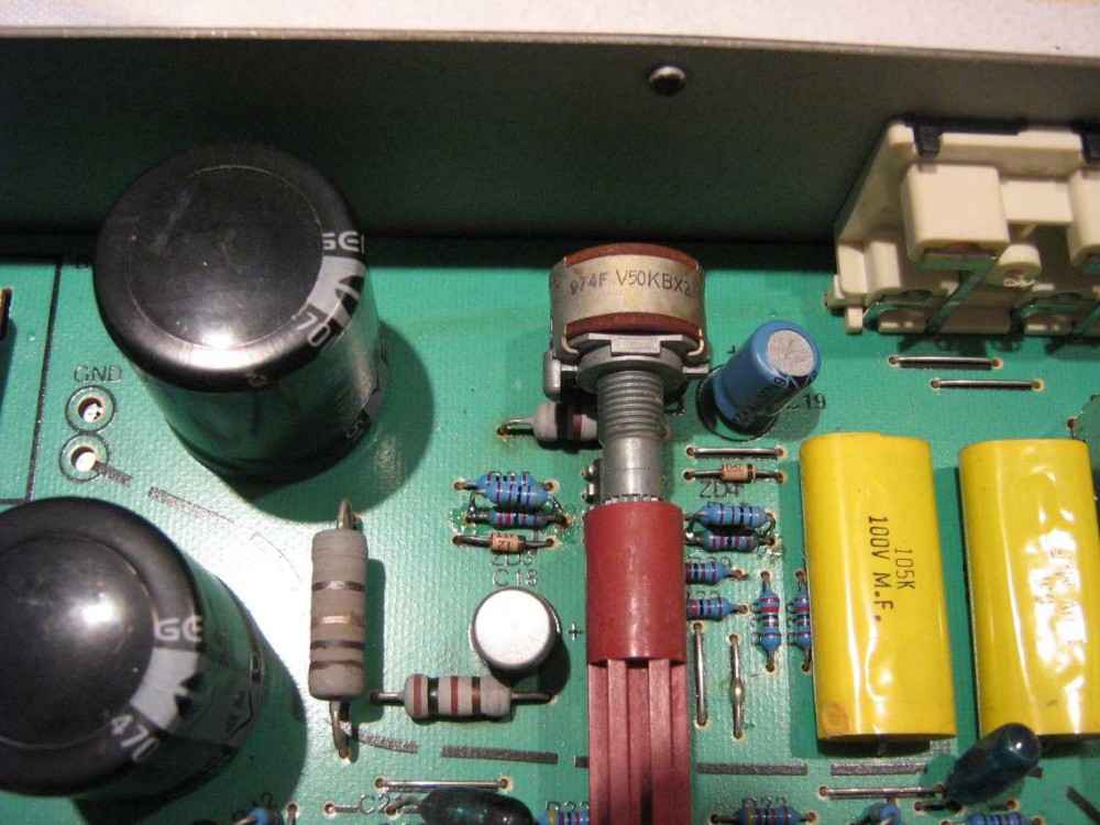

The amp needed some minor mechanical repairs to the volume control. On testing and listening I noticed that the amp reached full power very "early" on the dial - on CD or iPod sources, via line level in.
A test on the bench confirmed that it was reaching max power (on a full scale sinewave in from CD) of 23v peak, or approx 33W, at only 10 O'clock on the volume control.

The line-level preamp built around IC2 seems to be the culprit, with a very high gain of 23, set by R27/R28.
I reduced the gain to approx. 8, by just bridging 6k8 resistors on the topside of the board, across R28. This is set to reach max. power from iPod sources (approx. 1v peak) when the volume control is at around 4 O'clock, i.e. nearly full scale. The practical advantages being:
- Reduced chance of accidental speaker damage
- and as a side-effect, should also have better channel balance at usual listening volumes, due to more of the pot range being used.
Sonically the end result seems fine and the amp measures OK after the mod.
