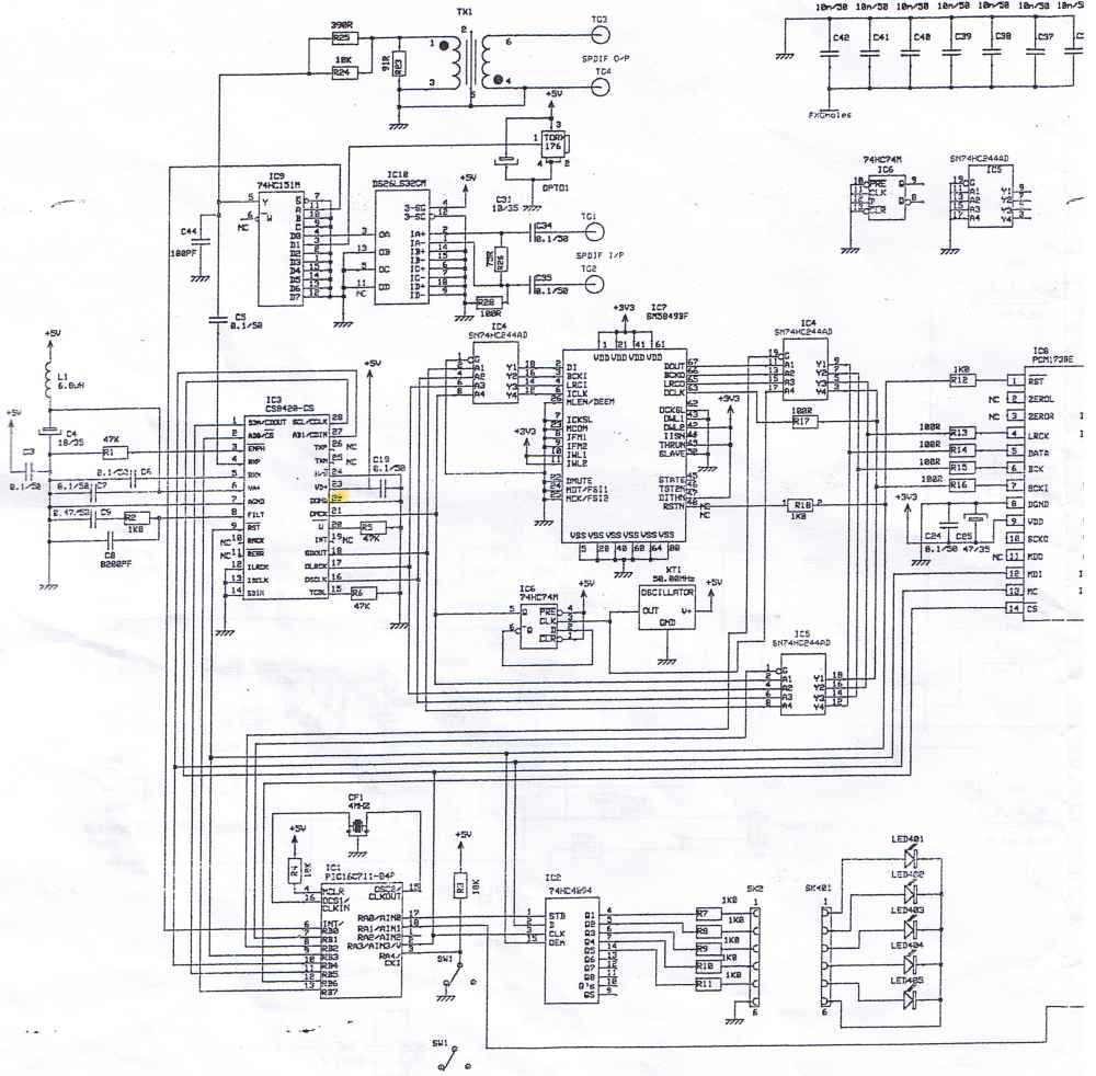

I have a MF A3.24 DAC with a failure of the coaxial digital input. The Optical input work OK and the DAC works and sounds great. My only problem is the coaxial input.
Anyone has experienced this problem? Can you recommend how to approach this repair?
If someone on the forum has the schematic for the A3.24 DAC that would be great.

I would guess that the problem is the IC10 the DS266L532CM as it it the only active device that would stop the coax input as the optical comes in after this.
Also are you sure it's not the coax output of your transport before you start ripping into this?

I have the same unit. Sometimes the signal fails to "lock" unless one cycles power. As you probably know, the bright blue LED in front indicates signal lock. Is it on?
If cycling power does not fix the problem, you'll need to get inside the unit to troubleshoot. For that you'll need a #10 Torx security wrench/bit.
As far as the schematics ... good luck. I've tried to obtain these myself but this company -- like many "high-end" audio/video companies -- are highly protective of their designs and only supply circuit schematics to official dealers or repair facilities. (Check MF's web site for more info on this.)

Maybe it's the way you ask, I receieved it (see previous post) this is only part of the circuit I have the rest if needed posted at other threads do a search under my name and you'll shall find all.

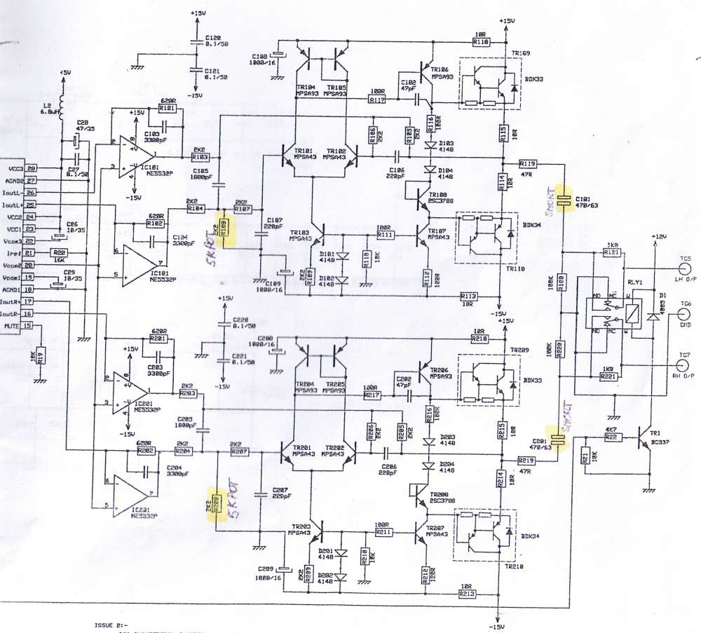

Also this dac is very good sounding out of the box, and if you do my dc coupling and I/V mods also in previos threads, it is so far unbeatable.

Thx for posting the circuit schematics. I've TRIED to obtain them from MF several times, but they always refused. Ditto experience with Theta and other commercial "high-enders". I guess I should've asked here!

georgehifi said:Also this dac is very good sounding out of the box, and if you do my dc coupling and I/V mods also in previos threads, it is so far unbeatable.
I assume this is the thread you're referring to. Although I've already played around with swapping op-amps -- using AD8620, OPA627, etc. -- and still think the moded Toshiba sounds better, I did not remove/replace-with-better/short-out the output caps. To that end, some Q's...
- In the aforementioned thread you wrote "put a digital multimeter on the output and earth". Do you mean put one lead of meter on the output JACK (hot side)?
- Would you recommend this same mod (one that uses 5k cermet mini pots) for DACs in general?

No the mod for DC coupling the output, only applies to this (A3.24) Dac as this DAC has a very powerfull low impedence discrete output stage.
The IC change is for the I/V stage which changes out the two NE5532's for 4 AD825's smd.
The DC coupling mod greatly enchances the sound, as does the I/V IC mod to a lesser degree.

Many thanks for the schematic. Sorry for the late reply, I have been offline for awhile. I will open the box this weekend to try to figure out what the problem is.
If memory serve me right, IC10 is an SMT device which could be a bit tricky to replace.

This is the best I can do off the A3 service diagram, it has all the values, as for more mods, yes you can do the Tent XOdac mods, I have not done this yet but Guido Tent has and he told me it made a significate upgrade to the A3.24, he was very expressive on how good it sounded, it is expensive and time consuming mod.
