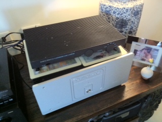

I've not seen inside these before, thanks for the pics, Bonsai.
What are the thick, square sections - heatsink extrusions?. Even at 2 x 10W, it must run hot throughout but that's nothing new for MF.
Are you contemplating a 250W version for a shoot-out? 😀

Hi Ian,
Yes, that's the A1 sitting on top of the 250W Ovation. That's got 5 pairs of 21193/21194 biased up at around 120mA per pair, so it's got a few watts of class A!
The A1 has an inverted U section inside and the output devices are mounted on this. The inverted U section is then coupled to the top plate with some Heatsinks compound and 3 screws.
Surprisingly good sound for such a little amp, and especially the idiosyncratic line stage.

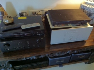

The cause of my mishap: two 2 pin mains sockets next to each other. One wired for 110 the other for 220. That's why it fried up.
I found out because I have a 1kva transformer that I wired up to take in 100vac in Japan and give me 220vac out. Well, I tired the same trick here and the transformer buzzed and the mains tripped. I checked my wiring, it was ok, checked the voltage on the input and it was 218vac.
Luckily, after I repaired my amp, I had plugged it into the LHS socket.
The CD player is universal mains input, and this was plugged into the 220vac socket, so I never suspected.
BTW there are four 220 sockets in the house. I would have thought they would have at least used a different type of socket.
