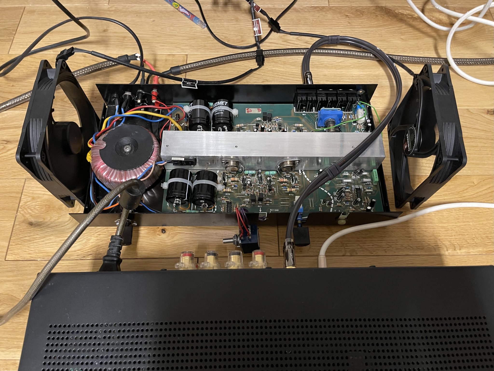

I am new to the amp and analogue circuit. I am currently rebuilding the A1. Recap and replace a few transistors and resistors all worked well.
Now I am annoyed by the noisy potentiometer in the line preamp section. I replaced with a new potentiometer, its still making noise when adjust the volume.
So I want to bypass the preamp entirely.

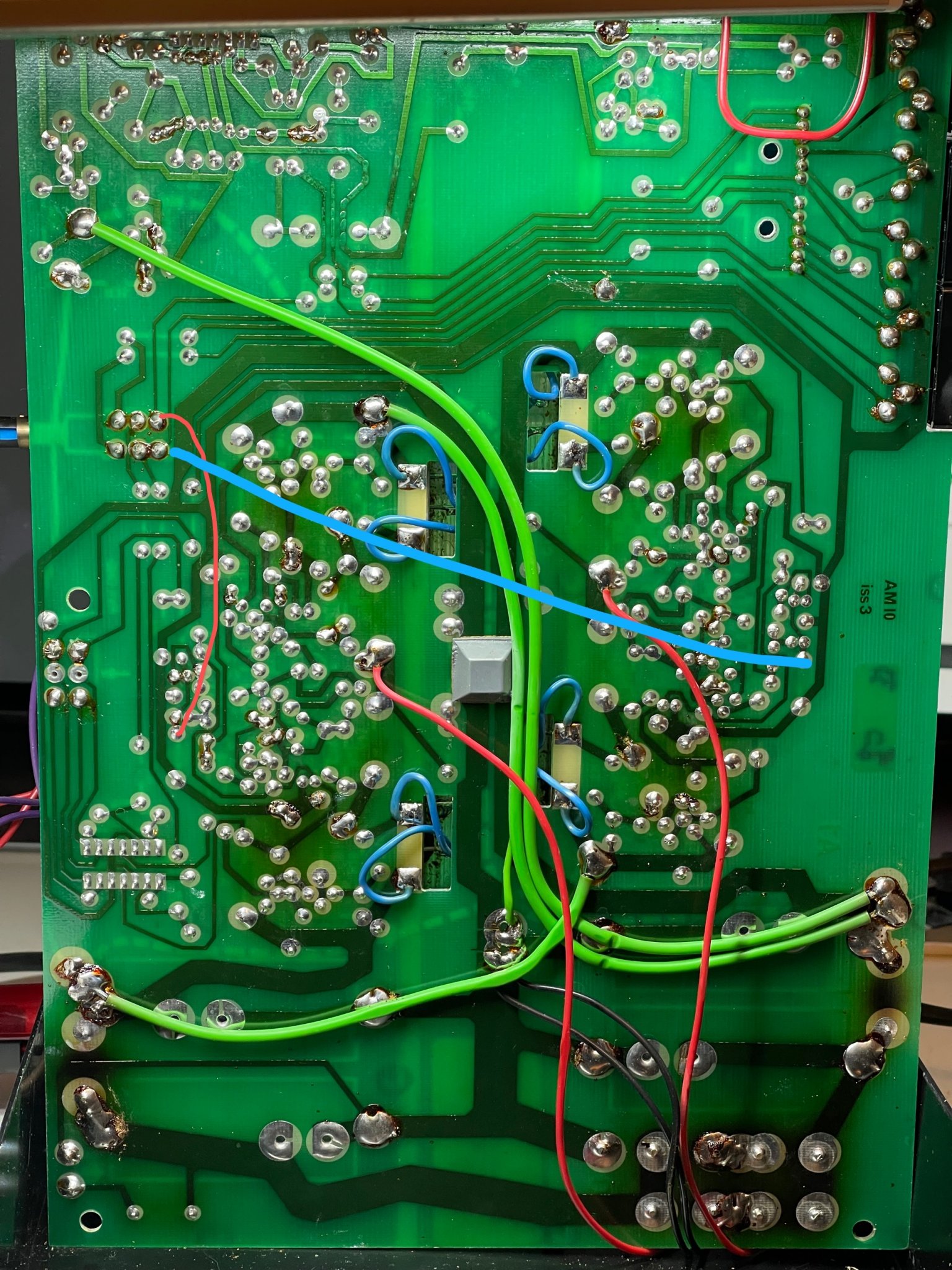

A1 has tape input which is stand alone( marked as “play” I think on the schematic attached below) there is a switch (SW1) between tape input and other inputs to separate them. So I tried to short the line preamp section, by wiring the tape input directly to the power amp input. The intention was so I when use the tape input, the amp acts as a power amp, while other inputs act as the same before.
See picture below:
tried it, didnt work well, it sounded very distorted and noisy for some reason.

Wiring a link there will make the IC fight your signal.
If you link as shown, it may improve your signal;
Change R4 to 12k.
I tried to rewire it to the right hand side of R4 as you suggested in your picture, worked nicely right away.
the other inputs worked just as before. So it worked as what I wanted it to be.
I didnt have a 12k resistor in my hand at the moment so didnt replace R4. Do I really need to increase the resistance of R4? How does it affect the original line preamp circuit if R4 value increased?

I actually found that direct feed from my DAC to power amp section of A1 provides enough gain for me already. The volume is now controlled using software on my PC, which I know is not optimal as software volume control brings in losses.
so I am wondering if I can just wire the potentiometer in to control the volume?
Remove R4, connect the signal to the right hand side of it

so I removed R4 just now, and problem solved! Absolutely no noise on either of my channel, perfect.
there are so many things can go wrong in this amp, input selector, potentiometer, so I think the best way is to just use it as an power amp.

This is how you need to wire it, plus remove r4.
