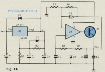

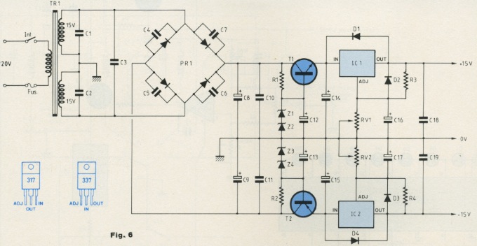

I am looking for something more advanced than the std LM317, and I found the two schematics in old magazines (LED):
-Schematic A
- Schematic B
However I have some questions:
- Can any of those schematics with a LM317 and a transistor handle up to 1.2A with 3.3V and 0.7A with 5V?
- What reference of transistor should I use?
Any advice/help on this is welcome.

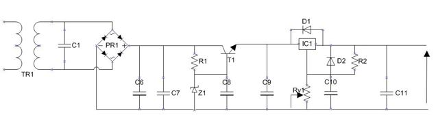

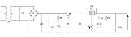

Values for the supply
I think I am going to try schematic B as I think I was able to calculate the right values.
If I understand correctly the schematic B, the transistor is a pre-regulation stage then the IC1 is the regulator.
I plan to use a 30VA Transformer with 2x 9v on the secondary. 1 secondary will be used for the 5v 0.7A and the other for 3.3v 1.21A.
So here are the values that I have calculated:

For 3.3v 1.21A
PR1 6A 600v
C1 0.1uF63v
4 caps for the rectifier 10nF 63v
C6 4700uF 40v Electrolitic
C7 0.1uF 63v
Z1 Zener 6v8 1.3W
R1 82 Ohm 1/2 Watt
T1 TIP31C
C8 10uF 25v Tantal
C9 1uF 25v Tantal
Rv1 Variable 1KOhm 1/4 Watt (Set at 386 Ohm)
IC1 LM317T
D1 & D2 1N4001
R2 240 Ohm 1/4 Watt
C10 47uF 25v Tantal
C11 1uF 63v
I have included the schematic in attachment.
I'd appreciate if anybody can confirm that my calculations are correct.
Thanks,
cdfr

I think the zener pre-regulator is of no use for the regulator. The end noise figure is determined by the regulator which in the case of an LM317 is in order of tens of uV. What DAC are you going to use? (Sorry, I can see what DAC you are planning on using).

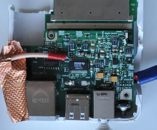

Well it's interesting to know that the AE uses the good old pcm2705.
It's a good chip, but will not do anything over 48Khz - 16 bit.
For the most part our music is 44.1/16, so no worries. But can you force iTunes and/or the OS to send 44.1 and not resample to 48K? Maybe on a Mac or Vista?
Funny to see that the AE, which has a USB port, uses a USB DAC. Hmm.....

what I read was that the pre-regulator with the zener would actually help reducing the noise. I made sense to me on the "Garbage in, Garbage out" principle. If the regulator input is less noisy than its output should be a bit better. But true it does not change the fact that the LM317 will provide at best 80db ripple rejection.
Schematic A which I think is a Sultzer could be better but I am not sure how to calculate the values for 3.3 & 5v as well as not sure if it can wistand 12.A draw.
From looking at the forum, Jung redulator would be even better but there again the complexity increases and I could not find if actually i works for 3.3v.

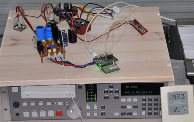

Update on AE Mod
I just wanted to post some updates on this project.
I completed Phase 1 (Power supply)
- The results were very good on both analog output and surprisingly on the digital output. It gave a sound with more detail, more subjective dynamic and wider soundstage. All in all much better than the original.
I have not started phase 2.
I also completed phase 3
- This turns out to be a big disappointment so far. I am not sure why but removing the built in crystal and replacing it with a low jitter clock (10ps 1ppm; suposedly as good as tent's clock) has not provided any positive results. I cannot compare with phase 1 anymore but it seems worse, still better than the original AE but....
May be the input wire is too long? I used a separate transformer, rectifier and a 1000uf cap just for this clock which is then regulated with a low noise regulation circuit (150db ripple). Any hints, advice welcome here.
A picture is attached.
So far the CD drive (Studer D730) is still a far better source.

Hi, very nice. Regarding your previous post, theory says that the zener will help reduce the noise of the 317 if you use it in the adjust pin (see TNTaudio). But you already have it running.
I also plan to upgrade the PS of my AE. How easy was to remove the casing? Did you have to destroy it?
Since my dac can take I2S (TwistedPear Opus). I plan on tapping the USB inteface an feed that to a PCM2707, thus bypassing the internal USB to SPDIF (at least that was how the old AE was configured)
If possible, can you show the DAC chip in your AE? Thanks...

Hi glt,
cdfr: Not very hard with a dremel, but you have to be careful not to go too deep.
cdfr: Yes you basically destroy the casing since it is welded.
cdfr: Ok so if I understood you well, instead of the std pcm2705 of the AE 802.11g you want to put a pcm2707 which can deliver I2S. Keep me posted on your progress.
For the pictures I refer you this link:
http://www.vonwentzel.net/ABS/Dissection-Express/index.html
http://www.vonwentzel.net/ABS/Dissection-Express/DSCN8883-pp.jpg
http://www.vonwentzel.net/ABS/Dissection-Express/DSCN8884-pp.jpg
This is the same model as the AE I am using (i.e. the old one 802.11g). If you find pictures of the new AE 802.11n, let me know I am interested to find out more.
My immediate worry for now is how to get the expected results from the clock, and adding the phase 2 (AES 110 Ohm output).

I completed the last planned modification (Phase 2). Creating an AES/EBU compatible Digital Output.
Basically this consisted in by passing the digital optical output of the AE and soldering directly on the pin 5 of the PCM2705 a cap and pulse transformer 75:110 Ohm.
This resulted in another improvement in sound quality when connected to my DAC.
After spending sometime listening to this last mod, I believe that the customised AE is now on par with my Studer D730 (used as a drive on the same DAC).
Not better (unfortunately) but equivalent, which is already a very good result since the Studer was a great CD player/drive and that the AE is cheaper, and gives the convenience of streaming audio from hard drive.

I just tried a new Airport Express change. I kept the two stage regulated power supply, but instead of feeding with rectifier/transformer, I used a car battery 12V 50Ah.
The change seems quite dramatic, the treble seems clearer and the bass tighter. At one point I actually wondered if I had less bass, but I think it is just less confused.

Basically I made 3x 3.3v supplies with LM317 & a pre-regulation stage, with a 12v battery as the source to remove all noise.

very interested in trying this out, I have plenty of spare reg PCBs that would be suitable for this. some SMD discrete super regulators and will have some spare salas/iko shunts
Let me know, how it goes. I am very pleased with the results, but as usual I am looking for more 🙂
With the pre-regulator & LM 317 I think I am getting more than 80db ripple rejection on the supply.
There might be changes worth while to do on the AE itself, but would need more knowlege of the schematic.
