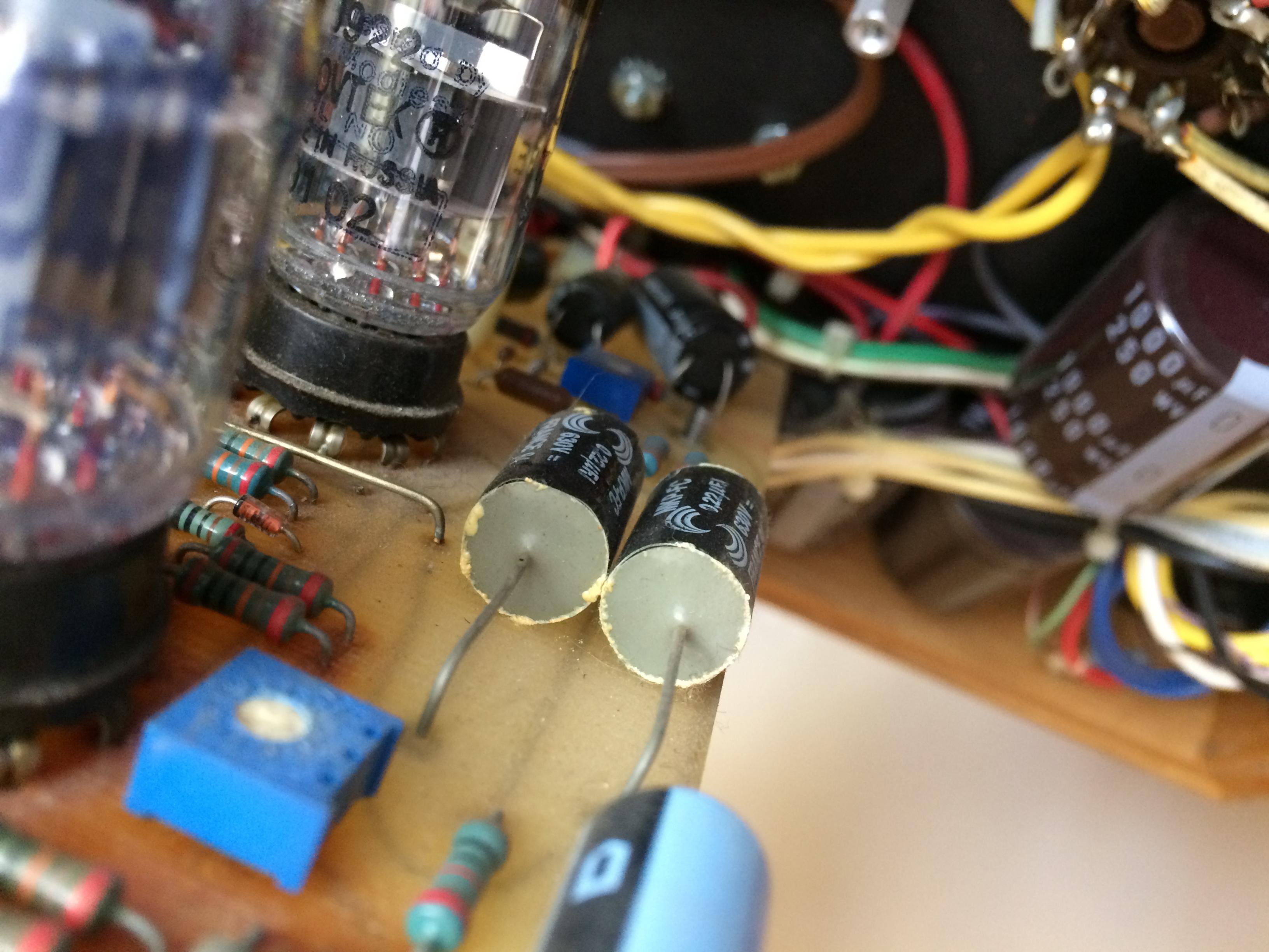

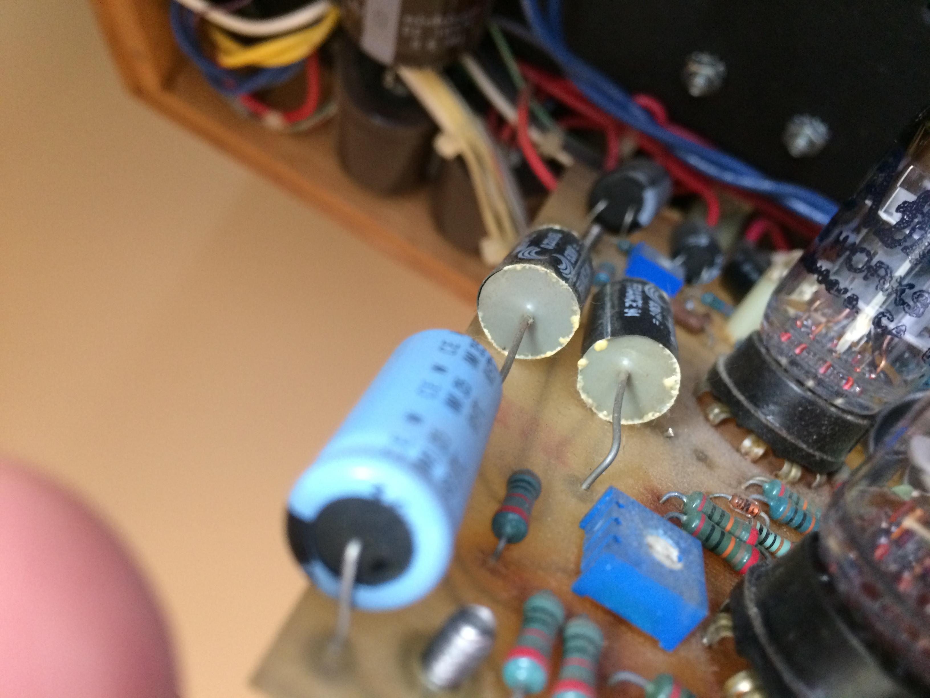

I'm looking for advice on my first attempt at amp repair. I own a Music Reference RM-9 MKII that's been sounding a bit muddy lately. Most recently the left channel cut out entirely. I popped the hood to find that all four coupling capacitors (Solen PPE 0.22uf 630v) are leaking. I've ordered 10 so that I can match and replace these caps, but was wondering if there is anything else that I should be looking for. I've also heard of people using a variac to slowly bring an amp up to full voltage after a repair attempt. Is this something that I should be doing? Any advice for a first timer would be greatly appreciated.
It's very unlikely that the metalized polypropylene film Solen PPE capacitors are leaking,
since there's nothing inside to leak. Maybe they are just glued down to the board.
More likely to degrade the sound after 25 years are the tubes and the power supply electrolytic capacitors.
You could first replace the tubes, and see if the sound improves enough to delay replacing the electrolytics.
If do you end up replacing the electrolytics, a Variac is good tool to have. They also appear to be hot-glued down.
To add to what Ray has said, if you had an electrically leaky coupling cap, you would likely also find that one or more of your output tubes glowing bright red.
You might want to post a photo here of what you see around the Solen caps.
Thanks for all of the quick responses! I've attached a pic of the caps in question. And I'd really appreciate a copy of the service manual. I've put together a Dynaco ST-35, and am comfortable with the high voltages, but need to do some reading before I could check voltages around the amp. (I'd have a tech look at it, but there's that thing going around and I've always dreamed about being able to service my own amp so now seemed like the time.)

Electrolytics look fine to the eye. The input tubes are old, but look in decent condition. Would a bad input tube just cause a channel to cut out all of a sudden? Is there anything else I should look into before I drop the coin on a new quad of 6922s?
That is the adhesive under the label moving around. You can measure the DC voltage on either side of each cap. One side should show some high positive voltage and the other side will either show 0V or some negative voltage. This is sufficient to test for cap leakage.
I would not replace those caps unless they actually measure badly. You may introduce new problems that you have to debug later.
