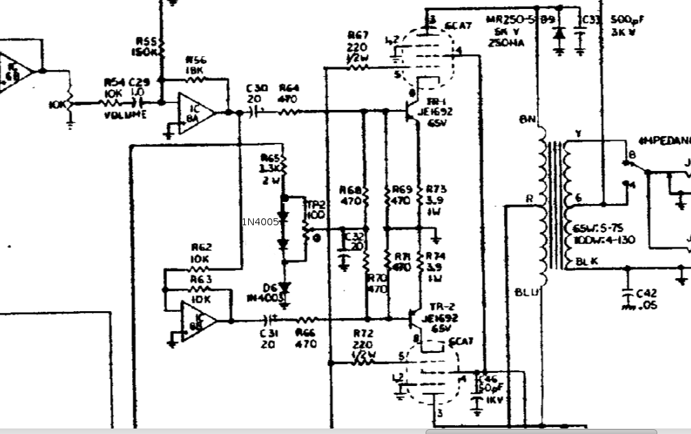

I have this Music Man that I am trying to get the bias correct with a pair of brand new Electro Harmonix 6CA7EH's. I have the bias maxed and I am only getting 17mV and 20mV across the emitter resistors, to make matters worse the emitter resistors measure high, 4R4.......4mA isn't enough, I am looking for at least 10mA I think. The service manual says a minimum of 25mV and a maximum of 55mV across the 3R9 emitter resistors. I am thinking of adding another 1N4005 diode in series so the pot can sweep from 600mV to 1.7mV. I attached a pic of my mod along with the service manual, if anyone can tell me if this won't work or why I shouldn't do it that would be great😀 I am no engineer but I think my proposed mod should work to get the current up throught the power tubes, I just don't want to blow anything up lol.

Your method would probably expand the adjustment range, but I have never seen a MM amp that needed such modification. These amps run close to class B, so there is very low idle current. COnsider the recommended range of 25mv to 55mv. I will just call that about 30ma as an average. 30ma through 3.9 ohms is only about 7ma of tube current. You are getting only 20ma, or 5ma, not much difference. Even at the top of the range at 55mv, that is still only 14ma of tube current. Or put another way, 20mv is only 20% out of range. Old Fender schematics always had a note that all readings were +/-20%, I liked that.
Your 3.9 ohms measure 4.4. Half an ohm? OK, short your probe tips together and see how much resistance they have, then subtract that from your readings. That will get the real resistance. Also, never hurts to reverse your leads and remeasure just in case there is some tiny residual voltage left in the circuit. That would affect readings. And another small factor. I can't imagine the resistors are tighter tolerance than 5%, and 10% would not be surprising. 5% of 3.9 ohms is about 0.2 ohms, so there is some additional bits of an ohm to work within.
Looking elsewhere, your grids are biased to +22v by the zener D7. Is that voltage up to level? If that zene is collapsing, the grid voltage could sink and the tubes would be driven less hard, which would explain both sides running cool. Since both sides seem to be running alike, I doubt you have bad transistors.
I personally think your mod is unnecessary, but as to blowing anything up, your tubes are not idling hot, and look at how the circuit works. Mod or no mod, at the bottom of the control setting the transistor base bias is one diode drop above ground. If you add a diode to increase the top end, that doesn't alter the bottom end, right? SO if you DO do this, just set it at the cold end first and watch as you adjust.

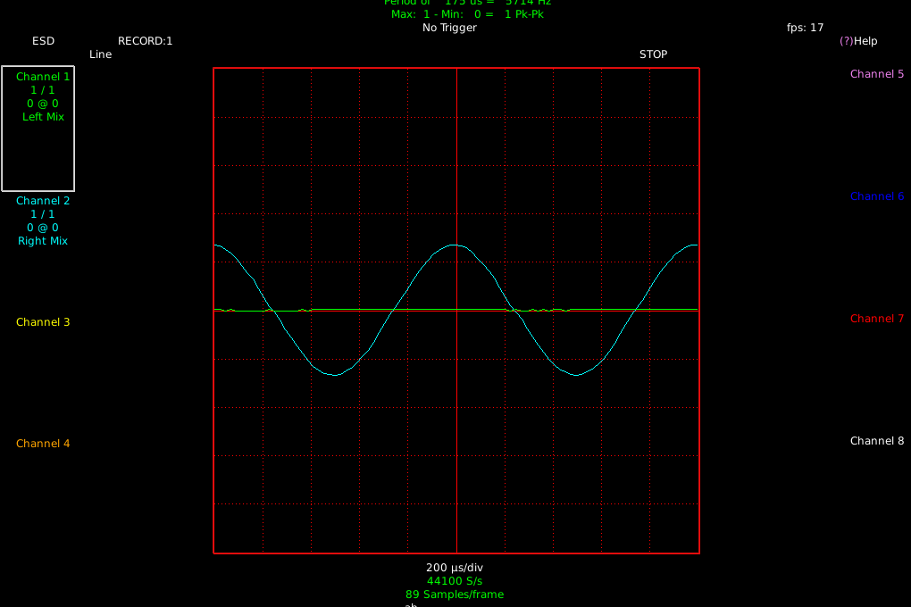

Hello Enzo, I have not got around to hooking it up to a speaker yet so I am not sure how it sounds. I was also going to look at it on a scope to see if I can see any crossover distortion, if I see the crossover distortion then I might implement the mod. I remember reading on another forum that these amps sound much better when you get closer to the 55mV bias. Anyway I think when I get the time to put it on a scope and see what the output looks like is when I will make the decision of what to do. I just wanted to make sure what I had in mind was the best way to do it, like you said the bottom will be the same which is one diode drop above ground, my mod should just give me more of an adjustment range. If anything the voltage drop across the 3.3k resistor goes down which will decrease the current through it, resistor rating there doesn't have to change me thinks.
I hope you at least have it on a load. You should NEVER operate a tube amp without a load. Ther is often crossover distortion in tube guitar amps. A few percents of it go unheard, and the amps are far from hifi by design anyway.
Use Ohm's Law, the 3.3k has about 45v across it if the diodes are a dead short, and that dissipates about 0.6 watts. Reducing the voltage drop by a half a volt will not make a difference. It is a 2w resistor.

And running hotter or colder may have some meaning in simple conventional amps, but here constant current is force injected into cathodes, whether they like it or not, by Op Amp and transistor controlled current sources.
A very clever circuit which pushes tubes to maximum power possible.

Hey guys output looks good to me, attached is an image at full output. I am going to hook it up to some speakers, I am sure it will sound good.

Signal enters the first op amp, gets a little gain, and is applied to the upper tube drive. Your 10k/10k second op amp is just a unity gain buffer that inverts the signal. SO whatever is fed to the upper tube drive causes the lower tube drive to send the exact same signal but inverted.

(Quote truncated).........common grid?
The grid swing of the tube is 50V.
The base swing of the transistor could be 50mV.
By putting a large emitter resistor under, the swing may be 5V but the 100:1 degeneration means the gain is constant down to very low current (bias).
The "tube input" (now an NPN) may be DC coupled (I don't think all MMs did this) for less grid-blocking.
It approaches a transistor amplifier except the heavy work is done by tubes. At the time tubes were perhaps more reliable in stage abuse, and could be replaced quick and cheap.
