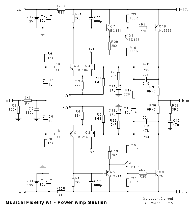

Stormrider said:Anybody ever cloned an A1? The circuit is simple with cheap/available parts. Supposedly it puts out about 8w in class and then up to 35w in AB making it an A+AB correct? Any PCB designs around?

I have a few questions about the function of this circuit. There is no bias control, so how would you set the quiescent current to 700-800ma like the bottom of the diagram suggests? Also, the dc offset output would relay on how well the input transistors pairs and drivers are matched, correct?
It will probably be awhile before i build this but i want to get some of the planning out of the way so i can collect the parts needed over time.
I'm going to use an 18-0-18 transformer so the DC rails will be +/-24vdc or so. 300va to 400va depending on whats cheap on ebay at the time. 🙂
I'm planning on using better transistors than those specified in the circuit since i already have them. BD136/135 will be replaced with MJE340/350 and BC184/214 with BC546/556. Anyone see any problems with these changes?
MJ15001/02 outputs are basically the same price as the 2N3055/MJ2955 pairs at digikey, so I'll probably go with those as outputs, or should i just step it up to MJ15003/04 pairs?
