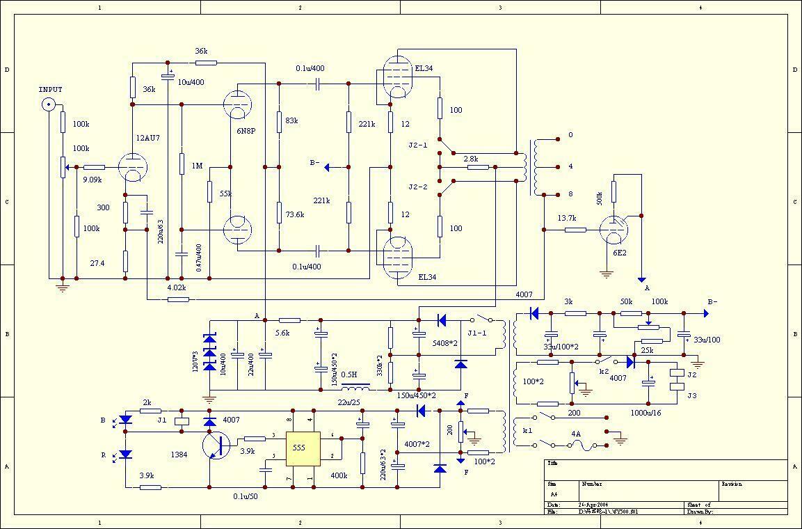

I found the wiring diagram online, my version is the XD500t. The input grounds are attached to chassis ground, this I removed. The 0 speaker lead is NOT grounded to the chassis, only the input wires ground (?). I wired the IEC ground to chassis ground, removed the input wires ground, and I'm waiting for two CL-60's to wire the pc boards ground to chassis ground to isolate the pc board ground, yet still have the safety of a chassis ground.
The schematic has different part values than the actual amp has, like the cathode resistors for the EL34's are 22 ohms, not the indicated 12 ohms.
I'm going to install 1 ohm 1 watt resistors in series with each EL34 cathode for a bias test point, and then use a 50 ohm 25 turn pot instead of the 22 ohm cathode resistor to adjust bias for each tube.

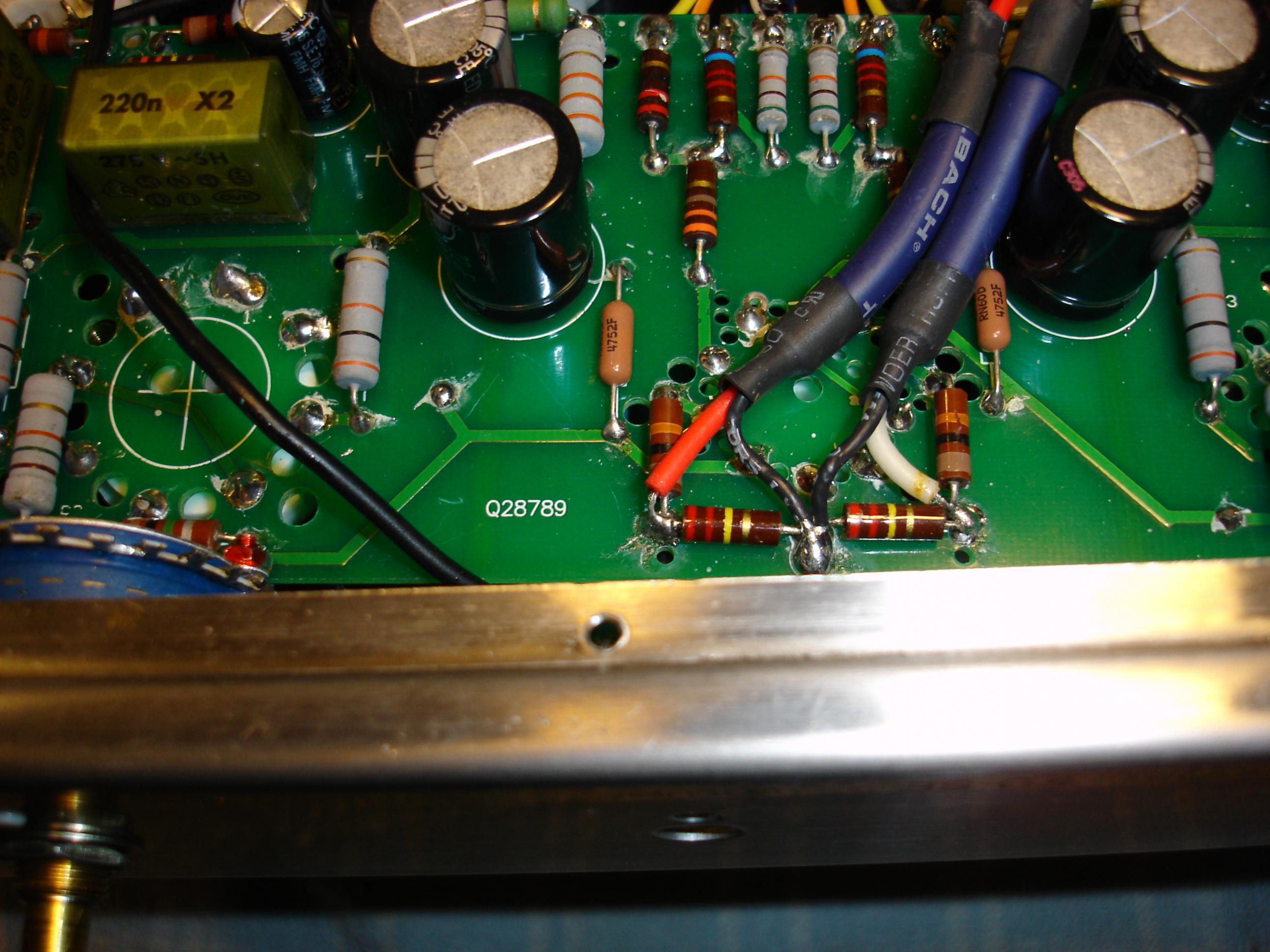

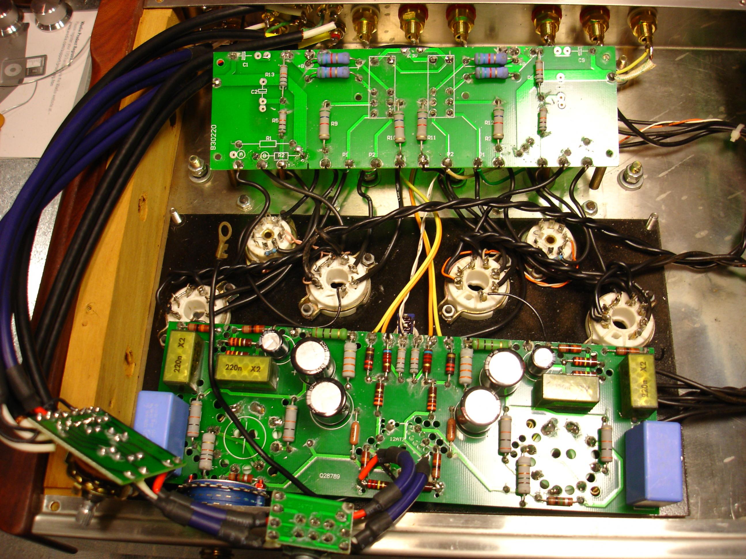

Here are some pics inside the amp, I have since replaced the volume control the a precision resistor 24 step, and the input selector for 4 inputs, my amp only had two sets of RCA's. I drilled the chassis for the two additional RCA's, what a job! Stainless steel is as hard as a rock, once I was able to penetrate the chassis, drilling was easy. I changed the cutting angle on the drill bit to a 4 degree sharper angle to cut the stainless. My Drill Doctor is so handy for things like this.
Notice the plate resistor burned from a set of EL34's that had an internal short. I replaced the resistors with 5 watt versions.

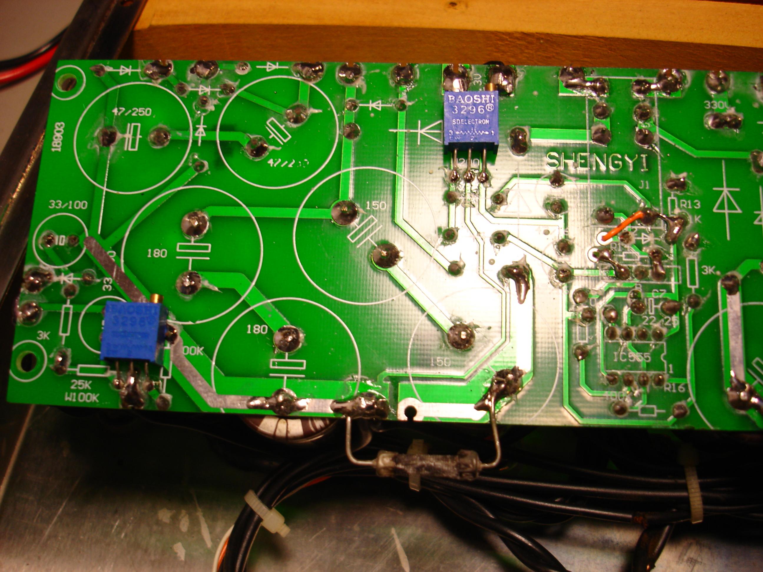

you can also check/change all power supply capacitors (specially for the voltage doubler)
also increase the capacitance of the time constant capacitor of the timer 555 (22uF25v to 100uF25v) which will give you +/- 1 minutes of start delay.
as you can see, there is nothing in the two small boxes between the power supply and the opt, that's why you have one (two) filter resitances after b +.
if it has burned, you must have a sick capacitor and / or an excessive bias.
I also advise you as long as it is necessary to check the diagram and to note it clearly to know what you have because I repeat it, they are all different.
for example, on one of my xdse 800 there was a 2.8k grid resitance per tube ... and 2.2k cathode resistance ...
