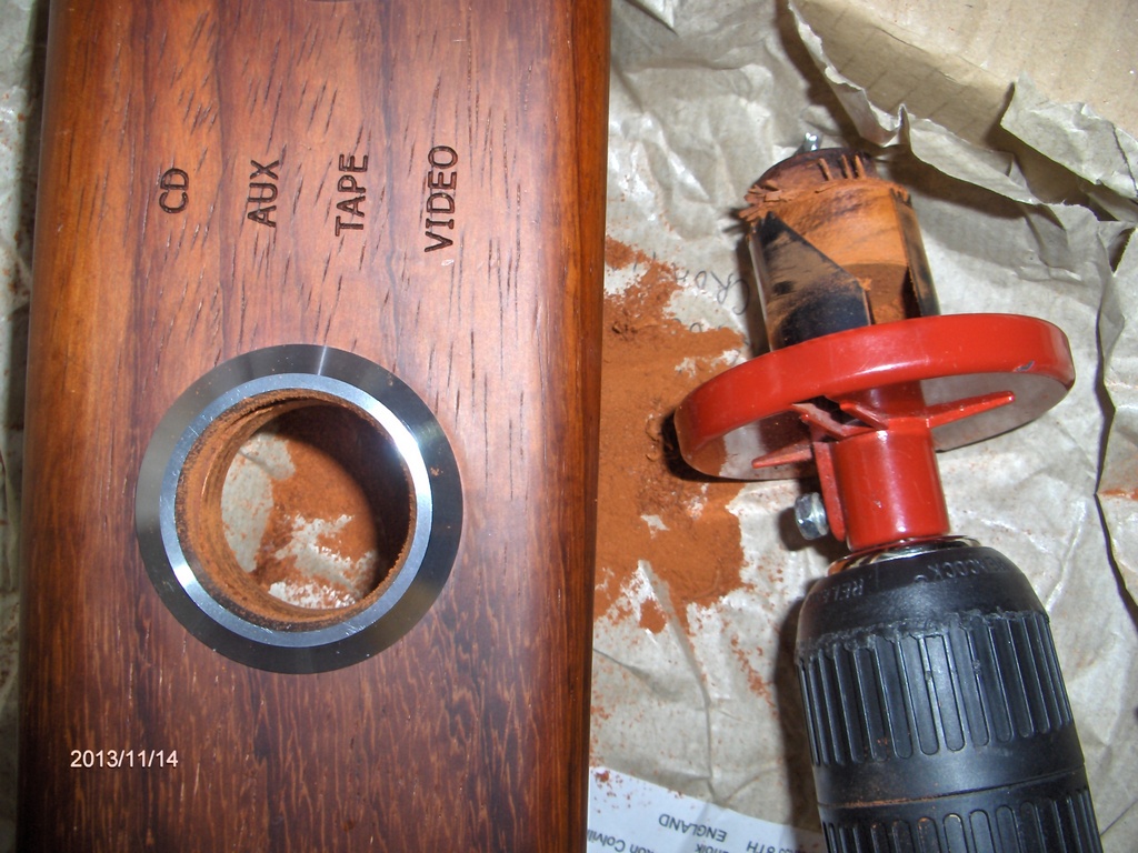

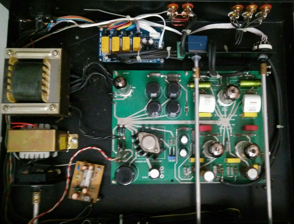

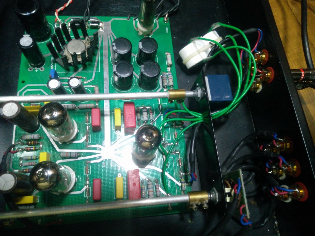

Have this pre-amplifier nearly three years already, and finally have modified it to improve few major flows, well at least those I've found as such.
First of all it was nothing so wrong generally speaking and it's nice sounding device, from the first day just as it was built. Even though that Chinese 'officially' sold as 2x12AX7 and 1x12AU7 combo and PCB board have those misleading marks on it (with Music Prince title too lol), mine is actually wired for Soviet tubes: 2x6N2 and 1x6N1, and there is nothing wrong with that, it's even better cause these tubes cost a lot less and sound if not better but equally good as many 12's. I found more 'issues' in polyester caps they've used.
The other issues I couldn't stand from the first day was the fourth empty step (titled 'Video' but was MUTE in fact), and finally volume knob fixed on that long aluminium rod and so not firm.

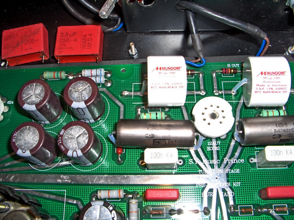

Instead of 2+2 polyesters WIMA (interstage) coupling capacitors I've placed two Russian made K40Y-9 200V 0.47uF PIO and two Mundorf MCap EVO 3,3uF 450V

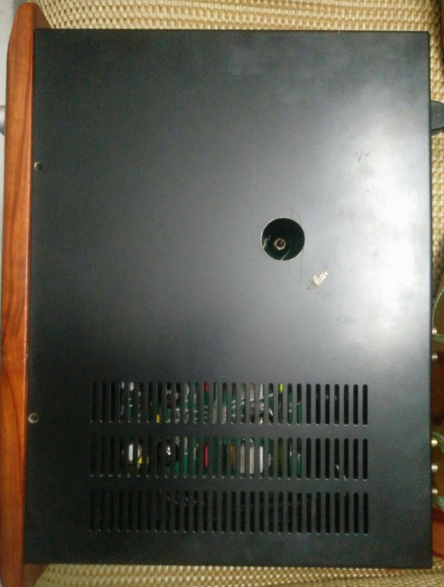

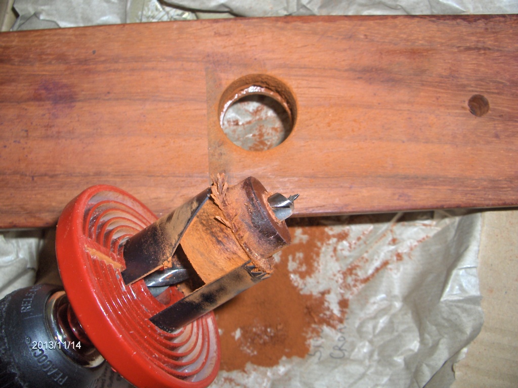

To make one more input I had to drill new holes for RCA at the back, and solder a couple of good quality wires into the empty holes in selector's PCB board (why they have left this empty while the selector has four steps is beyond my comprehension).

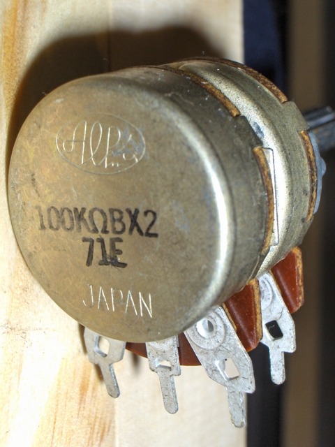

I replaced the small volume pot with the larger original NOS Alps made in Japan and fixed it on the front, and here I used quality 26 AWG Shielded Silver Teflon mil. spec. wire made by Thermax to connect all points.
I had to drill a wider hole on the metal case and one also on the frontal wooden plate for that purpose.
Bought three new full aluminium knobs to replace plastic ones, one for power switch and another for selector have that old school 'Luxman' style I really like, and are obviously much easier to turn on/off.
I think that's all, here are some pictures of course.

Sound of course is better as expected. Bass is tighter and punchier, details are clearer and that is something I've noticed immediately with the few CD's I play on Pioneer DV-610AV (SACD) player via that new input ('Video') .
However caps are still young and it will take some time for them to settle. But so far everything was worth time, effort and (not so much) money invested in this device!

Just a note that placing the volume pot in the back of the unit near the inputs with a long shaft is actually a "tweak" often used to shorten the signal path and lessen potential interference pickup. But if you're happier with it in the front and you don't have noise issues, then cool.
Thanks for the input pal :up:
Yes, what helps on one side might be a problem on another, but not always.
I kept the pot on the back at first, when playing with caps, just to see/hear how the thing will work. Before ordering (a bit expensive) Mundorfs from Germany I tried to parallel (unpopular) MKS with Russian orange 'bombs' K40Y-9 of 0,22uf 630V. The sound was improved, however I was eager to remove WIMA's for good. On the pot side - as can be seen on the picture, huge caps were on the way to the bolts on the rod, so the volume knob was going up to 11 o'clock position at max. :mischiev: not good, and as pointed earlier I didn't like how the whole unit: volume-rod-knob was budging.
So I ended up harder way drilling holes in metal and wood and messing around with wires but I've found really good quality silver shielded wire from USA (still available on eBay btw.) to kill potential interference in it's roots 😀 and no hum, no noise, everything is just perfect.

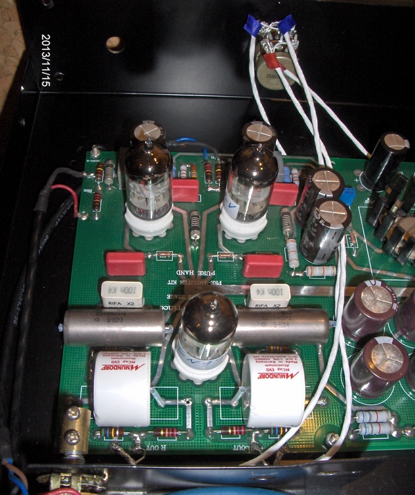

Capacitors upgrade
Hey guys! I finally upgraded the caps on my preamp. Long ago I had made a list of the caps to be changed and I made a typo error. Instead of writing 6.8uf value of teh coupling caps i wrote 2.2uf. As a result I ended up ordering 2.2uf 450v Mundorfs Aluminum in oil caps. They cost me just under $30 a pair. This guy from Lithuania on ebay seems to stock almost all variaties of Mundorf caps.
Researching a bit online I found that 2.2uf value will work too in my case keeping in mind the input impedance of my power amp (100k ohm in single ended mode, 30k ohm in balanced mode). I use a Proceed amp 2 by the way.
I also had another pair of 2.2uf Kemet caps (used) to replace those 2 red Wima box caps. I did the swap and i did'nt like the sound much. I was hearing a bit more highs but the bass was weak.
(By the way it is possible to accomodate Mundorfs without moving the pot as suggested in an earlier post above.)
I removed all 4 new caps and put the old ones back. I couldn't believe that a capacitor 'upgrade' will actually worsen the sound .
Plugged in my soldering iron the next day. This time i removed only the coupling caps and put the Mundorfs back again. I cant solder very well so I managed to rip off a tiny part of teh track. One channel stopped working so I had to solder a bit of wire over the track.
Finally I decided to solder pairs of copper wire (normal household wire) and connect the caps to them. This way i will be able to change the caps back and forth for experimenting. Please look at the attached photo and you'll see what i mean.
The sound is better now. its not a night and day difference but i like what i hear and I think I wont be making any further changes in near future.

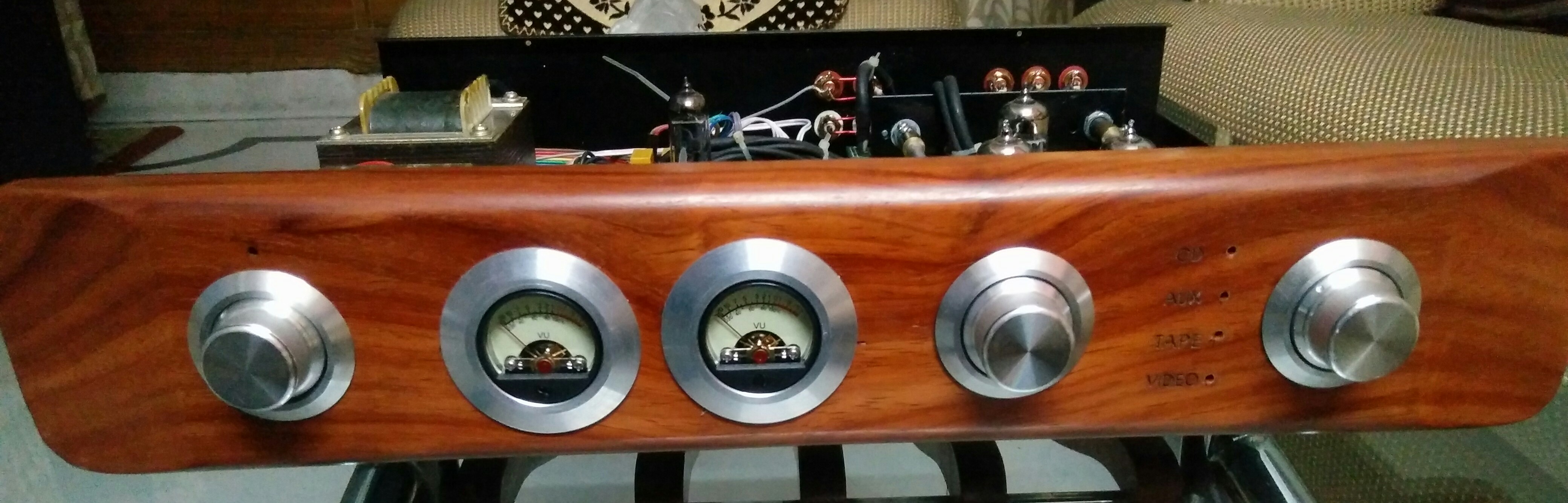

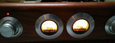

Music angel preamp modifications
Hey guys. I am in process of doing further mods to my preamp. The input selector on my pre became noisy and unreliable so I am putting together a relay based input board. Also installed VU meters on the front panel. Will post photos as soon as it's ready. I had to get a couple of aluminum rings made like the ones around knobs. A friend in machine tool business made those on his hi-tech CNC machining centre. Attaching a photo of him programming the machine.
Pretty excited myself to see the end result. I hope to be able to finish the job in a few days.
Here are some images of the modded music angel preamplifier. I installed a 12v transformer for the new boards however it was not necessary. I later found out that the main transformer has a 15 v output which can be tapped into without affecting the sound in any way.
I had to change all the signal wiring too.
The sound has perhaps become clearer after the mods. May be the relays are providing better contact and channel separation.

Nice. where did you get your VU meters?
Hello again!
I further rewired this pre using silver coated shielded copper cable. Removed the relay based input selector as I decided to have shortest signal path. Now I have only one RCA pair for input and I don't need more.
As a result the sound has dramatically improved. Much more clarity and detail. The tungsol new issue 12ax7 tubes along with genalex gold lion 12au7 are doing wonders. Just now ordered psvane 12au7 as I have read some great reviews about it.
