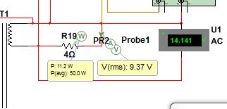

Multisim probe/wattage confusion
If wattage is vrms squared over R, Why is the multisim wattage probe (on the 4 ohm resistor) showing 50w but RMS voltage is 1/2 that is required to produce 50w?
attachment.php

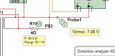

The AC volt meter is showing the correct voltage. The probe is now showing something different then before. I guess I won't trust the probes anymore.
EDIT - The probe is ground referenced and since the ground is through the feedback lines and the CCS. That makes sense. My feedback is differential so that explains it.
