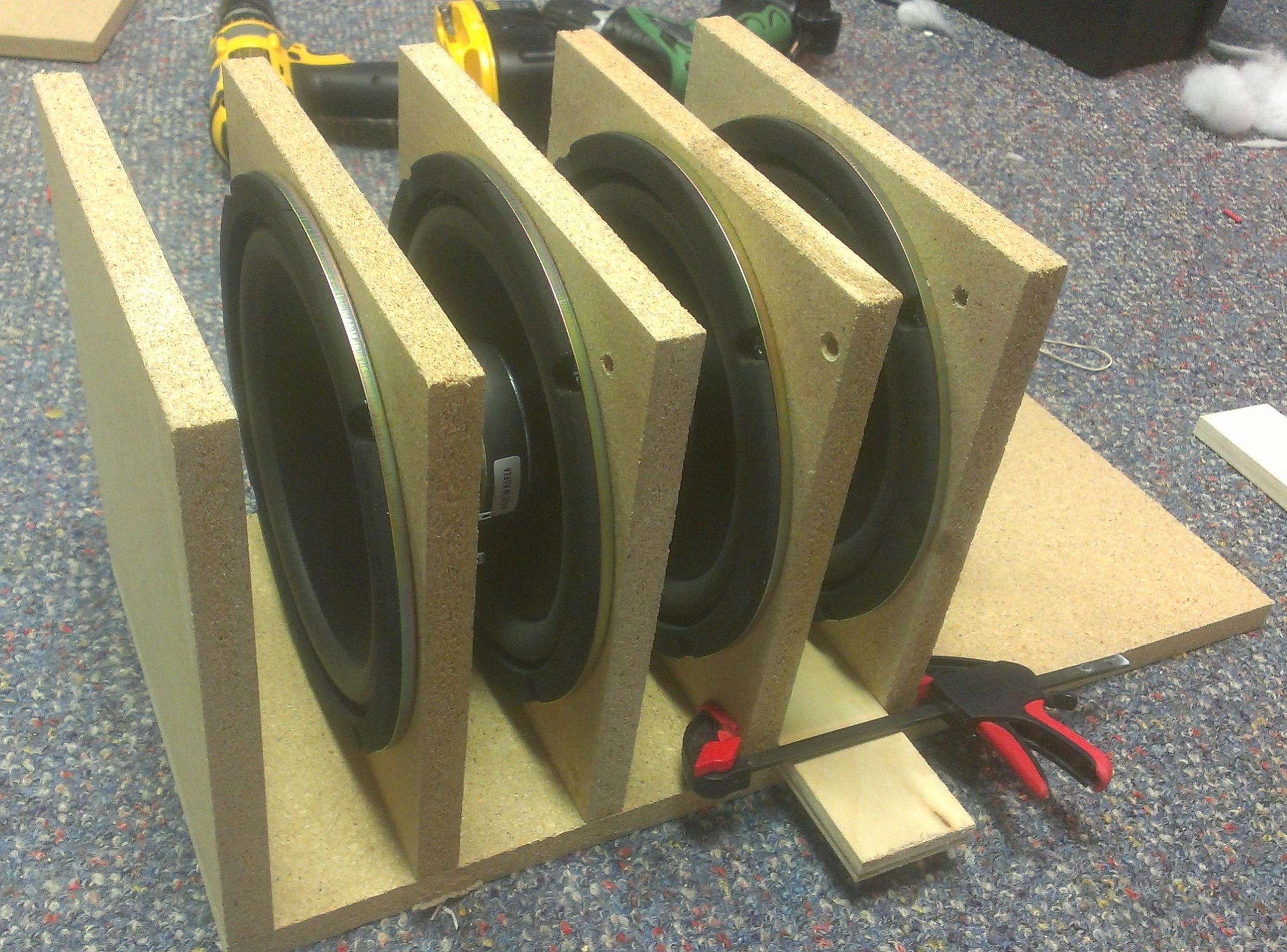

Hi all , just wondering if anyone has knowledge on this. A stacked set of dipole woofers facing the listener without the front or back blank so that the woofer cones are visible. Closest pic i can find is linked ( I hope.)
Kind of like legacy audio but with 4 or 6 woofers per side.
I have seen them in vertical towers like the sureal sound 5th row speaker, page 85 of the ultime open baffle gallery, but never horizontal.

You sure it's not an incomplete variation of the same thing you are describing in the vertical array examples? Vertical or horizontal doesn't really matter if it's a subwoofer.

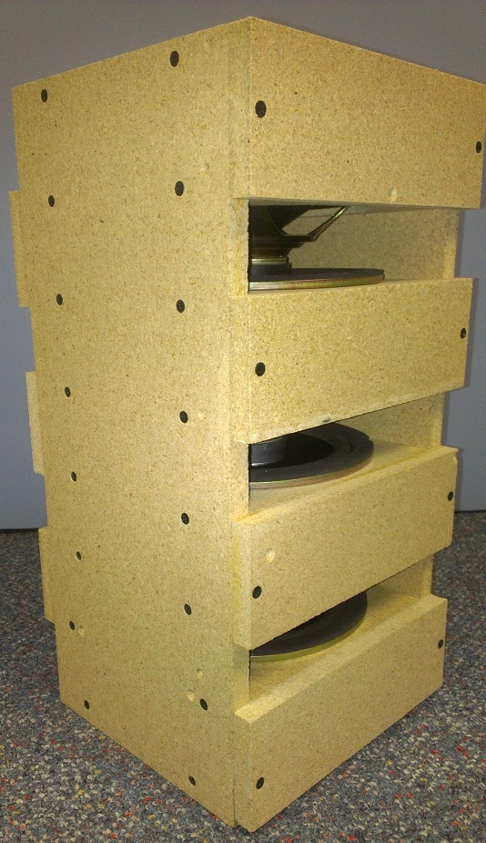

You normally see alternating plates at the front and back between woofers, and a solid top plate matching the bottom plate of your image.
A couple examples of typical stacked arrays:

The image was from a PE build thread and as you suspected incomplete. The end product was vertical. The image was the only thing i could find similar to i was thinking of building.
I have a massive gap in my knowledge compared to others on this site and was wondering if there was any advantage to this idea of stacking drivers behind each other for lower mid bass reproduction in IB or dipole configuration.

I would like the 10s or 12s stacked horizontal at ground level, like the first photo of the thread.
But no baffle just some kind of rings or something to hold them.
So i plan to put one behind the next until I get my desired result.
Will this work?

You won't get any bass out of that configuration no matter how many woofers you have. 🙂
You have to create a decent acoustical distance between driver front and back radiation so you don't get complete cancellation.

Ok so now im really confused what enables bass in a vertical stack like the picture you put up davey?
Is the alternating side slots?
If so could i simply do the same in the horizontal stack?

Horizontal or vertical makes no difference. The vertical stack in the photo I posted could just as easily be flipped onto its side.
I suggest to start with the basics for understanding this. The simplest form of a force-cancelling dipole woofer is the Linkwitz Phoenix scheme. (Note the 19" distance that separates front and back radiation.)
