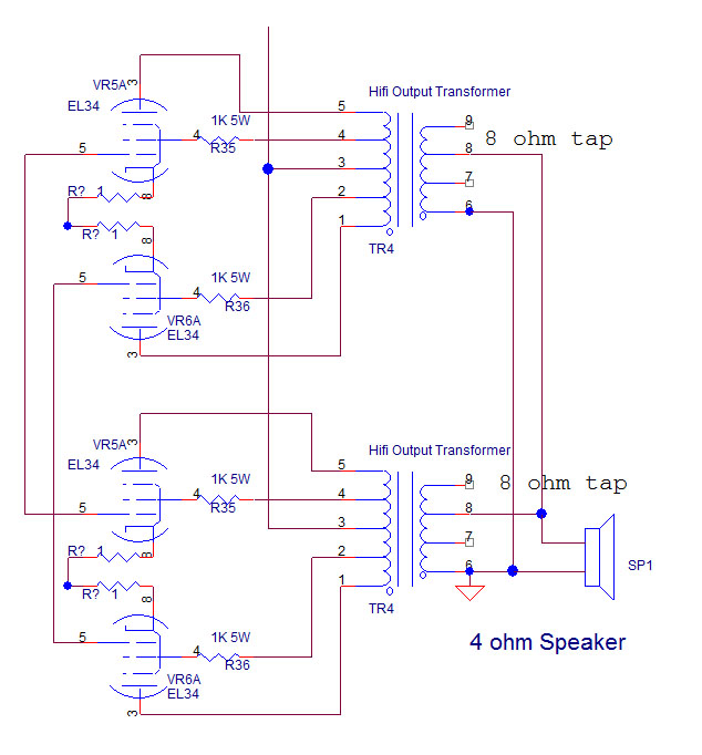

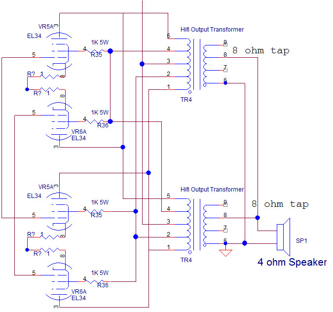

Do you mean the two options are
1) parallel output of the OT secondary, use the paralleled 8 ohm taps to drive 4 ohm speaker. Each of the primary of the OT is driven by a separate pair of power tubes as show in the first drawing.
2) parallel every single connection of the two OT, also parallel the two pair of tubes as shown. 4 ohm speaker connect to the parallel of the two 8 ohm tap of the two OT. as in the second drawing.
Looks like it should work. Is there any advantage of using two lower wattage smaller size OT like this?

I had breadboarded a 400 watt amp using 8 X 13GB5 tubes and 4 X identical 80 watt guitar amp OPT's. It would make almost 500 watts at clip on 650 volts with just a hint of red glow in the tubes. All 8 tubes were driven by Pete Milletts P-P driver board with 6HB6 tubes installed.
650 volts, are you serious? are those tubes still alive? 😀
The inductance of a coil, on a single core, depends on the square of the number of turns. Let's say we replace a single transformer with say 200 turns on the primary with two transformers, with 100 turns each on their primaries, in series. (This way we would have the right voltage and current.) The overall magnetising inductance will be halved. Plus the two (smaller) cores will each have higher magnetic reluctance than the single large core, again reducing the overall magnetising inductance.
In my case I did this because I have a good supply of identical cheap P-P OPT's that are good for 25 to 100 watts depending on application.
I would assume that a single correctly chosen and built OPT for a given application would be the optimum choice. However, off the shelf OPT's for a 400 watt per channel amp aren't too common. I do have a pair of Plitron 400 Watt toroidal OPT's that will be used for my eventual monster amp, but I am not in a big hurry to build that one yet.
OPT's get more complicated as the size goes up. To get good bass you need enough iron and wire to get enough inductance and magnetic capability. To get good high frequency response you need to minimize leakage inductance and interwinding capacitance. Both of these go up with size, so extra interleaving, and special winding techniques are needed. At some point a big OPT with HiFi frequency response will become cost prohibitive.
In the case of a Musical Instrument amplifier, multiple speakers are common. It makes sense to build multiple 50 to 100 watt amps, all driven by the same source, and connect each to a separate cabinet, or series-parallel connect them as needed.
In each of your diagrams you have the grids tied in parallel. I used a separate coupling cap and bias adjustment for each tube. You need to keep the bias currents equalized.
