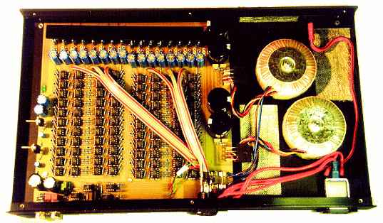

Jan Meier designed an amp with multiple opamps in parallel. The special thing about this amp is that the output opamps have their outputs connected via different resistors to the power supply lines to create a kind of semi class A, with multiple breakpoints.
http://headwize.com/projects/showfile.php?file=meier3_prj.htm
Steven

thanks, thats exactly what I was looking for. I need working schematics to lean on, dont want to reinvent stuff.
That classA operation of op amp is a great thing, I have done it on my riaa preamp with noticeable sonic improvement. Highly recommended.
