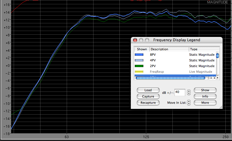

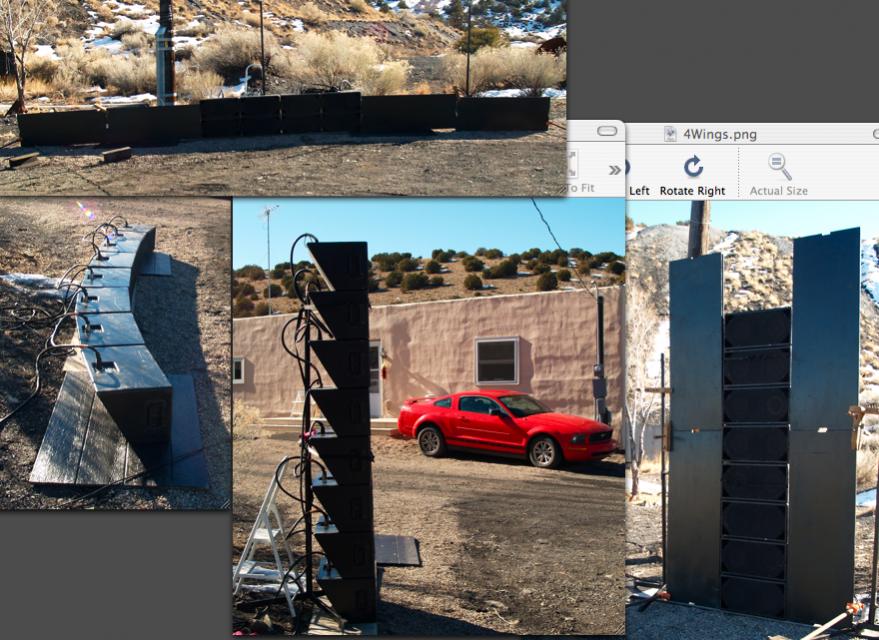

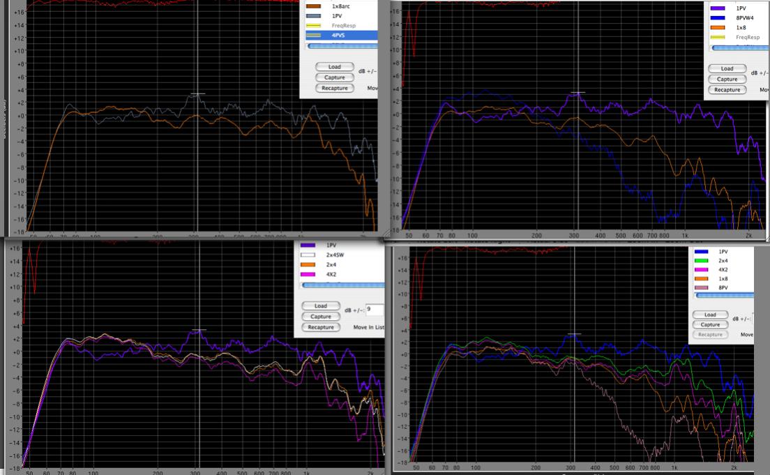

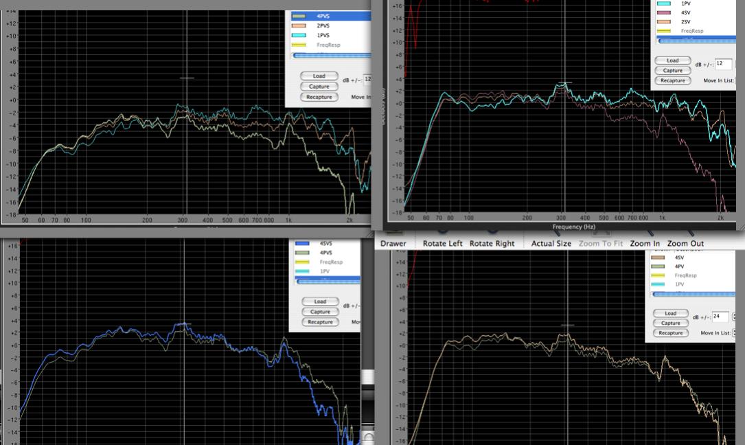

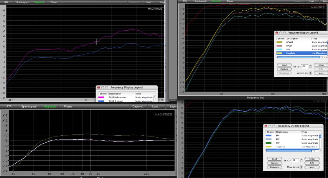

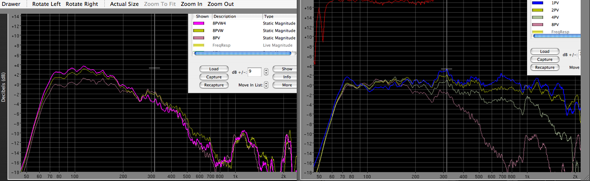

After noting differences between measured results of single cabinets of various types (TH, FLH, and BR) compared to multiple cabinet simulations using Hornresp, I conducted an extensive series of outdoor tests using one through eight bass reflex (BR) cabinets in various arrays.
Coherent summation of multiple cabinets should yield a 6 dB addition per doubling, +3 dB for doubling radiation area, and +3 dB for doubling power.
The closest to coherent summation was achieved with the speakers placed in an arc with all cabinets ten meters from the measurement mic, resulting in a net even response between one and 8 cabinets from F3 to around 250 Hz.
Incoherent summation results in only an average +3 dB addition per doubling of power and cabinets.
The graphs have been “normalized” with a 6 dB reduction for 2 cabinets, 12 dB reduction for 4, 18 dB reduction for 8 cabinets so that differences from coherent summation can be seen. Series cabinets have no normalization, as the net result of less power per cabinet and increased radiation net a 0 dB change.
The results of the tests show how different arrays result in quite different upper response from single units. Although David McBean is considering some changes to Hornresp, they still will not be able to reflect each type of array response, a complicated combination of many factors beyond the present model.
Similar upper frequency response reduction and general smoothing as is seen and heard in FLH and TH response occurs in the BR cabinets also.
The frontal area of the stack makes a significant difference in response shape, adding “wings”, flat pieces of plywood (AKA “barn doors”) to the stacks add 2 to 3 dB to the LF response when the frontal area is tripled.
Art Welter
Art Welter
I like the "barn doors"
So when I build my tapped horn--would adding barn doors to it give me about 2 to 3 extra dB also? If the horn is tuned for 18Hz, would it be advisable to use heavy bracing--say pieces of 2x2 lumber to frame the doors?
I'm always interested in "free dBs" and the barn doors would help when dragging the speakers outside for BBQs and such.

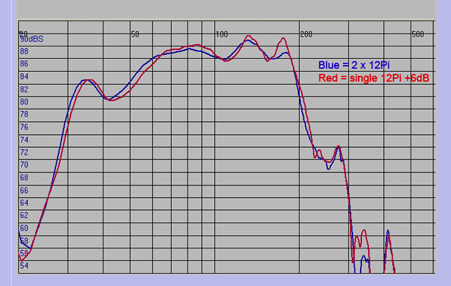

Hi Art,
Many thanks for taking the time and effort to conduct these very comprehensive tests.
Your measurements now make it quite clear to me that unfortunately, I am probably wasting my time trying to develop a new multiple speakers model that will ultimately be any better overall, than the current one. There are just too many variables to take into account.
In the circumstances, perhaps a more sensible approach may be to simply keep the current model, but to document known limitations in the Hornresp Help file so that users are aware of the shortcomings.

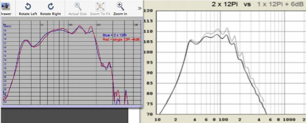

A couple of comments on speaker testing in general, in relation to Hornresp:
Hornresp assumes that the outputs from multiple speakers are in effect combined into one "concentrated" sound source. This means that to most accurately reflect the simulation assumption, four speakers should ideally be configured in a 2 x 2 square array - rather than a 1 x 4 linear array, for example. Eight speakers should be configured in a 3 x 3 array, but with only two speakers in the top row, centrally positioned. Not sure how much of a difference, if any, this would actually make to measured results though 🙂.
Tests should ideally be done under anechoic conditions, meaning that to replicate 2 x Pi half space conditions outdoors, it would be necessary to place the speakers on solid ground, pointing vertically towards the sky with the microphone suspended an appropriate distance above the geometric centre of the array, suitably shielded from the wind. Not a very practical proposition in your case 🙂.
Thanks again for all your assistance - it is greatly appreciated!
Kind regards,
David

Getting an extra 2 to 3 dB down to 18Hz would probably require much larger "barn doors" than what I have used, the extenders used on my TH and FLH provide an increase in level down to about 35 Hz.So when I build my tapped horn--would adding barn doors to it give me about 2 to 3 extra dB also? If the horn is tuned for 18Hz, would it be advisable to use heavy bracing--say pieces of 2x2 lumber to frame the doors?
If the panels are vibrating much, some acoustical energy is being wasted.
That said, flopping panels will loose more energy in the upper bass range than lower.
My panels have a 1.5" x 2" brace on the mouth side, that seems adequate to keep them from flexing.

Documenting known limitations in the Hornresp Help file so that users are aware of the shortcomings would be a good solution.Hi Art,
Kind regards,

It is worth noting that the ground plane reflection made the 2x4 and 4x2 stacks both fairly equal, and 1-2 dB louder in the LF than the vertical or horizontal line of eight cabinets.
The addition of the wings adds a bit more level down low than I would have expected on BR cabinets, almost as much as the 3 dB they did when added as a 90 degree "waveguide" to TH or FLH horns.

I agree, including information that would explain why measured results won’t match the Hornresp multiple cabinet response simulation would not be "minimalist"😉.
Art
A full transfer from half space to 1/4 space would theoretically add 6 dB, it is interesting that a relatively small area can add 3 dB of gain down to the Fb or Fc of a speaker system, and a dB or so below Fb and Fc.I'd imagine you'd have to have an effective baffle width/height of ~60ft to eliminate 4PI transition at 18hz.... uh.... I think?
It is possible that the baffle size I used, less area than a 4'x 8' sheet of plywood, may actually add +3 dB of forward gain down to an 18Hz Fb.
The lower left graph below is a pair of FLH with and without the same “barn doors” as used in a TH test (upper left) and the BR test (upper right), though the barn doors are at a 90 degree angle for the horns and a 180 degree angle for the BR.

Hi Art,
True 🙂.
I guess part of the problem for me is that I can't really explain in definitive or absolute terms why the results should be so different. One obvious contributor of course, as previously stated, is that Hornresp calculates power response whereas the measurements show pressure response. There will always be differences between the two at higher frequencies because of the complex and often unpredictable nature of the directivity effects associated with loudspeaker arrays. There also seems to be some question as to how much mutual coupling can be expected with different speaker types - the coupling of multiple direct radiators seems to be rather different to that of bass horns, for example. You have already noted the differences in the low frequency performance of multiple tapped horns, bass-reflex speakers and front-loaded horns.
A rigorous multiple speakers model would need to take things like directivity, mutual impedances, array configuration, diffraction, mouth geometry, etc, into account - even then, the predictions would not necessarily be entirely accurate. Hornresp simply attempts to simulate the power response of an array configured as a concentrated source.
Despite the known shortcomings, from a theoretical viewpoint there is certain consistency about the current Hornresp multiple speakers models that is reasonably reassuring - intuitively it makes sense, to me at least 🙂.
To illustrate - the following three systems will all generate the same SPL response in Hornresp:
1. A single horn speaker radiating into 2 Pi half space.
2. A single horn speaker with two drivers connected in parallel and cross-sectional areas doubled, radiating into 4 Pi free space.
3. Two horn speakers connected in parallel radiating into 4 Pi free space.

Actually, the measured “ mutual coupling” of multiple BR,TH, and FLH cabinets of similar frontal dimensions are remarkably similar, with the exception of a very slight decrease in the F3 point with multiple FLH.I guess part of the problem for me is that I can't really explain in definitive or absolute terms why the results should be so different. One obvious contributor of course, as previously stated, is that Hornresp calculates power response whereas the measurements show pressure response. There will always be differences between the two at higher frequencies because of the complex and often unpredictable nature of the directivity effects associated with loudspeaker arrays. There also seems to be some question as to how much mutual coupling can be expected with different speaker types - the coupling of multiple direct radiators seems to be rather different to that of bass horns, for example. You have already noted the differences in the low frequency performance of multiple tapped horns, bass-reflex speakers and front-loaded horns.
Additional gain over the predicted +6 dB for each doubling can be accounted by the directionality a large frontal boundary affords.
Frequency response smoothing in multiples of all types are evident, though slightly less evident in BR or sealed front loaded speakers.
“Hornresp calculates power response whereas the measurements show pressure response”.
That statement goes a long ways in explaining measured differences in upper response, don’t recall you pointing that out before.
It may be quite obvious to you, but was not obvious to me, (Hornresp charts are labled SPL Response in dB ) I had not understood that a program called Hornresp would not consider one of the most useful features a horn provides, directivity.
A constant directivity horn such as provided with a simple conical expansion does not change in power response above the frequency where it exhibits constant directivity, regardless of boundaries, as the horn walls already define the boundary.
The “intuitively reasonably reassuring” system models, which ignore (don’t account for) directivity allow Hornresp to show highly inflated upper frequency levels when changing from whole space to 1/8th space compared to measured results.
Thanks for pointing out the many reasons behind measured differences and Hornresp simulations.
Art
