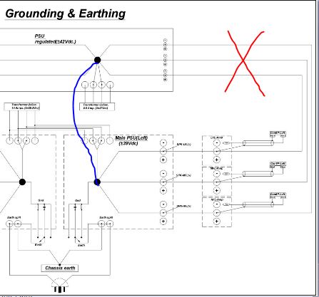

I just finished a 6 channels power amplifier few days ago.
I have a Internal ground loop problem I guess.
I made a test using a generator on each individual channels and they all exhibit excellent noise figure.
But if I connect all six inputs together to the same generator there is a very bad totally unacceptable hum/buzz!
Even with all inputs not connected or even all inputs shorted on six channels, the noise remains.
I tried with 16 ohms resistors between all individual input cable shields and input grounds...no improvement.
And even with 110 ohms resistors no improvement at all.
Any hint to help me someone...?

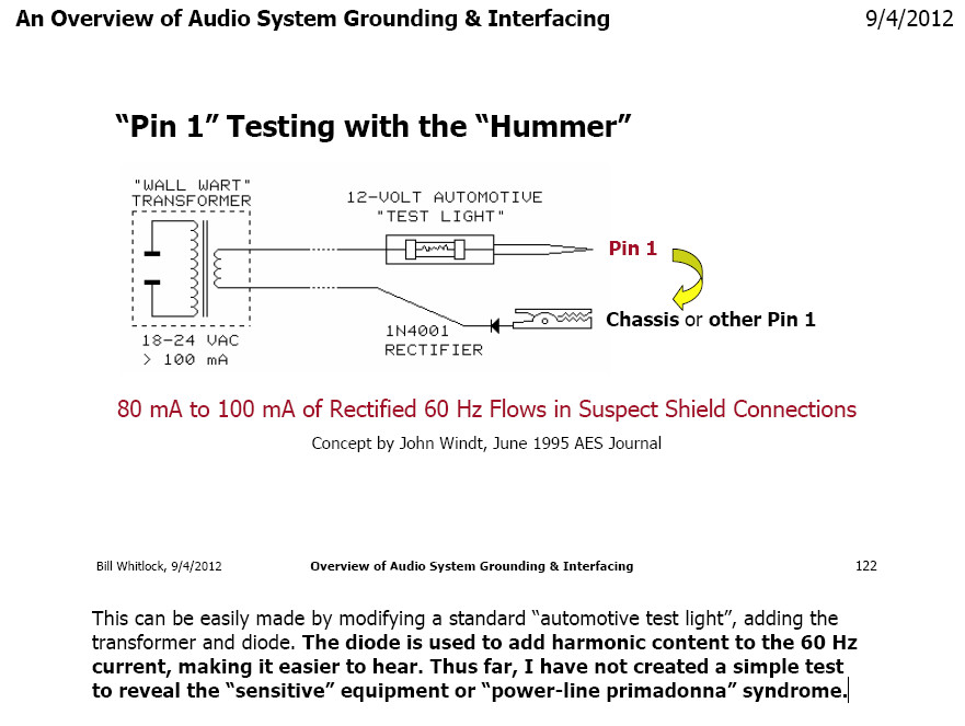

Probably a poorly implemented input stage.
Start at page 101, the troubleshooting section of this Bill Whitlock paper:
"An Overview of Audio System Grounding and Interfacing"
by
Bill Whitlock, President
Jensen Transformers, Inc.
Life Fellow, Audio Engineering Society
Life Senior Member, Institute of Electrical & Electronic Engineers
http://centralindianaaes.files.wordpress.com/2012/09/indy-aes-2012-seminar-w-notes-v1-0.pdf
Also build a John Windt "Hummer" (instructions for use in the above paper)

Luke,
looking at post6 and just the left side:
You have a ground loop that runs through the hi pass channel and the low pass channel.
If any part of that loop shares a part of the route with any signal then interference will be added to the signal. That cannot be avoided.
You also have two more loops low pass to mid and hi pass to mid. This is three ground loops in the left side.
You also have 3 ground loop in the right side.
If any one of those six loops has a shared length in the route with a signal route you will get interference.
Now looking still at the left side.
You have three screened inputs.
The screen is the return for the signal coming into each amplifier.
The screen MUST be connected to the signal circuit at both ends to allow the signal circuit to work.
You have also connected all three screens to the Audio Ground at the input of the amplifier.
That is three more ground loops as soon as you connect any screens to a Source that commons the returns.
The same on the right side.
Does your amplifier produce extra noise when only one signal is connected?
Does the noise get worse when a second signal is connected?
You have to attenuate the interference in the loops. You MUST NOT break a two wire signal circuit.
A mono amplifier that separates the input Signal Ground from the PCB Power Ground+ Speaker Return, allows you to connect the signal circuit without creating a loop.
But it changes when you have more channels.
You then need to reference the input to the output.
You do this with a single wire that has a higher resistance to reduce the interference current in the loop that is created when the second channel is added.

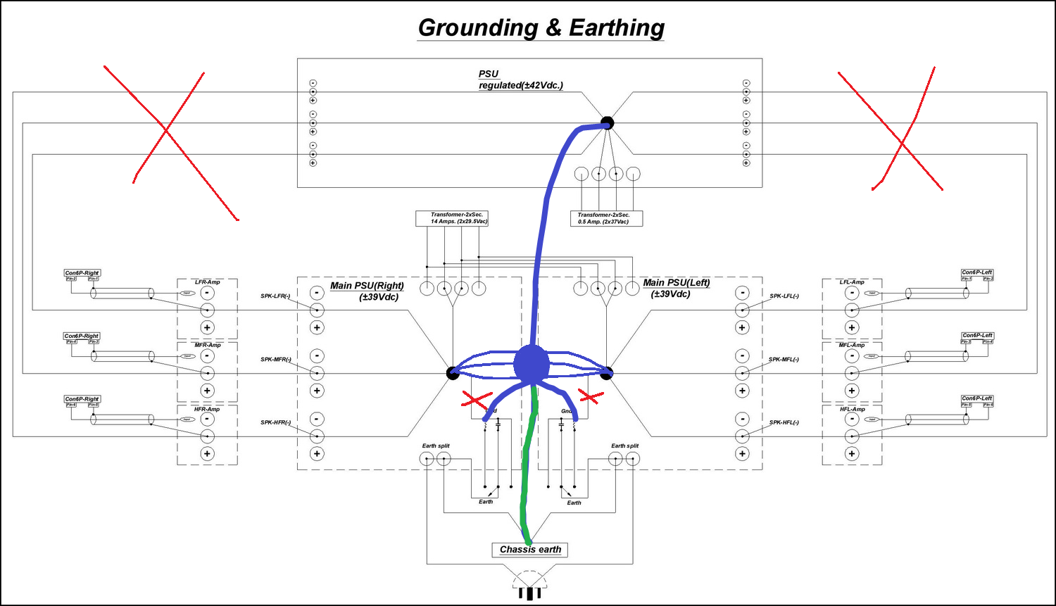

If you amplifier is quiet, with out anything plugged in, it's likely the loop problem is due to the ground currents flowing from the attached input sources.
If, and only if, your sources have a solid ground connection, one trick is to place a 15~22 ohm resistor in series with the screen connection inside your power amp as close to the PCB star as possible. What this does is force the ground loop currents to flow through the earth connections back to main earth and not through the screen.
I have incredibly quiet amp/ preamp set up, and I use this methodology.
Again, let me stress, all of the equipment must be solidly earthed.
I will try to post a drawing later today.
Gmphadte & Sesebe
I just tried it...exactly like your drawing.
Guess what? Smoke got of Main PSU's.
The two resistors from the Gnd/Earth coupling circuit near switch just blew.😀
I'll have to change them and be ready for another try!
Thanks anyway!
Luke

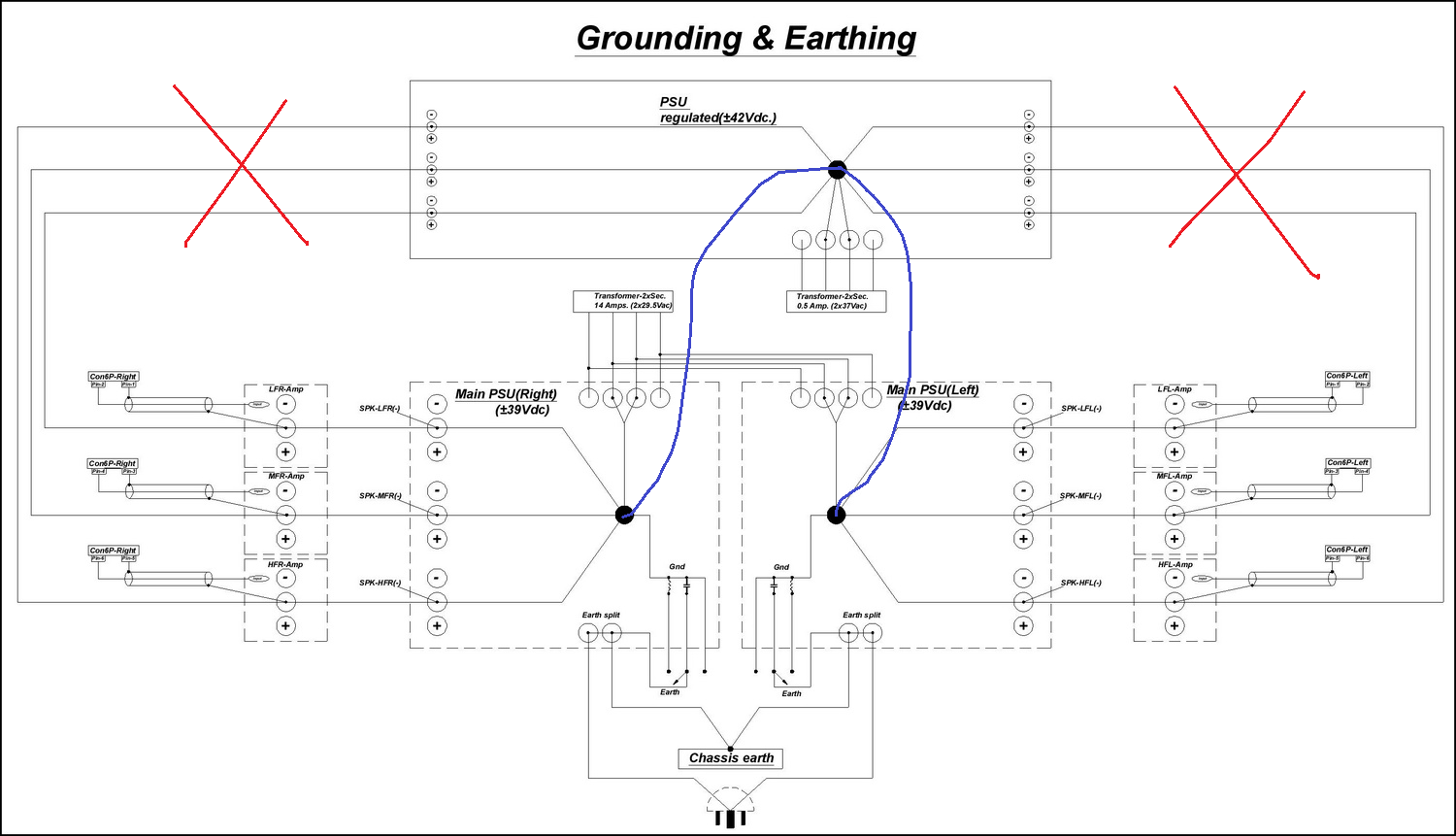

This only means that or you drawing it is not correct/complete or you made a different connections not like in my drawing.
Anyway what is your power source diagram? And what are the connection of the power transformer?
Sesebe
My Gnd/Earth plan is correct and your suggestion has been perfectly implemented but I admit that the switch was not at the position you suggested, that means complete coupling from Earth to Gnd.
Instead it was at the "resistor parrallel to cap position" as shown on my drawing.
Luke

Read section 5.8 again. While Fig.7 Unbalanced Devices is rather primitive compared to the other drawings, but still you can puzzle a lot out from the balanced circuit figures.
One thing I would do differently is connect the Safety Ground/Protective Earth to the chassis near the power cord connector, using it's own mounting post.
While the Main Audio Ground should connect to the chassis near the I/O jacks.
