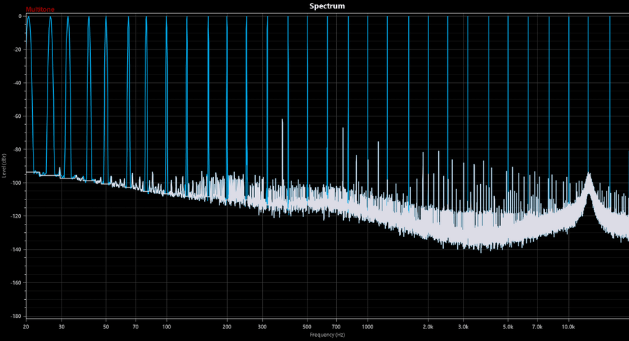

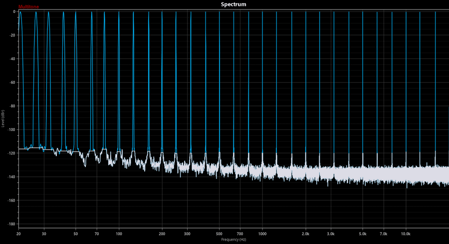

By the by, I made that plot to show the value of a proper USB Isolator. Here's the before picture:
Subtle differences...

I built my own isolator using an ADUM4166. That's what is being used in the plot shown in my last post. (It also works very well on improving the sound quality from this desktop computer system as well as on the main listening system in the living room. Despite what the bits are bits, ahh, enthusiasts insist. I also thought they believed in measurements, but, alas...) There's at least four commercial offerings using the part. Of course, mine is better. 😀

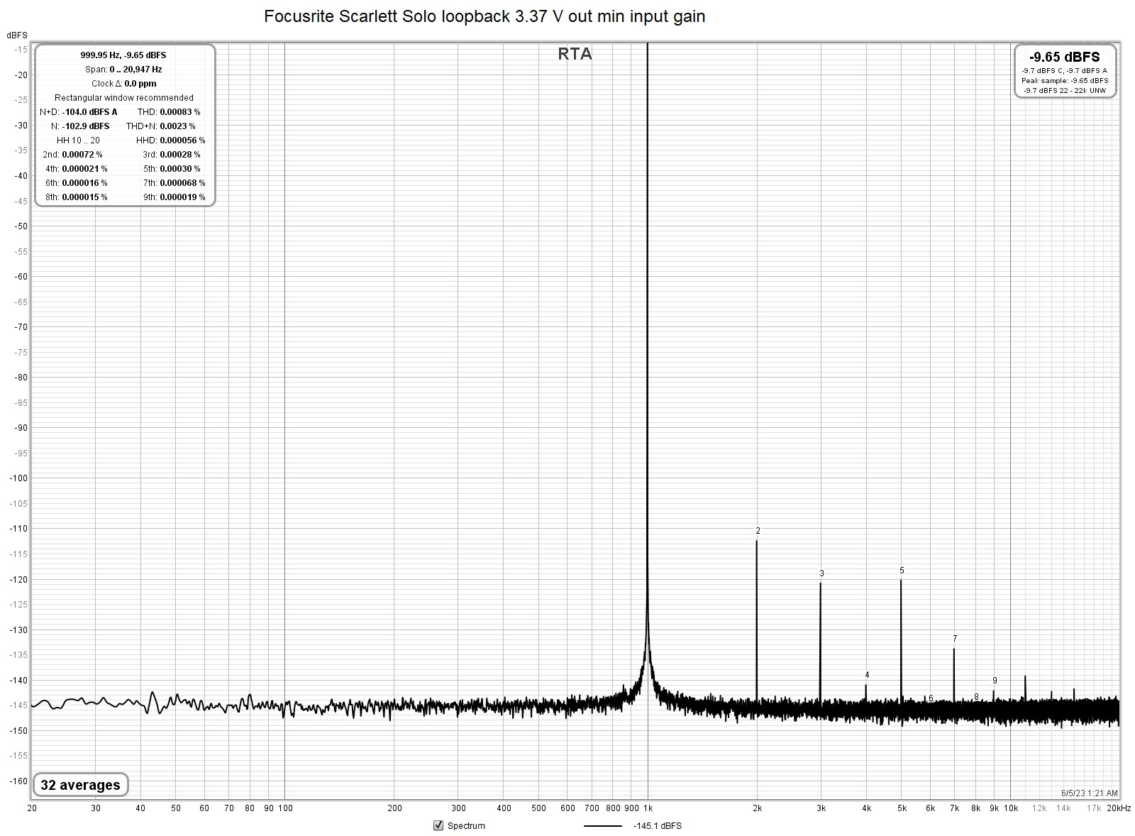

At the moment I'm still learning my way around REW and the Focusrite USB DAC+ADC combo. The noise floor seems to depend a lot on which USB socket I use to connect it to my computer.
This is about the best I am able to get out of that thing at the moment with a loopback connection, 93 dB SNR at 1 kHz, if I interpret the REW numbers correctly. I can get the noise maybe 1 dB lower if I increase the output volume to the maximum of 4.845 V, but then the distortion goes up significantly.
Regarding price-competitiveness of home built gear: as soon as you start figuring your own time in, everything becomes super expensive. I once grew potatoes in a garden plot: most expensive potatoes ever! And that was in the good years where I was able to harvest any.

With the Scarlett devices, it depends a lot on how you set them up, what gains you have set, and so on. Here's some measurements for the very similar 2i2 by a guy who certainly knows how to measure things. The DAC side appears to be the limiting factor for a loopback measurement.

Yeah, USB connections to computers often are a mixed bag. Some are better than others. Cables matter, too. As does the test set-up. Unfortunately.
