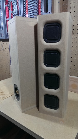

Hi All,
I'm nearing completion on my first DIY build. I decided to start simple and build a pair of desktop speakers, each containing 4 2" full-range drivers (HiVi BMR-12's).
I also picked up some 200uf non-polarized capacitors to filter out the low frequencies. Trouble is, I can't seem to figure out how to wire the capacitors in? Does each of the 8 drivers need a capacitor, or just each of the two cabinets? I have them wired series/parallel to maintain an 8ohm impedence.
I'm hoping I only need to use 1 capacitor per cabinet and wire it between the positive post on the terminal cup and the positive post on the bottom driver (that would otherwise attach directly to the terminal cup post).
If anyone could help out this noob, it would be greatly appreciated! Here's a pic of the progress so far

It should be good to go with one cap per enclosure as long as it's in series with the signal before the signal gets to the speaker. If you wire it directly off the terminal cup and then wire the speakers off the cap, you should be good.
Mike
It would be very easy to try them with the cap in line at the terminal cup to get a "feel" for sensitivity(efficiency) and response then jumper (bypass) the cap and listen again knowing the volume limitations from the previous test.
The resonance on a 2 inch driver is probably around 200HZ. If the impedance of the driver were to go up to 30 ohms due to resonance, where the cap was trying to do its thing, the 200uF cap would then be a 25HZ highpass. So it wouldn't hurt to put the caps in place, but The rolloff frequency will probably be pretty far off of theoretical with 8 ohm nominal. The cap needs to be a bi-polar type if it's an electrolytic.
