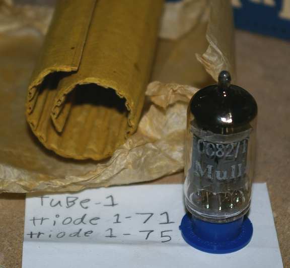

I was thinking of auctioning this on Ebay,
but it occurred to me that someone here might have
an Octet (8) of Svetlana 6L6GCs to trade for it. 🙂
Best price I've found for SV 6L6s seems to be about $25,
but you guys probably cut far better deals on them than I can find.
Anyway, I'm not collecting Mullards anymore;
I'm trying to build some guitar amps.
Maybe 10 EL34s JJ would be as good, I don't know.
This was given to me 'NIB', with original wrappings,
but its been out for testing several times anyway.
one triode tests 71 the other 75 on my CanArmy Tube Tester.
Because its NOS and long-plates date from the late 50s,
I can't offer any warrantees as to how many hours it may last,
or its suitability for any particular circuit.

Are you sure that is a genuine Mullard? The print does not look like any Mullard I have seen before. The box and the wrapping look genuine, though. What is the etch code? Does it have seams on the top of the glass?

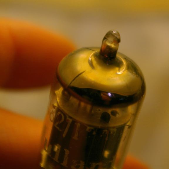

There are four seams on the top-glass (like the stars on a compass).
The 'Blackburne' code on this one is
261 B8C (one brown etch over the other). (or possibly k61...these are hard to see even in good light)
This code usually indicates the plate-type,
and/or the inner component style/issue.
The getters are dual-supported circles.
There is a circle and a seriffed 'C' (reversed) on the bottom,
which is 'bathroom etched' rough glass (the C is actually raised casted).
The 'Made in Great Britain' lot number (above) is 163.
(this is always a separate screening from the Mullard logo/name)

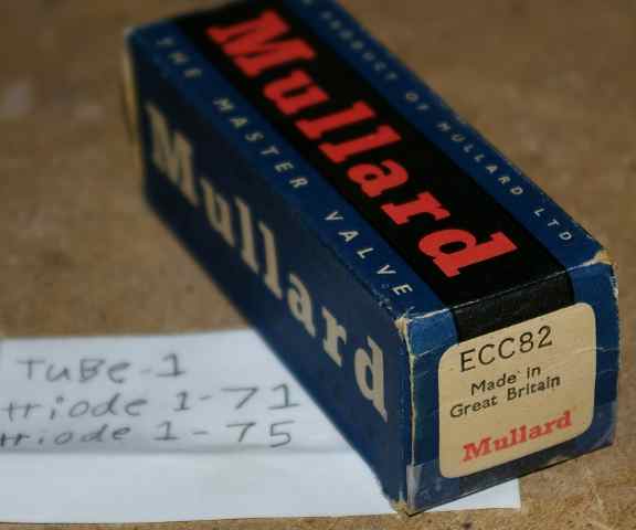

And yes,the boxes are also real,
and the boxes alone are worth $50 a set (including wrappings),
both to collectors and fraudulent dealers.
The inner long-plates can't be faked, or any other internals.
(If you can do that, you might as well make brand-new Mullards!).
Typical fakes are either Japanese or Chinese (sometimes Russian or Telefunken) which have been 'silkscreened'.

Convincing fakes can also be detected:
In this picture, you can see full circles especially on left here
(completed on the inside of plate) on the Mazda fakes.
Real Mullards (like the one I'm selling),
only have half-circles. The INNER half of the circular hole in the plate is missing, as it should be.
Also, fake Mullards (i.e., Mazda)
will have double-stitched lines on tube top:

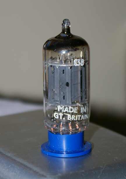

k61 would be an ECC82. 261 may not be a valid code.
I have never seen a genuine Mazda with a seam on top. Seams usually mean Philips equipment, but not necessarily in a Philips factory (e.g. Ei Serbia, BEL India, some Matsushita?).
The ladder anode shape was used by lots of makers. Your valve could be genuine, but it is unlikely to have received its external printing in a Mullard factory. Curious, as the external print is the easiest part for fakers to get right. Maybe, inverting the logic, the dodgy-looking print is a sign of genuineness because only a really incompetent faker would do this?
If I had to guess, I would say this one came from BEL as they were often a bit random with marking. For some reason a late valve has ended up in an early box.

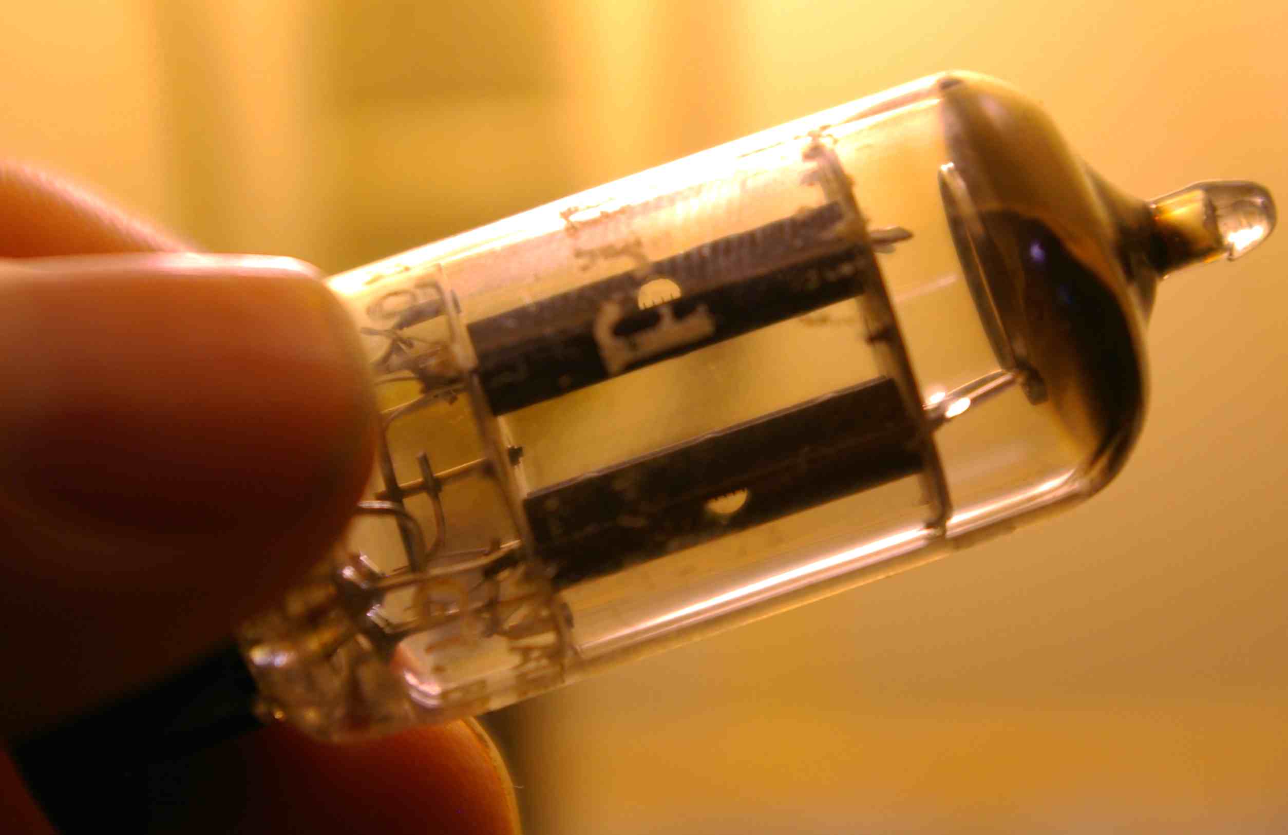

Here's a close up of my tube:
The top is clearly the authentic Mullard pattern,
not the overdone crimping of the fakes. (see above, again.)
Also, note the HALF-moon hole in the long-plate,
showing that the tube is both authentic and OLDER stock,
contrary to your assertion above.
Older tube is in older box, because they came together.

A valve made using Philips equipment could be identical internally to one made in a Philips factory, including anode hole shapes. The 'Mazda fake' you show on the left of your picture in post 5 is unlikely to be made by Mazda, as they did not have top seams. It could be that the Mullard markings on it were put there by Mullard - they sometimes bought in valves from elsewhere but still marked them as Made in Britain.
So my conclusion is that your 'genuine' valve may or may not be genuine, and your 'fake' may or may not be fake. I am astonished to hear that someone might be willing to pay $50 for a genuine Mullard box. I am richer than I thought!

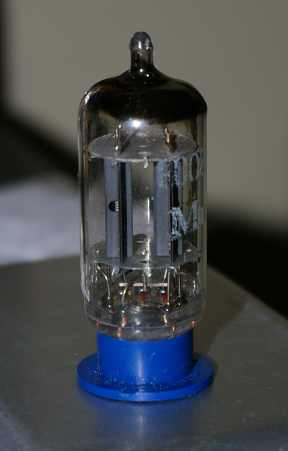

One would do well also to heed this posting:
The Double-Supported Getter is neither 'inside' nor 'outside' the getter circle.
In fact, a single bar rises, bends at a right angle, and bends again to go down to the plate. The Getter is welded ON TOP of the double-support style Getter.
This is the trademark of the EARLY Mullards (i.e., 1957-1960s), and no fake 'Mullard' of any kind has surfaced that mimicks this difficult and rarely noticed feature.
Finally, Another person has observed that Mullard and Philips indeed swapped part-inserts, as these are the 'expensive' and difficult to manufacture component, which requires skilled labour to assemble, and also the typical problem with all runs was guessing (or second-guessing) demand. Both Mullard and Philips were often inaccurate as to adequate run-sizes and internal part-sourcing (such as semi-precious metals).
Contrary to what one may think, part-swapping ensured consistency and quality for both companies, rather than ad-hoc hiring of temporary workers which would have required special training, and given mixed results.
'Crew-lending' is still a common modern practice.
The double-getter supports also authenticate my tubes as Mullard (made in the Blackburn plant), and early.
