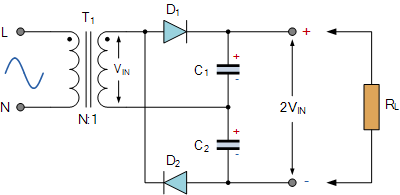

My idea was to build a stereo version of the 3-3 using a shared PT, EZ81 or GZ34 and a CLC-supply for B+.

Think about saving some $, while keeping performance up, in the B+ PSU. "Full wave" voltage double the O/P of a Triad N-68X isolation transformer. "Snubbed" UF4007 diodes will do quite nicely, here.
