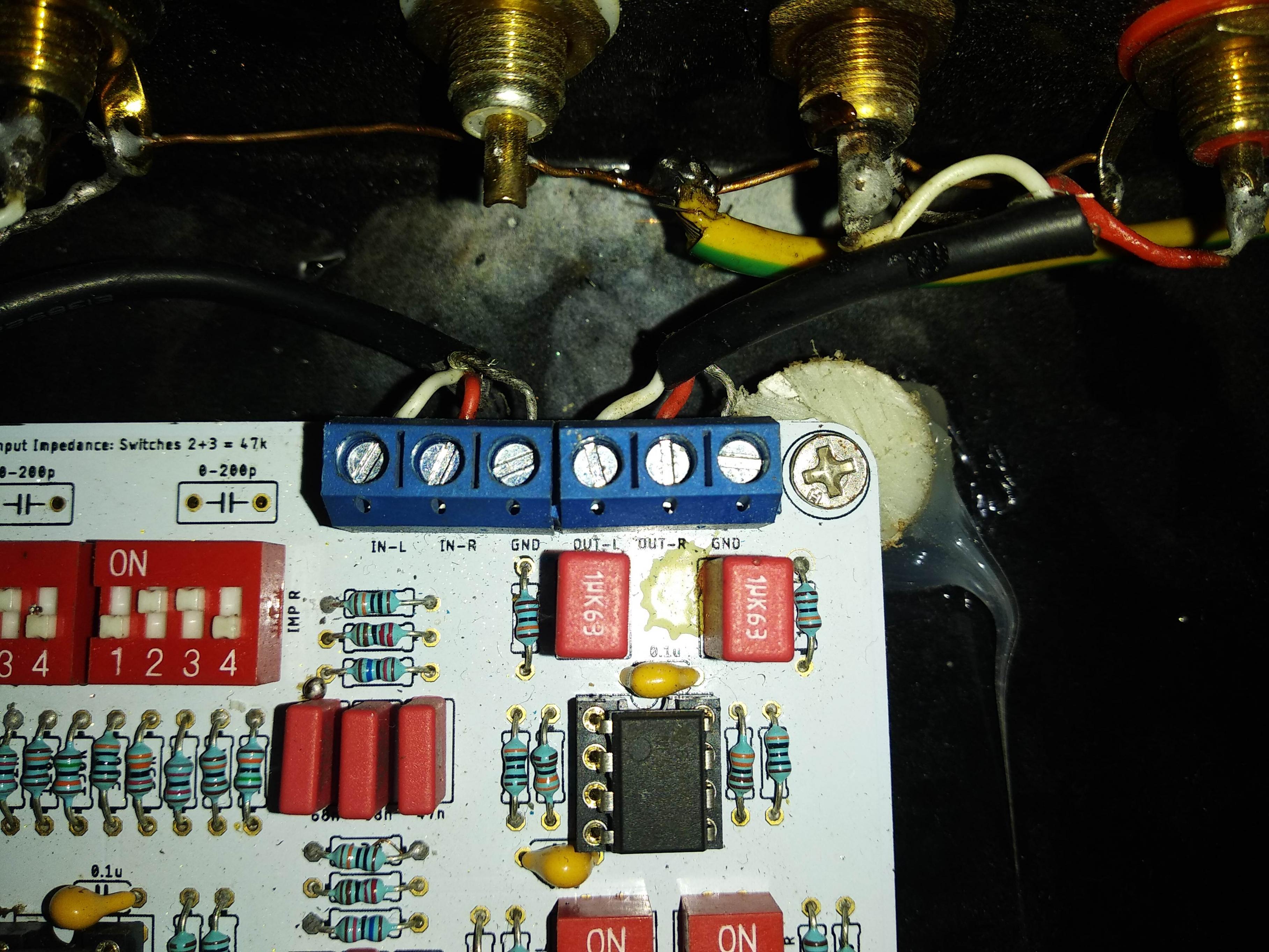

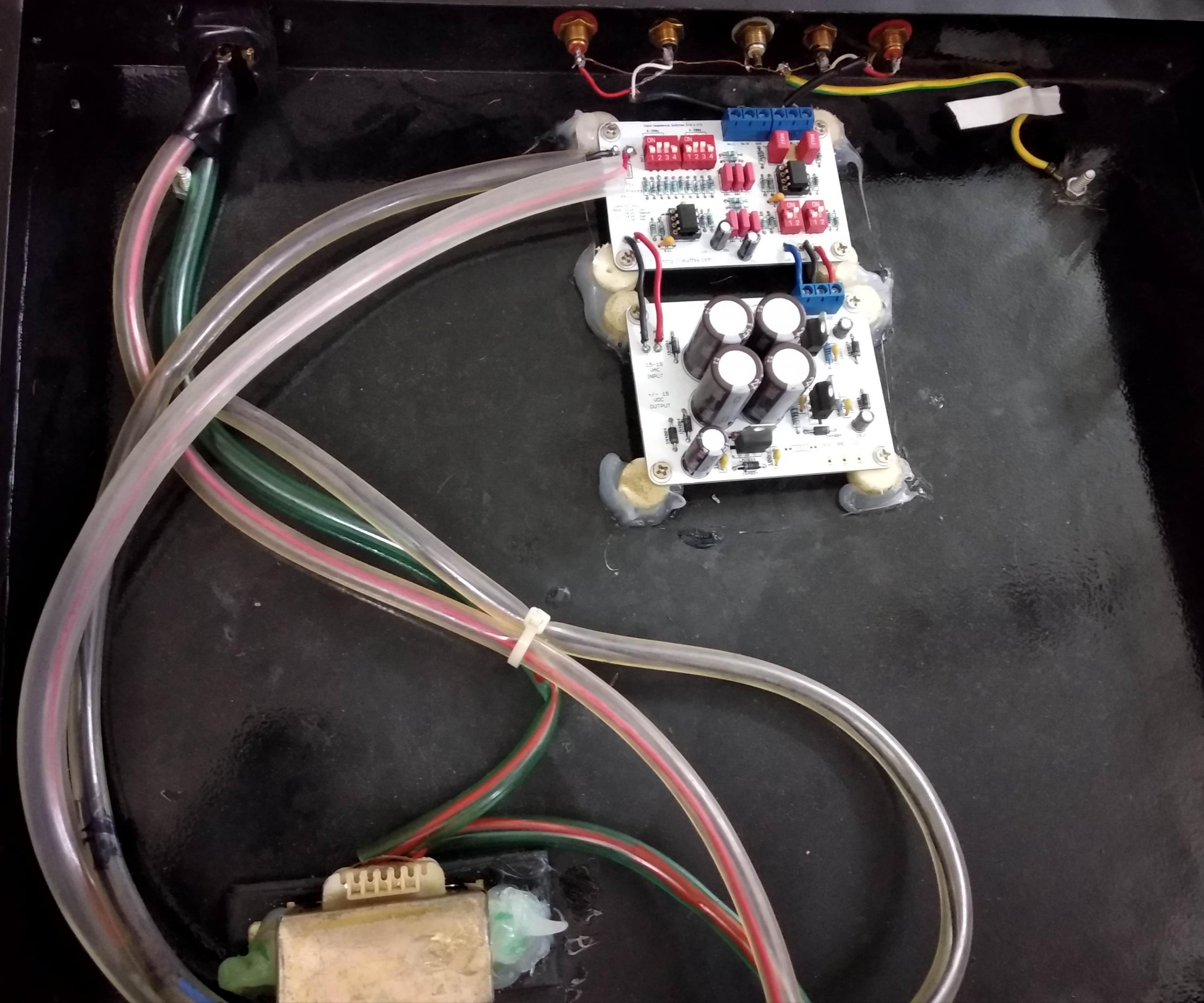

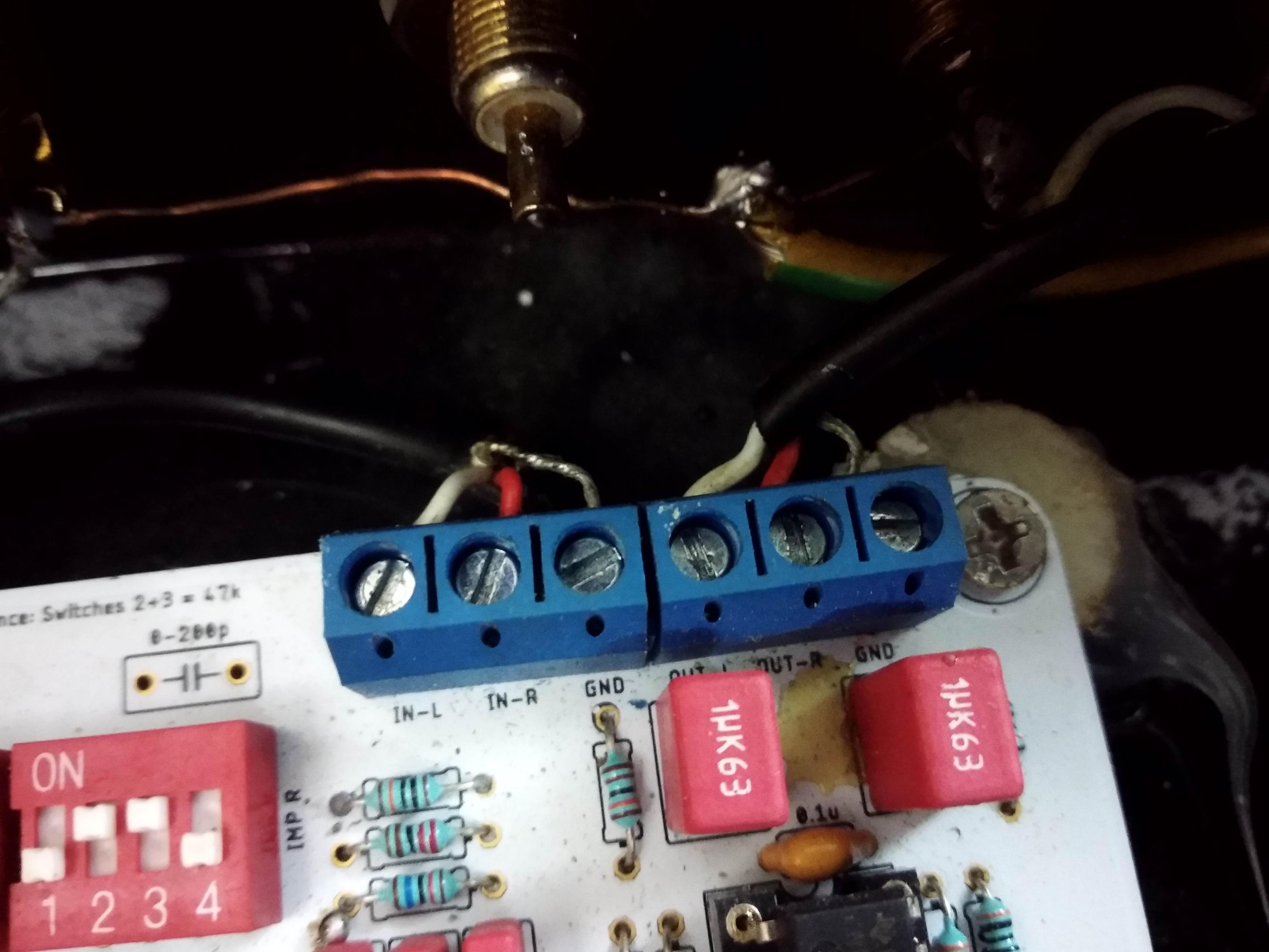

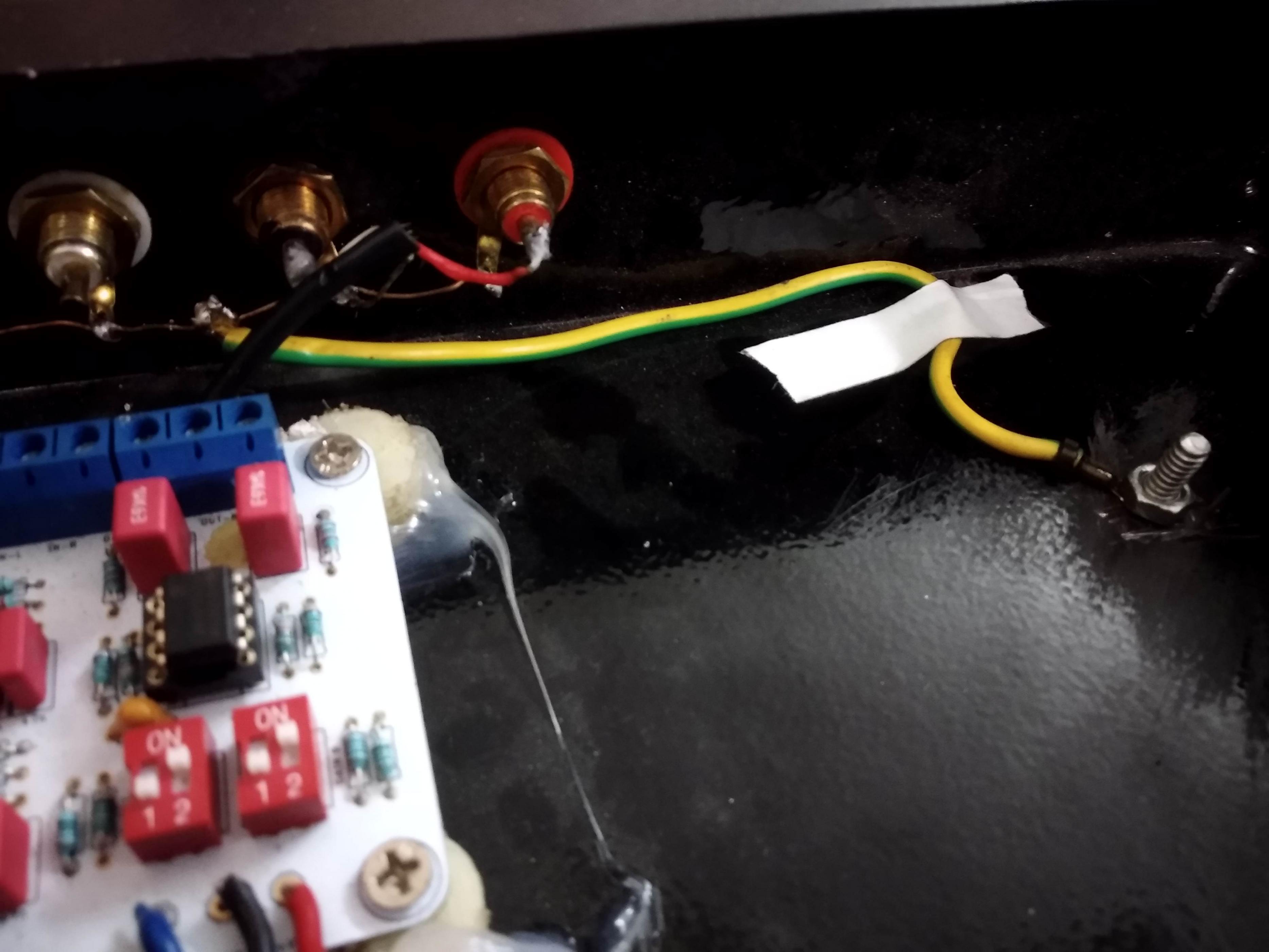

I have checked all connections and there is no problem. I have a big casing to match all other equipments. I have used a ei core transformer which is at least 11 inch way from the main circuitry. I have connected the ground by a wire both with the chassis and the RCA negative side. Checked the ground and other connections by meter, it is ok. There is no loose connection. Still the buzzing and humming sound prevailing. It is auditable from 3 meter distance when the volume is full. At 3/4 of volume it can be heard from 1 m distance. Can anyone help. I wrote to the vendor, there is no reply! I am attaching pictures showing all connections , dip switch and setting.

In any case I suggest a wire to earth the chassis, including your safety, and the amp.

I have a muffsy (I actually have 3...) and I have found it to be somewhat susceptible to induced hum from the transformer, in my experience, 11” is not anywhere near enough distance. Do you have a 15v AC wall wart you can try? When the phonostage is far from the transformer, my circuit is silent.

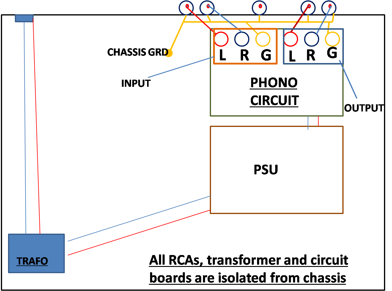

Your grounding looks like it may need a change, but it’s not entirely visible in the photos. Can you draw it out for us? All chassis and PCB connections.

Here is the diagram of the phono stage. All RCAs, Transformer and Circuit Boards are isolated from the chassis, only the ground connection is connected to the chassis.
Since you have this in an uninsulated chassis you must have a fuse on the live side of your AC after the IEC before the transformer, and an attachment to the mains safety earth.

I agree that the chassis should be connected to the ground pin on the IEC, just in case.
