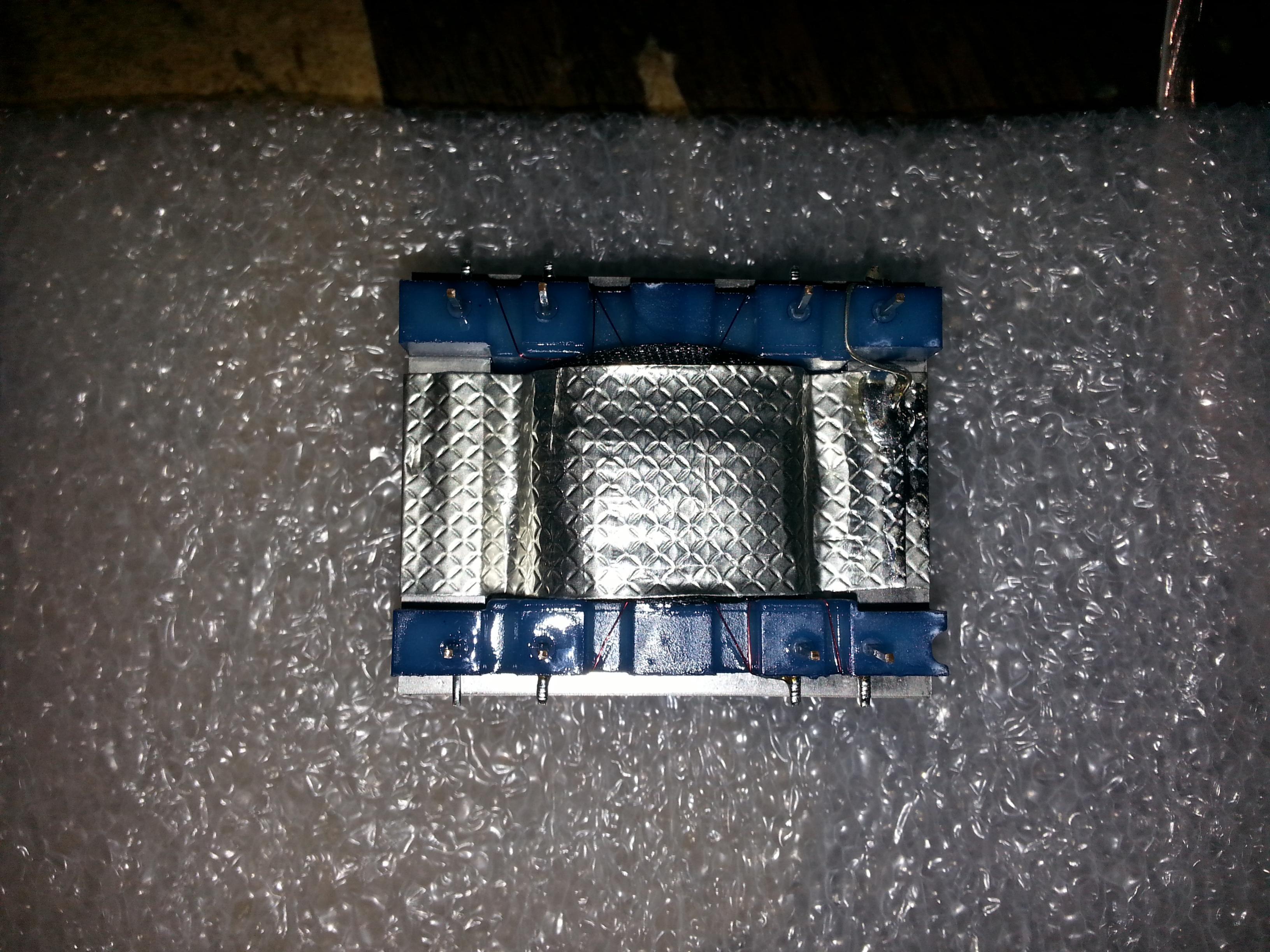

Im trying to figure out a solution. I have an 15k/15k input transformer that is wound on a bobbin with nickel. Sounds amazing, but im getting buzz and hum. I have a cinemag input trafos, which are expensive, and I use it as my reference, and when connected to my amp, its super quiet. Having said that, Im trying to find a unique solution, but on the cheap. Im wondering if I coat the transformer with a heavy Shellac or other type of resin. Step 2, apply a 2-3 coats of this EMI Nickel Shield over the shellec coat. Then possibly put this input tranfos in a small plastic box, that is coated on the inside and outside. Giving this 3 barriers of EMI protection. Here is the Emi shield in a can

It has the belly band as you can all see in the pic. But it doesn't seem to correct the problem.

Here is my cinemag. Its so quiet, its wonderful. But too expensive...

Notice the resistors in the primary and secondary. I wonder if I put some R's if that will help. However it would change the impedance.

Experience? Actually, you can't tell for certain as RF can sometimes sound like buzz if it is modulated but buzz/hum are probably coming in as low frequency.
Rayma was so thoughtful to send me a out a sheet of MU so I can bend up a box test.
You are aware that mu metal always needs re-annealing after any metalworking?
Do I earth ground the MU box ?
Not necessary for magnetic shielding.
