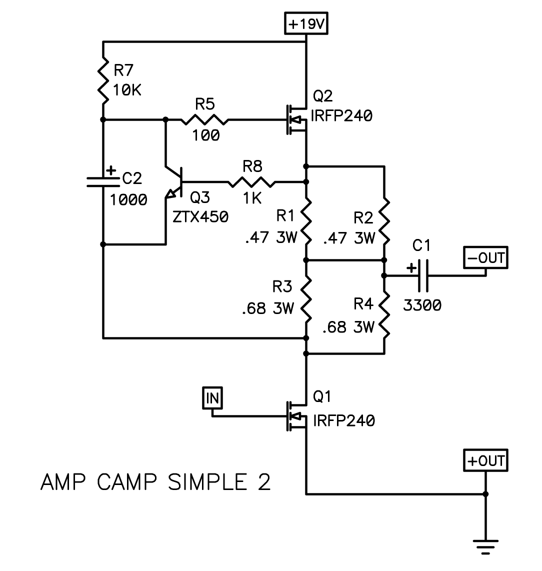

I just finished an ACA, and I'm about to finish a J2 clone. I've read all the Broskie articles on SRPP, IMC, and SRPP+, but I still don't know how one modifies an NP design when it comes the the Mu Follower portion of the amp.
When NP explains the way his circuit works, there's always a part where I lose the line of reasoning on why a part of a certain value was chosen, or how that part works in the Mu Follower.
Can I ask those who understand such things to walk me (or us if others are also lost) through an Mu Follower of NP's design? Perhaps the ACA? To be explicit, how is the ratio of resistors determined in the Mu Follower? Size of the Cap? Voltage of the circuit? How can one modify these things for better outcomes when one modifies a circuit?

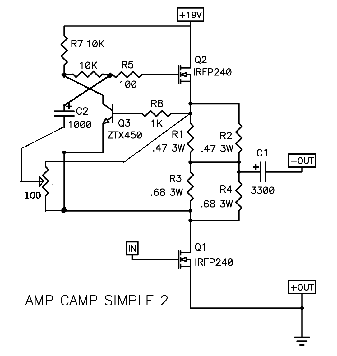

In the RO85 thread, you have one of the most complete descriptions you will find. To understand further, just modify the ACA by adding a two 10R pots across R1-R4. One output of the pot should feed the bottom of C2 and the other should feed the output of the amp. You will be able to vary the operating condistions of the amp in a couple different ways. I believe this quote will help explain it better than I. You will n eed to be able to measure distortion to truly apprreciate the exercise. I may have this wrong, so perhaps someone will chip in and correct my errors, if present.

answer one - I don't have one day of formal education in field of electronic
answer two - you can see me trying to redirect threads when I have impression that ppl are poking things which Papa evidently didn't share and don't wanna share ...... which certainly isn't case here
answer three - look for Wensan's threads ; but - if you really already read everything you mention , how on earth someone with limited patience for use of non-native language ( as is case with moi ) can write you a book ?
answer four - however , if blaming me makes you feel better , just go for it ...
answer five - buy me that drek from the pic , and I'll write you a book ; buy it for your self , and World is your Oyster (maybe)
edit:
answer six - you really got complete information/answer with that AP pic ;

NB that , for that test of ACA upper part , one need to differentiate DC path ( bias of mosfet ) and AC path (modulation of mosfet gate )
so - emiter of bjt needs to stay where is it , while bottom of cap can be driven via viper of pot , proposed bu you
I forgot to say - sorry , still digesting first morning coffee - to be able to do that , one need to introduce few more resistors , to make both paths (dc and ac) equal in wiev of mosfet's gate 😉
lazy to sketch that now , but let's say - equal (several K) resistors from gate to cap and from gate to bjt's collector
.... or cap directly to gate , with ,say,4K7 to 10K to bjt colector
Oh, the Zen Pot, here is it again, allows a fine tuning of k2 to k3 ratio!
It is a pleasure to see it at the PC, how the values change....😀😀
