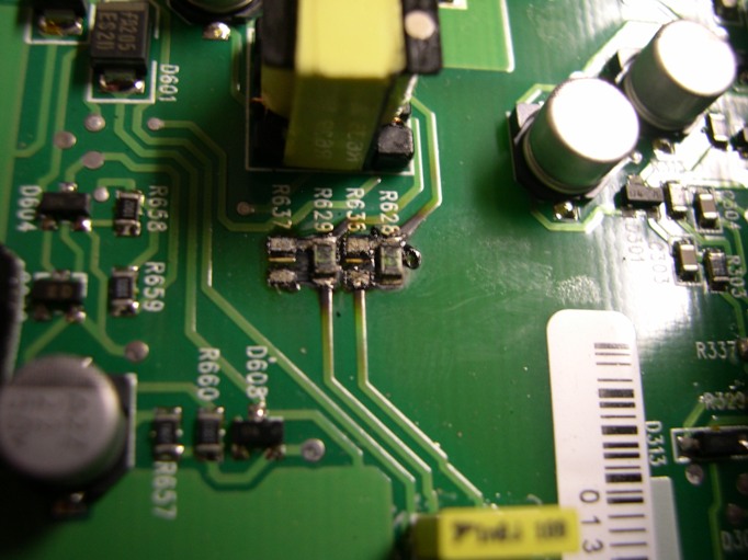

This amp had some FETs burned out in the power supply which also took out some surface mount resistors. Does anyone know the value of R628, R629, R636, R637? Was there originally four and two got blown right off the board? Its hard to tell and the remaining resistors are unreadable. The pictures posted on Ampguts weren't usable.
If they go from the driver transformer to the power supply FETs and there are two groups of parallel resistors, I'd try 68 ohms in each location (68 x 4 resistors). This should get it to power up.

yeah they go from the driver transformer to the power supply Fets (HUF75339). it looks like there might have been a total of two resistors in parallel for each group or just one for each group and empty pads. Only one in each group remain and its not clear if the pads were originally empty? The rest of the transistors all check out fine.

i can throw some 68ohm resistors on it after i replace the two power supply fet's but would it be close enough to original to allow me to fully test this amp if it powers up ok?

Monitor the temperature of the power supply FETs. If they don't get hot when you drive the amp hard, the replacement resistors are close enough.
They're probably 0805s (0.08" x 0.05"). If you don't have a dial caliper to measure them, you can use the ICs on the board to estimate their size. the SMD ICs have a pin spacing of 0.05". The through-hole DIP ICs have a pin spacing of 0.1" If the length is slightly greater than the center to center spacing between adjacent legs of a DIP IC, it's a 1206. If the length is less than the center to center spacing between legs, it's an 0805.

Looking at the pics you posted (Thanks) i'm pretty sure they are 0805's. You gave a value of 68ohms which would be 34ohms overall since they are in parallel. I have some 75 ohm resistors in the proper size which would yeild ~38ohms in parallel. Would these be close enough or should i just order some 68 ohm resistors?
