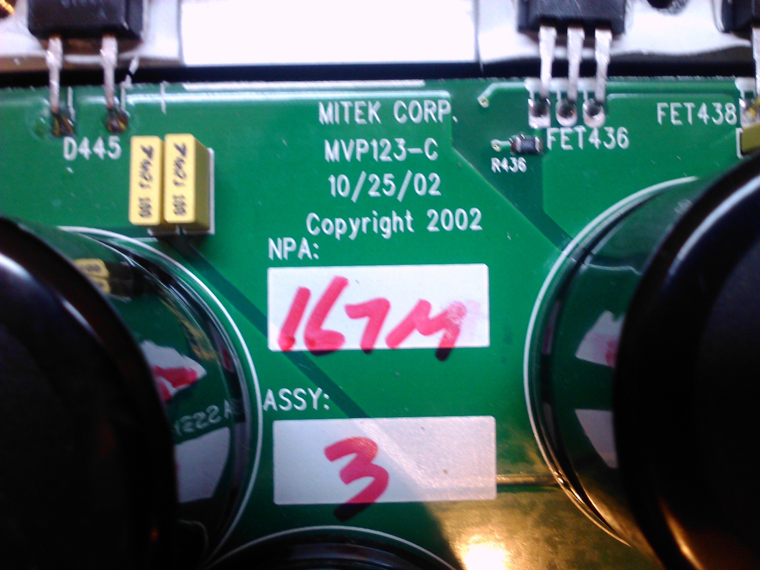

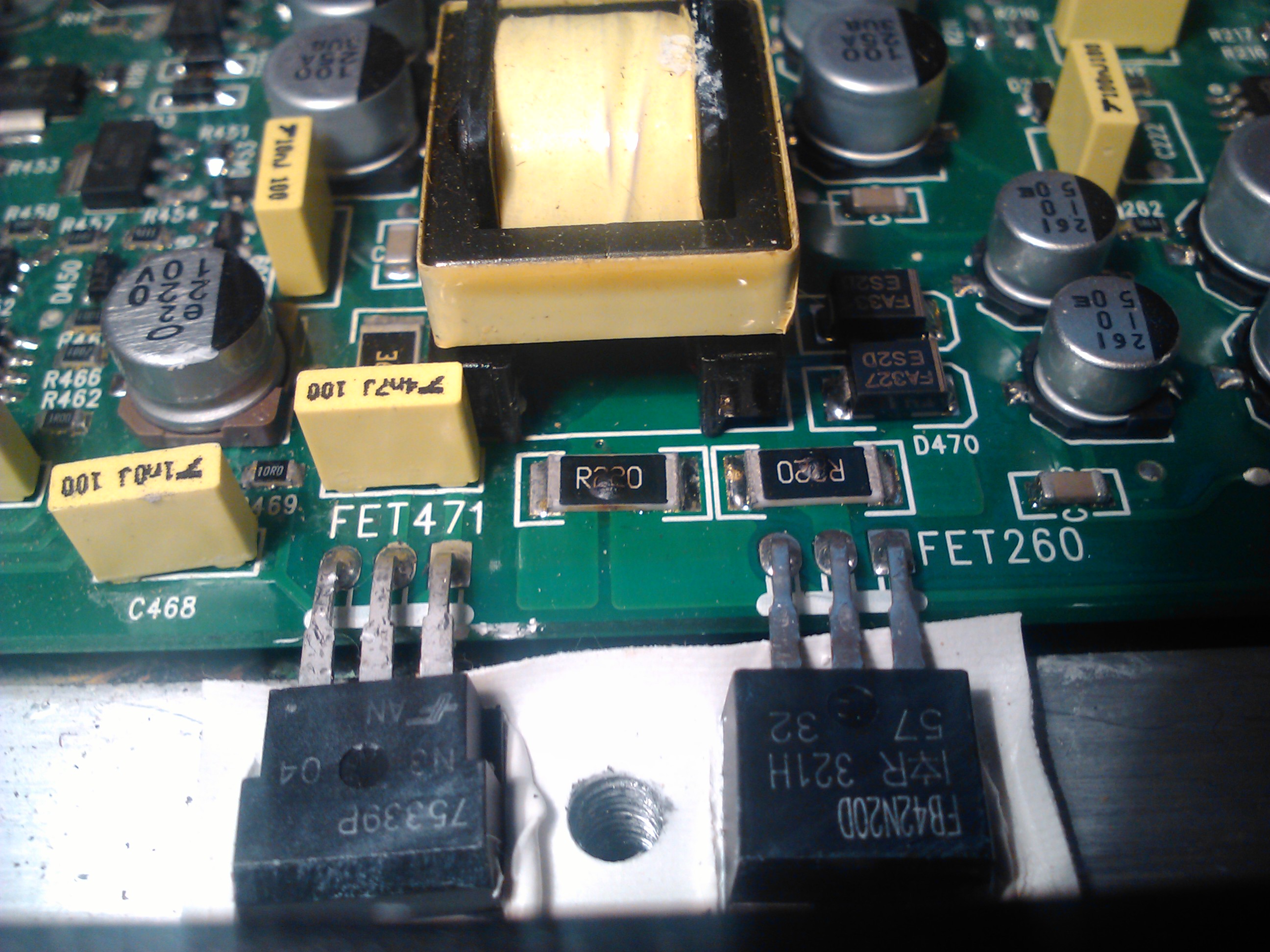

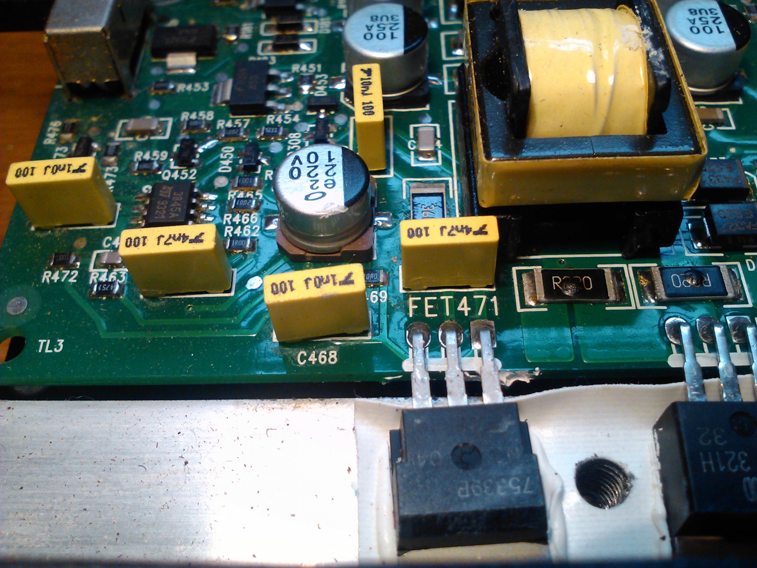

I have had this amp since 2004. A few years back it shorted out when one of the power/ground leads came loose and arced. At least this is what I think happened. Since then it has not worked. It turns on but produces no sound. I have two of them, one working one not. I have used my dmm to analyze the fets and all seem to be working. And Caps seem to have little wear to none. I did however notice some oxidation on the underneath side connected to the yellow transformer and FET471 on the SouthWest side of the amp below the RCA IO's and phase switch. Here are a few pictures to become oriented with. Thank you for any help as I have little experience with amplifier repair but am eager to learn.

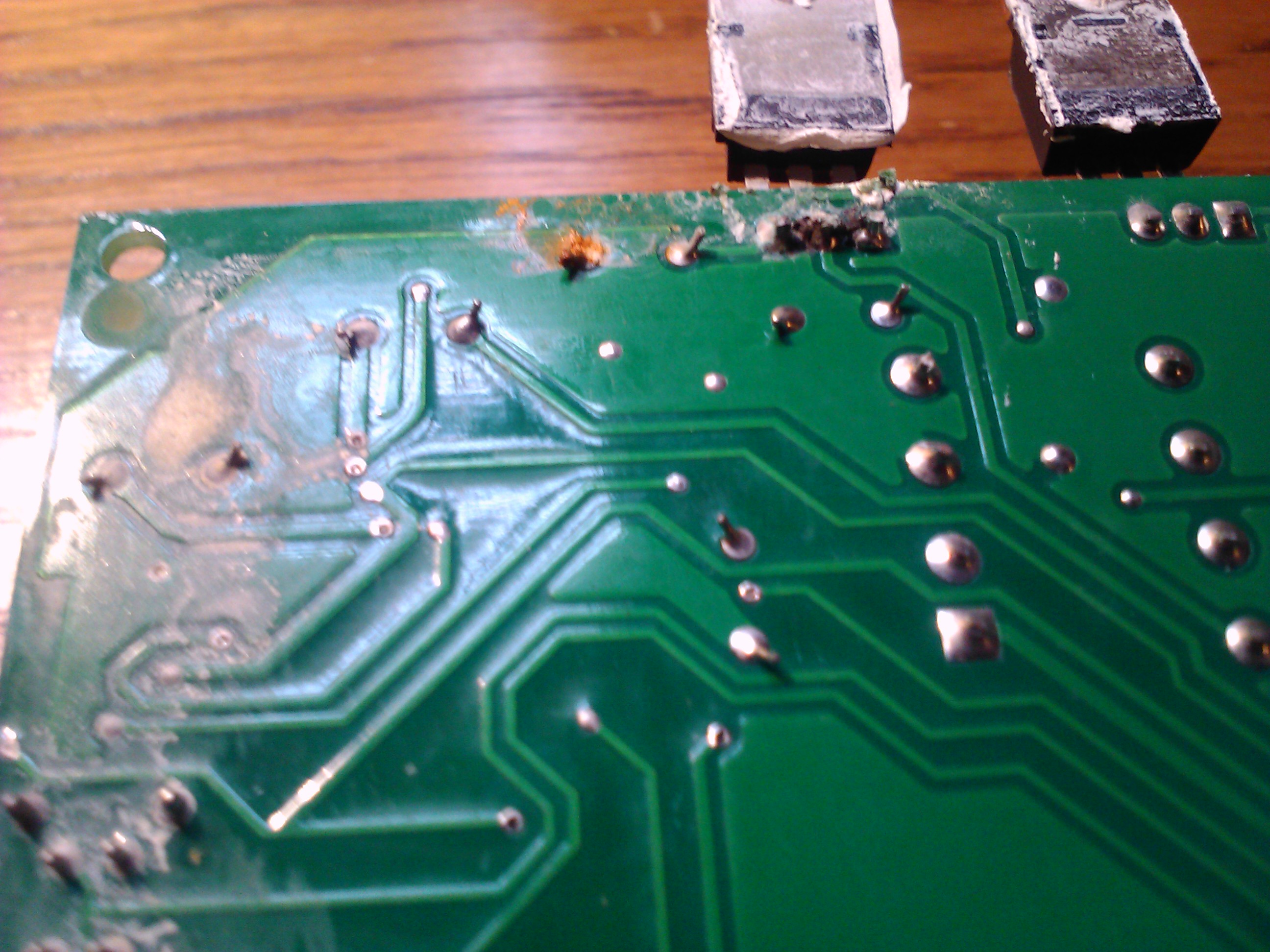

You'll need to clean the corrosion and confirm that the traces that were corroded are intact.
There are two burned resistors in the photo. They're 0.22 ohm resistors. They'll need to be replaced before you can do anything else.

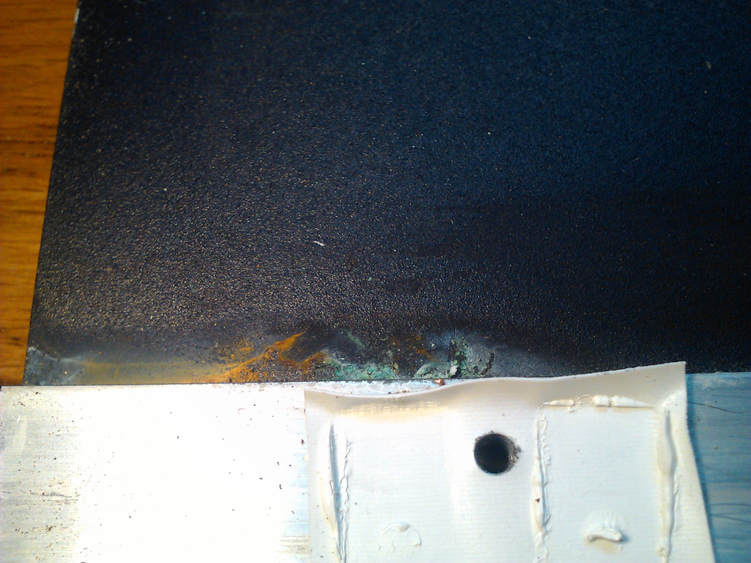

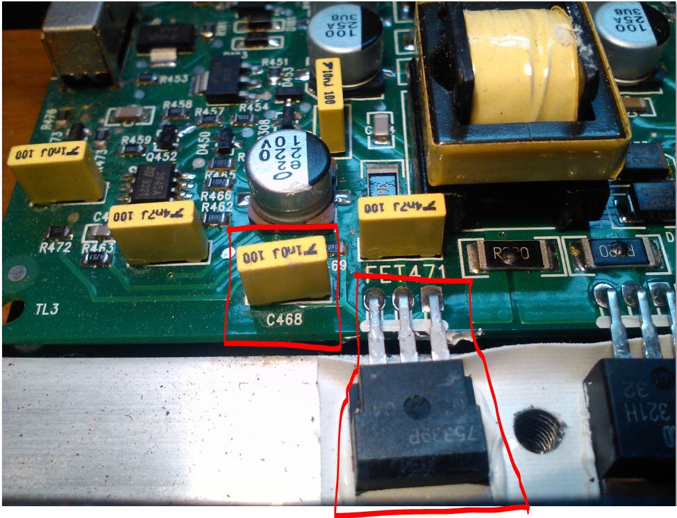

Okay. I just cleaned them. Everything appears to be intact with no loose connections. This amp has not been hooked up to a power source for at least a week. Will I need to discharge anything before preceding. These two components seem to appear to be where the corrosion is coming from. Only the black one highlighted is a 75339 the other says this on it....(FB42n20D ___IR 321H___5732). Also it appears that R220 SMD/SMT 's are burned up. Thank you for pointing that out. I dont know how to look those up any possibility you know what part number to look up for them? The Resistors (.22 ohm) that I have found to replace them come in a variety of wattages and % ppm. BTW thank you so much for your assistance.

The resistors are the SMD components marked R220.
You need to measure them with a dial caliper and order replacements the same size. IF you don't have a dial caliper, I can measure the ones on a junker I have.
The corrosion likely came from an outside source. The yellow capacitors don't contain any fluid and therefore cannot leak.
The components clamped to the heatsink are FETs (HUF75339P and IRFB42N20D).
