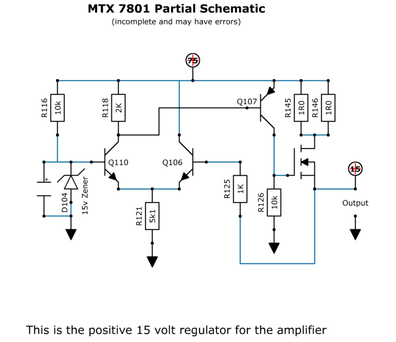

I repair MTX amplifier and accidentally shorted the power supply of the preamplifier board during measurements with a multimeter. As a result, the diode (most likely the zener) was damaged. Its designation on the PCB is D104. The PCB designation is MVP305-C 07/02/08
There is a similar diode on the other side and it seems to me to be the same as the damaged one, but I am definitely not. It seems to me that the circuits with two IRF540N mosfets can generate + - 15 voltages for operational amplifiers. One of them has been short-circuited and now I have + 45V on the TL074C operational amplifiers. 😡
Does anyone have this amplifier or its photos in high resolution or know what kind of diode it is?I would be grateful.

After repairing the positive power section of the NE5532, there is a new problem. I replaced the NE5532 and 3120.
When I turn on the power supply set at 12.6V with a limit of 3A with the soldered NE5532, they start to heat up quickly and strongly. The IRF540 negative power NE5532 transistor also heats up very quickly.
The supply voltage drops to 8V and the current remains limited to 3A. It looks like a typical short circuit. When the NE5532 is desoldered, the voltage momentarily drops to 8V. As soon as the capacitors are charged, the voltage rises to 12.6V and the current drops to 0.6A.
@Perry Babin do you have any idea what could be wrong? I checked the whole negative section for NE5532 and everything is ok. I replaced the IRF540 even though it was operational and it did not help.

In one of the topics regarding 7801 you wrote (if I remember correctly) that the heating of the IRF540 is normal, because ne5532 is a load for the IRF.
The board with two TL074C and potentiometers is also provided by the IRF540. Turns out it's normal for this amp, but it's the first time I see the NE5532 at 70 degrees Celsius in operation.
