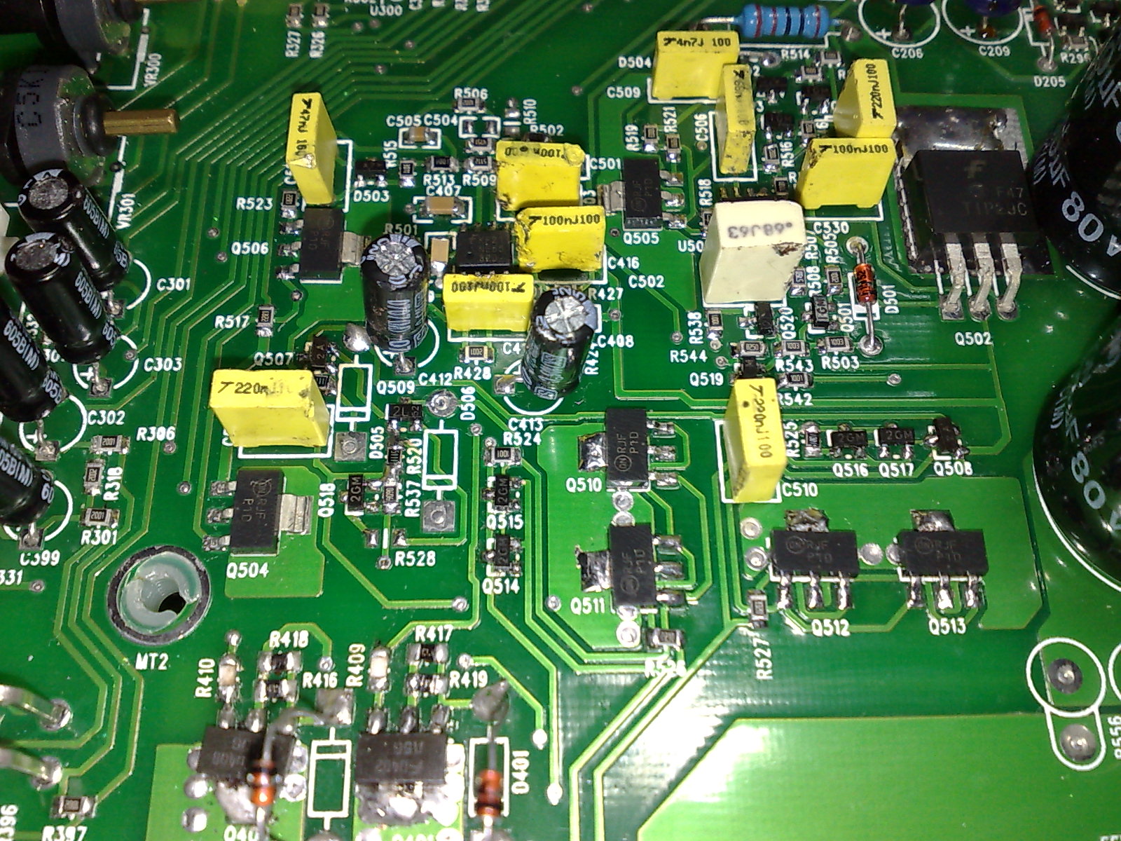

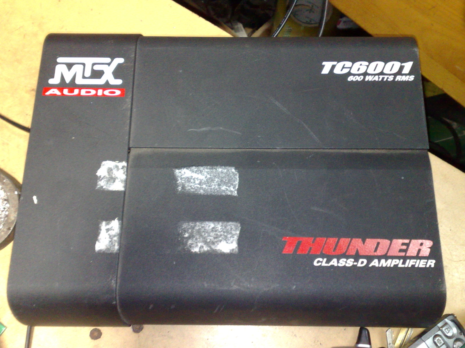

HI,Perry.I need your help.Do you have the Amplifier photo? This amplifier has been repaired, but still not fix it, some resistors and transistors are not the original model.
it looks like all the outputs are missing. if you didn't remove the parts yourself and you don't have a scematic it may be difficult to repair.
but don't let me discourage you, perry is "THE KING" and in my opinion can work miracles.
I'm sorry, I don't have any information on that amp.
If the components are aligned perfectly straight with the solder pads, there's a good chance that they're the original parts.
Have you tried installing all of the components to see if there is a problem or to determine what sort of problem it has?

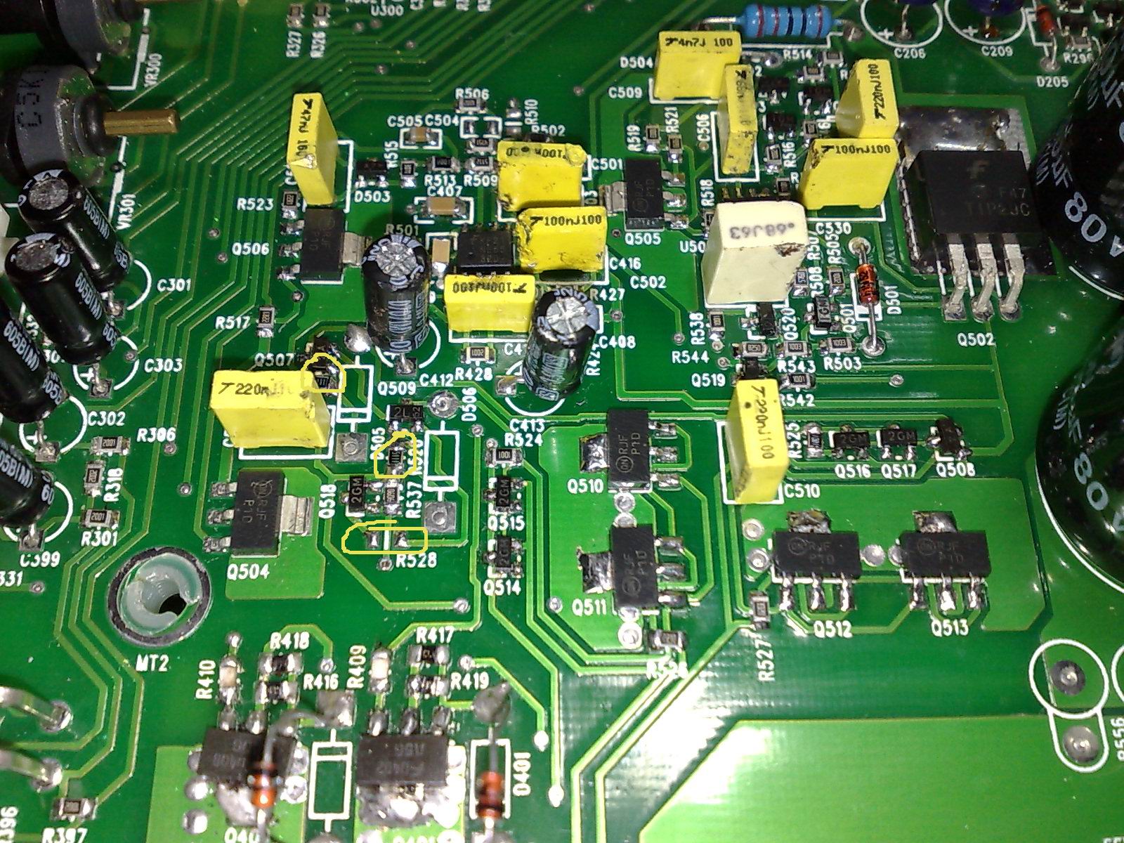

I found the problemHI,Perry.I need your help.Do you have the Amplifier photo? This amplifier has been repaired, but still not fix it, some resistors and transistors are not the original model.
R516=471(470 Ohm)
R520=471(470 Ohm)
R528=221(220 Ohm)
