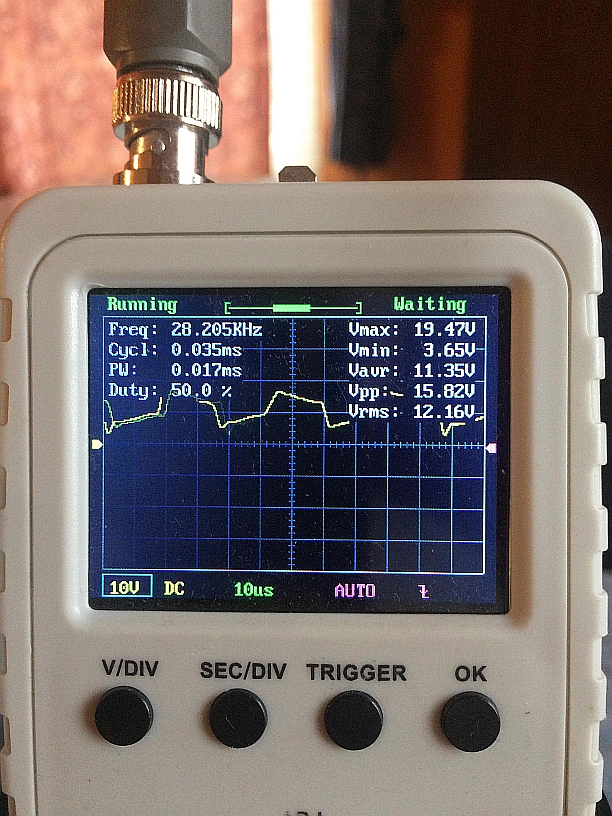

So I do have rail voltages of +49.5vrms and -50.3vrms, but the power supply mosfets are getting pretty hot after 10seconds, even that the gate drive looks kind-a OK.
2A of current pull at idle...doesn't seem alright to me. LED is staying RED.

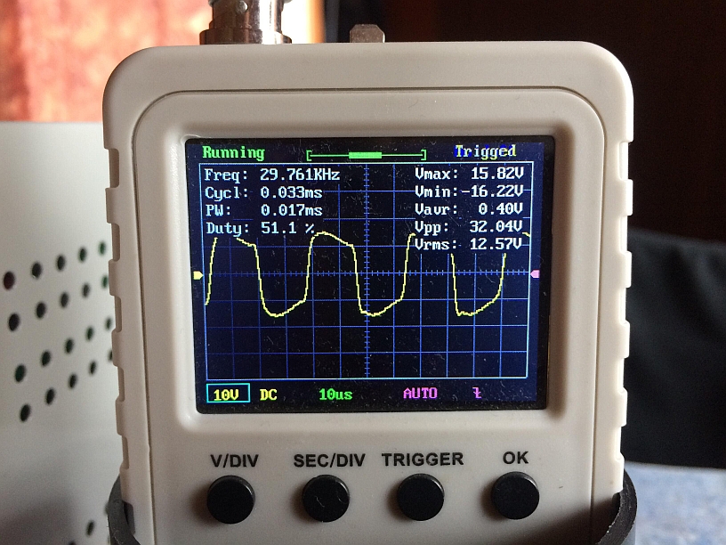

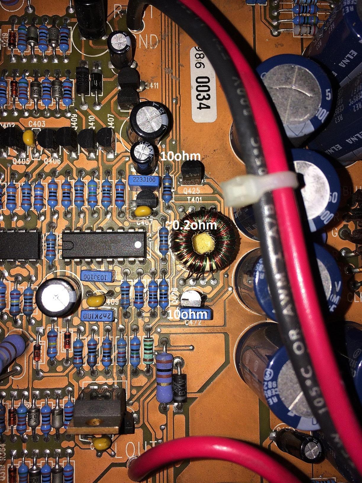

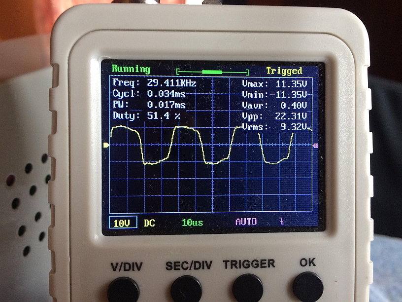

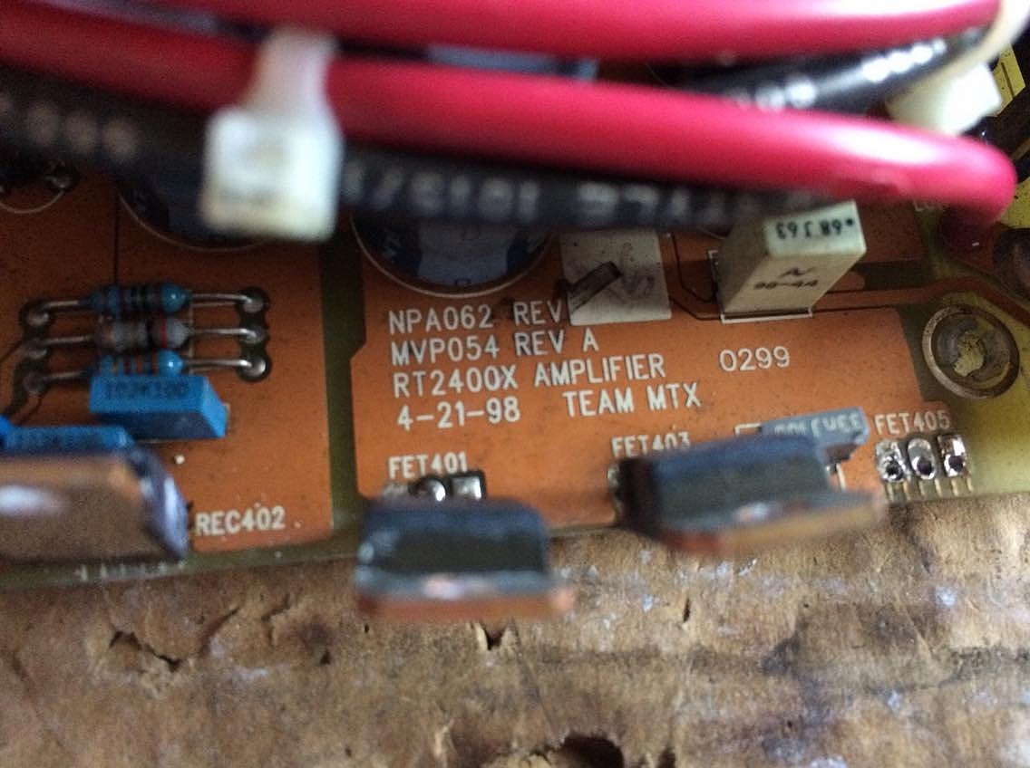

Here are pictures of the board (before putting all of the PS Fets and rectifiers) and how does the wave looks at the gate and source of the Power Supply Mosfets...What I noticed is that on the TL494 and the buffer transistors the same gate drive looks awful, but once it passes the small choke near the transformer, it gets the way it is on the pads of the PS Mosfets (pictures attached).
What I'm concern is primarily the amount of heat the power mosfets are generating...I've repaired at least 100+ amplifiers so far and none of their Power Supply section was getting even warm when working correctly.

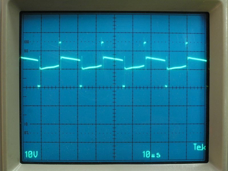

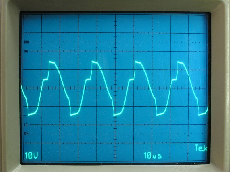

The attached is the gate drive from an MTX 2300 (I think).

Bias knob doesn't seems to affect this. Gate resistors are only 2 pieces - 1 per bank ~ 33ohms and they are rated 1W or 2W, not the smaller ones with the lower power rating...They read exactly 33ohms.
And I see no current changes ,no matter rectifiers out, or rectifiers in. Still pulling out 1.8-2.0A at idle. Nothing else is heating up, except the power supply fets.
The weird wave is the gate drive directly measured on the TL494 pin 8 and 11.
Thank You Perry for the reference. So gate drive at tl494 is almost the same as yours.
The amplifiers are similar, they are from the same line and same era and even the boards look really close.

What's the date on the board? The amp that made the FETs heat up was made in 8/27/98. There was nothing that could be done to make those run cool. I tried everything that I could think of since I had multiple amps of the same model to repair. Even with the heating FETs, they were reliable.
Did the two PNP driver transistors fail? If so, is the 1k resistor between their emitters within tolerance?

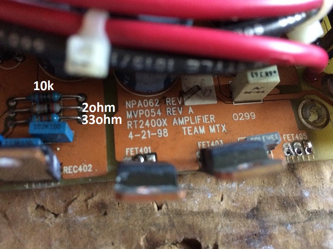

The gate resistor should be in that group of 3 resistors in post #10. Is that what you replaced?
See also #11.
See also #11.
The driver transistors were fine, hfe > 250.
All the resistors are within tolerance and correspond to their marking.
There is no 1k resistor in this group or the one at the other side of the board...And I can say within 99% that these were fitted from the factory as I can see that there were no soldering in this area.
And yes the gate resistor is bottom one. This is the one i've changed, but due to making it worse, i've soldered the old one back.
You're reading the transformer winding. It's likely OK but since you've checked virtually anything else, I'd desolder and check it.
Is any of the board blackened between the gate and other FET pads? If so it can and will conduct between the source and gate pads. It will cause the FETs to get hot and gate drive to be erratic.
Checked that 1k resistor out of the board - reads fine, it is in tolerance...
