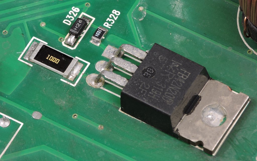

H2 = MMSZ5242BT1
I'm assuming that the 100 ohm resistor is R327.
MTX 8100D REPAIR QUESTION
Hello Members: I have an mx8100d that is blowing ssp45n20a fet. I have replaced all the parts associated with the circuit but it is still blowing the fet. I wonder what I'm missing. I replaced fet with ssp45n20b wich I assume is the same part. Any help greatly appreciated.
This is a different amplifier. Looks like the 80v rail is connected to drain of the fet. But I don't know what the output or source is connected to. I don't have a schematic. I was hoping someone had experienced same problem. I replaced zener diode,100 ohm resistor and fet but still blows the fet.
The drain is connected to the + rail. One end of the 100 ohm resistor connects to the negative rail. The other end to the source of the FET. When the amp is switched on, nothing flows through the FET. When it's switched off, the FET passes current through the FET. The current is limited due to the 12v zener limiting the voltage across the 100 ohm resistor to about 9v.
