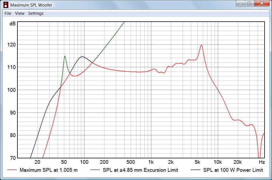

Of course. Xmax of the Faital 5FE120 in normal reading actually is 3.25 mm and the sensitivity, based on manufacturer TS-parameters, is more likely around 86 dB.
Drivers having a Qts of almost 0.5 and a high resonant frequency are not really suited to go very low. You only achieved that by choosing a non flat alignment (EBS3 ?), which has a peak at 50 Hz and a poor transient response (boomy).
Regarding MTM there are two things to consider. Wiring two Faital drivers in parallel results in a load of only 2.7 ohm, which is too low for many amplifiers. Wiring the drivers in series gives a load of 10.8 ohm, and that's pretty high. Thus, the best solution would be two 4 ohm drivers wired in series IMO. Further, MTMs not having the tweeter on ear height require a fairly low crossover frequency of 1.5-2 kHz. I doubt the Tang Band tweeter can do that.

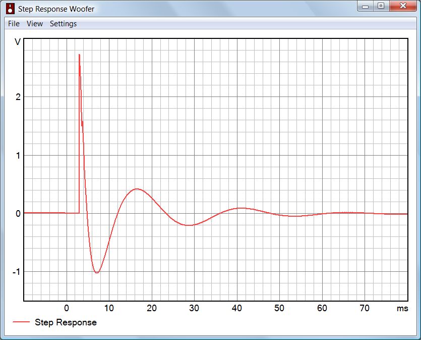

I didn't really choose an alignment, I just kind of played around with box size and tuning freq. That Qts of 0.477 is on the high side traditionally, but it seemed to look ok on the graphs. Maybe you can't rely on your modeling program for everything, but let's say for the sake of argument that if it looks good on the graphs, how do you know it won't be good?
For instance, the modeled bass frequency response didn't show any peaks on the graph, and the modeled group delay was under one cycle time. Worst group delay spot was 19ms somewhere around 40Hz, which I thought was supposed to be inaudible. Am I running into limitations with WinISD or am I not looking at or thinking about the right things?
Also, is transient response related to group delay or is it something entirely different?

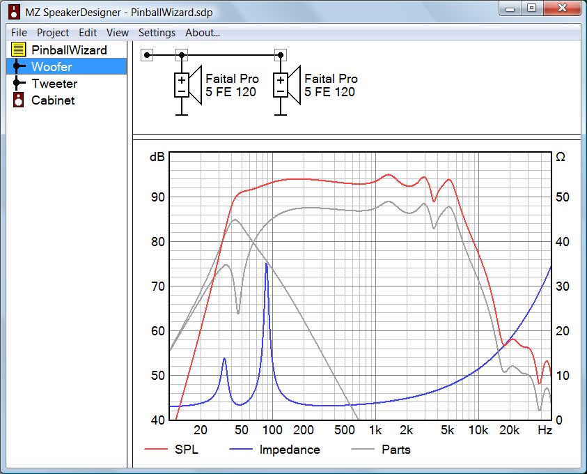

Thanks so much for posting those graphs Dissi. I took a look at the website, your software looks pretty slick. I hesitate to download the trial for fear I will be sad when the trial period runs out... That ringing looks to be around 60Hz or so. Is that around where you tuned the enclosure? I may have to download the trial version just to see what some other transient responses look like in comparison.
dumptruck, I never looked at the DS175-8, not sure why. It models really impressively in a small box. You mentioned a 3-way. I wonder if it will be able to handle the mids up to 1.5k or 2k in a 2-way? The graph at least looks kind of ragged in the mids to me.

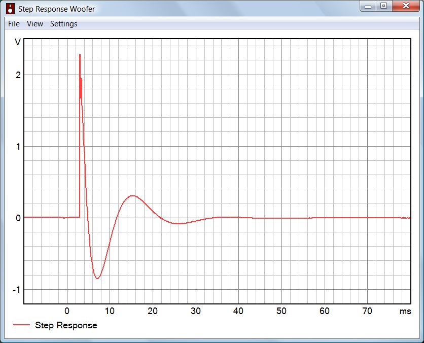

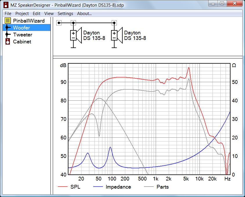

Attached is an example of a moderate bass reflex alignment: two Dayton DS135-8 in 10 liters. It has less bass extension, but a smooth rolloff and a better transient response.
The big advantage of MTM is the high maximum SPL in the midrange IMO. A conventional 2-way only makes 102-104 dB, having 6 more dB of headroom makes a difference.
