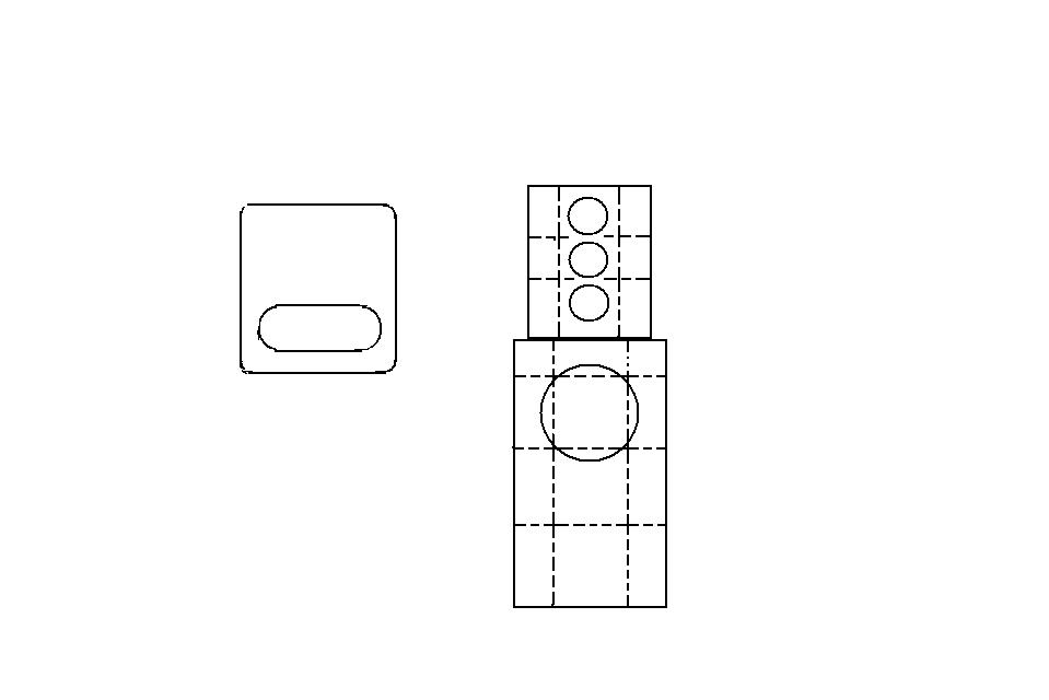

I'm very keen on an idea of mine
its a modular satelilite system to be paired with 2 or 4 10" bassmodules
it will consist of 1 1" tweeter
and 1-4 6.5" woofers.
the 2 and 4 woofer versions the outmost woofers will probably be shunted at ~450-500Hz
It will either be vented fullrange or tuned to ~70-75 Hz
or sealed tuned to ~70-75 Hz, not decided yet
The problem is i don't know how to compensate for the back wall gain and the phase issues. amongst other things
I really have to get hold of a good book in the subject and buy a mic!
So if you've got any good reading tips, pleas post!
Many things depend on size of your listening room, and listening distance, and distance between L/R speaker
Big speakers doesnt work well in very small rooms with short listening distance
Placed against wall is problematic too
It will compromise the fine aspects of reproduction, such as soundstage etc
Smaller design would do best
Going BIG in a small room, maybe possible with a very tight closed low Q bass design...and response above that will have to be "customised" to the special situation
But much too little lowend is a risk too, which I also think is really awfull...though too much is worse
But my listening distance to a 3way is only 2-2.5 meter, so it is possible
But I still think that a smaller 2way would be better
But up against a wall ?...probably NOT a 2.5way, maybe with the exception of using very small woofers, like 5"
But with a 3way, a very low xo point may help...that would be more like a 2way +sub
But its a very fine line to walk, and exstremely difficult to get absolutely right
Active EQ on woofer might help a lot
Active room EQ might be nice too
I was thinking about 10-20cm from backwall, which is ca 5cm absorbpanel on concrete walltinitus said:
As i wrote it is a satelite system, I already have the bassmodules.tinitus said:
2x10", active XO @ 80:ish
