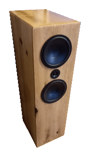

Here's a picture of the reference - it's about 77lt of volume. I'll get some measurements against the experimental TL/Inverse horn (train wreck) at some point when that cabinet is ready which will be about 100lt (or a bit less) I think.
