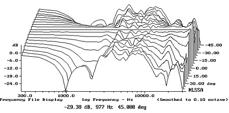

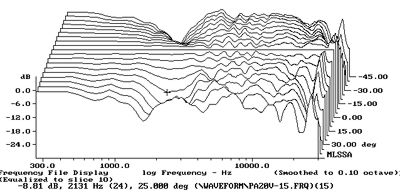

For what it's worth here is two links of stereophiles measurements of vertical off-axis of what I would call a good MTM and a good TM. The MTM is with 5.25", as closely as possible spaced drivers and steep crossover slope @ 2 kHz designed by Joe himself. The TM is 6" midbass and a tweeter with about equally steep crossover @ 1.5 kHz cut-off.
MTM, Snell LCR7 XL: http://www.stereophile.com/images/archivesart/606Snefig5.jpg
Paradigm Active/20:
http://www.stereophile.com/images/archivesart/P20fig05.jpg
Paradigm Active/20:

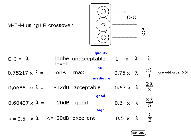

If you look at the picture:
http://www.diyaudio.com/forums/attachment.php?postid=1215500&stamp=1179784790
You can see the directivity for short arrays is plotted for n= 10 to 4 and that Lambda criteria must be lowered to be of any use.
Now an array with n=2 as for a M-T-M can be estimated from the picture = Lambda (p) = 0.75 x Lambda
I believe that this number should be used for estimating performance for an M-T-M, as the very upper limit to crossover at.
Consequences when applying to LR M-T-M: s, see picture:
