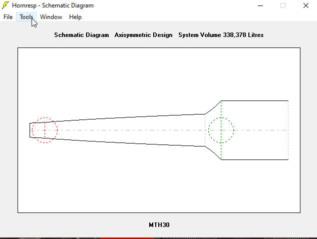

I wanted to ask if anyone here built a mouth extender for the tapped horn MTH-30. I have 2 of these and I need a little more SPL or a little more extension! Thank you very much.

Model it in HornResp... but, IMHO, I don't think you can just add 'barn doors' to a TH in the way you can with a folded horn.

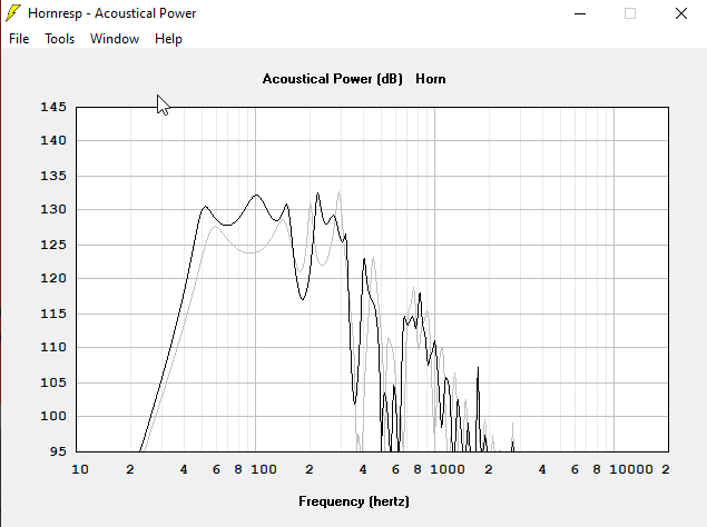

With a 70 cm deep and 3000 square cm frontresonator you get this response.
Grey curve is the MTH30 with a B&C 12PS100. Black curve is the same MTH30 and driver but with the frontresonator added.
I found the Hornresp sim online. I have no idea if it is the right one or if the B&C 12PS100 is a suitable driver.

Thanks weltersys for that link. I had forgot about the pictures, simulations and real life test and measurements of a THAM15 with a large frontresonator as I proposed in my previous post in this thread.
The frontresonator might be large but can be made foldable and easy to pack as a flat pack when not in use or during transport. It does seam to add between 4 and 6 db of usable output.
Looks great, extension & sensitivity
