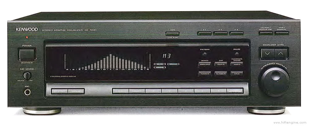

I used to get a lot of value out of one of these *. It helped me refine crossovers and compensate for recordings or whatever. It had some PEQ and memory settings.
with a better sound card
You don't need a great sound card to get that off the ground. Start with the one you're using now, and try some software.
