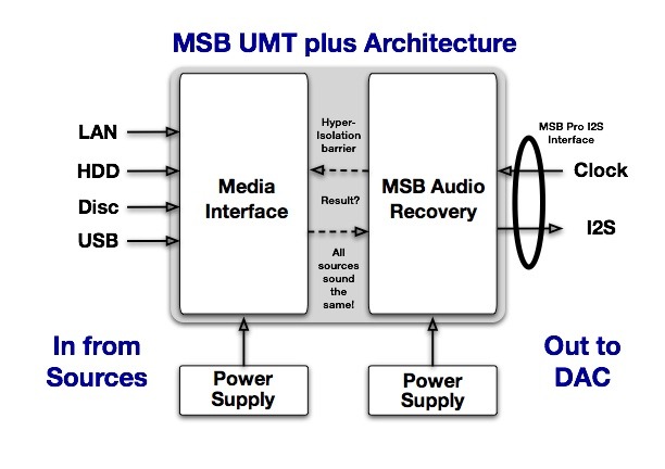

My friend has a MSB DAC which has RJ45 input called I2S pro. DAC feedback the clock to MSB transport. for the rest of the pin should be I2S signal.
Any one know how to connect the another I2S device to MSB I2S pro.
For example, I have philips CDM4 transport which has HDMI and RJ45.
If I know the pin assignment of MSB DAC RJ45. I can make the connection to MSB DAC

If the MSB dac is exporting a master clock signal (likely in LVDS format), you need to measure it with a scope to get the frequency, and also measure the other signals the MSB UMT sends back to the dac. Then you can design a box to do the same thing. This assumes there is nothing encrypted in their implementation, and that's its just typical I2S bus over LVDS.
