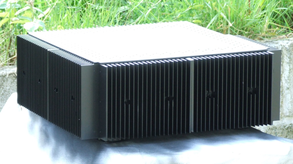

Aleph 4 100W Pass - Class A is a monster
This beast sheds over 300W in heat alone. It is a real delight to listen to but it is HUGE.
IIRC the commercial products were designed to run a little hotter than my beast. The commercial Aleph 4 ran at about 80-85 degrees C, mine is a bit cooler at 55 = 60 degrees C.
damn that's massive.
where do you get this numbers from??????
from the aleph 4 manual:
"This amplifier runs hot. The heat sinks will warm up in about an hour to a temperature which
will not be comfortable to touch for more than a moment or two, which is 120 to 130 degrees
Fahrenheit (50 to 55 degrees Celsius). This is normal, and there is a thermal shut off system
which will shut down the amplifier at internal temperatures in excess of 160 deg. F. and 70
deg. C."
deg. C."
I think you will find that might be right in an air conditioned room but in the real world they run hotter.
i THINK that the 70c thermal shotdown will kick inn long before the amp gets close to 80c. no matter what the ambient is.
i highly doubt that Nelson Pass designed any amp s that MUST have air condition to run.
