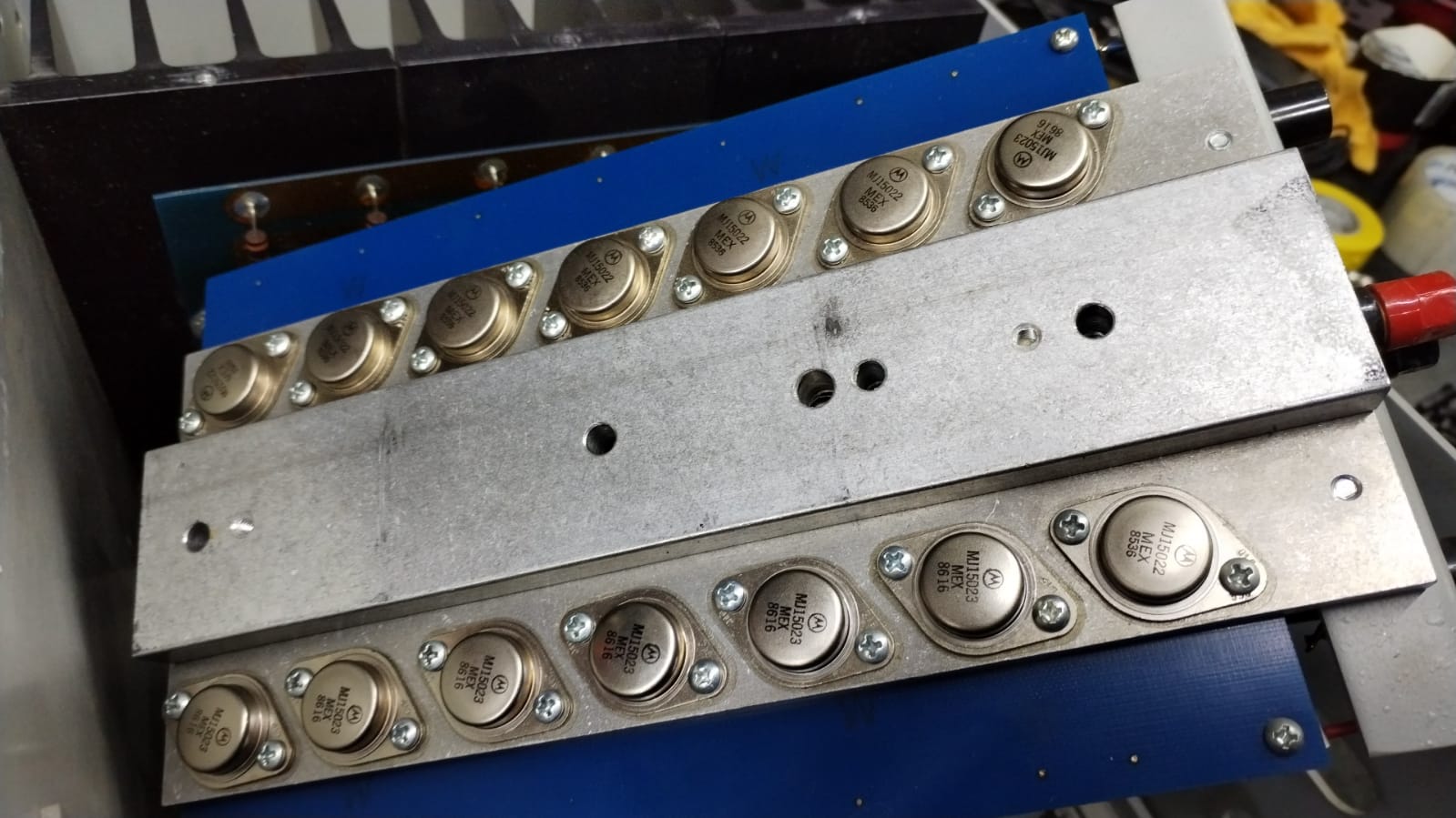

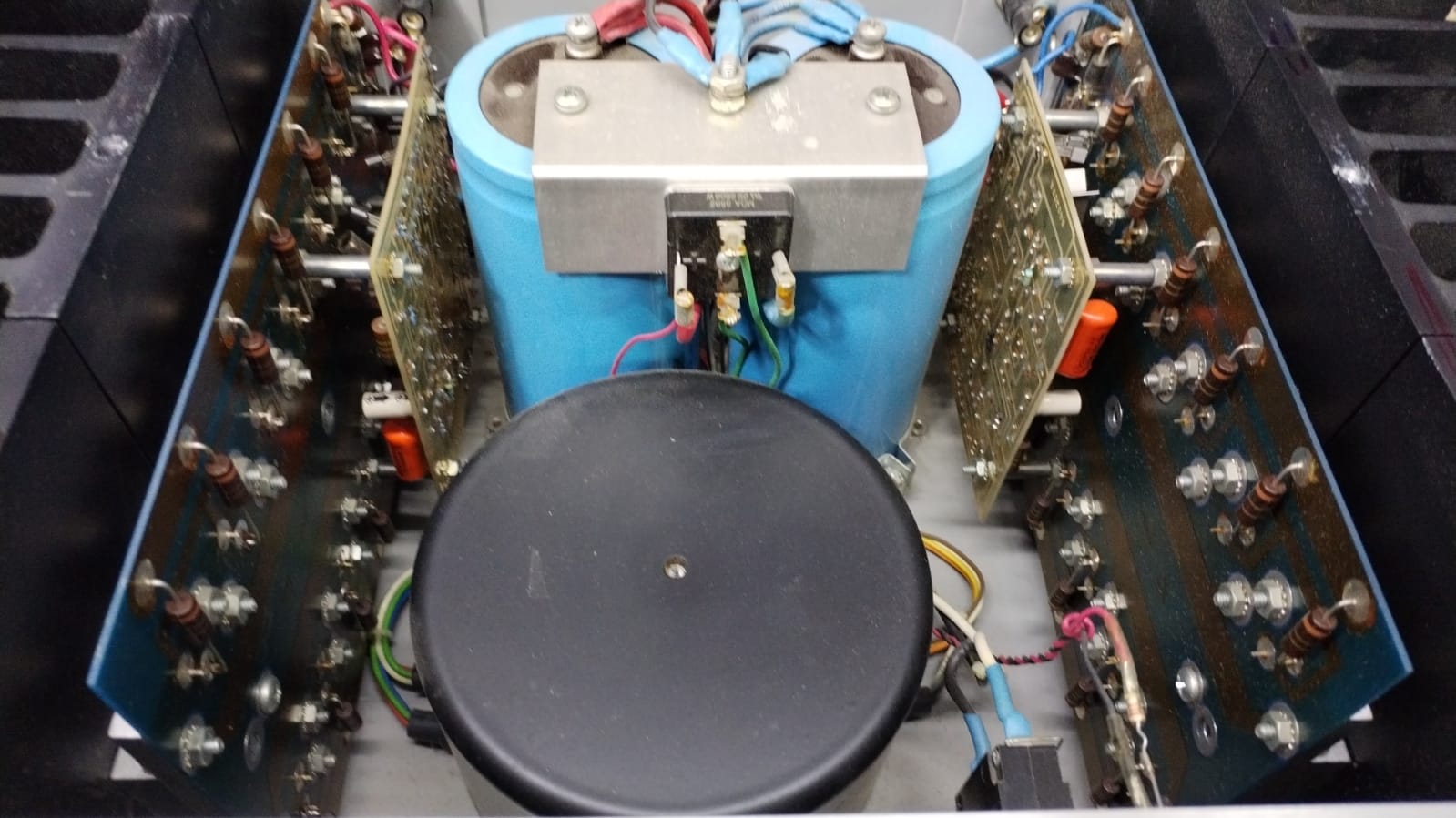

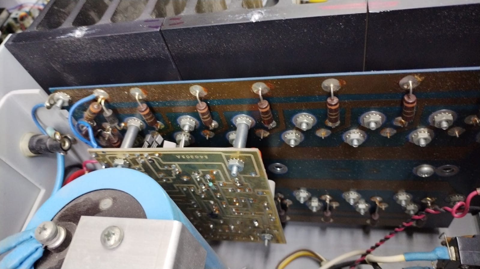

There are two basic versions, the early ones with the output devices cascoded and the later ones with all the output
devices in parallel. I assume yours is the later, but we really need the photo of the front end board in order to
advise where you can make measurements and what experiments will give us more information.

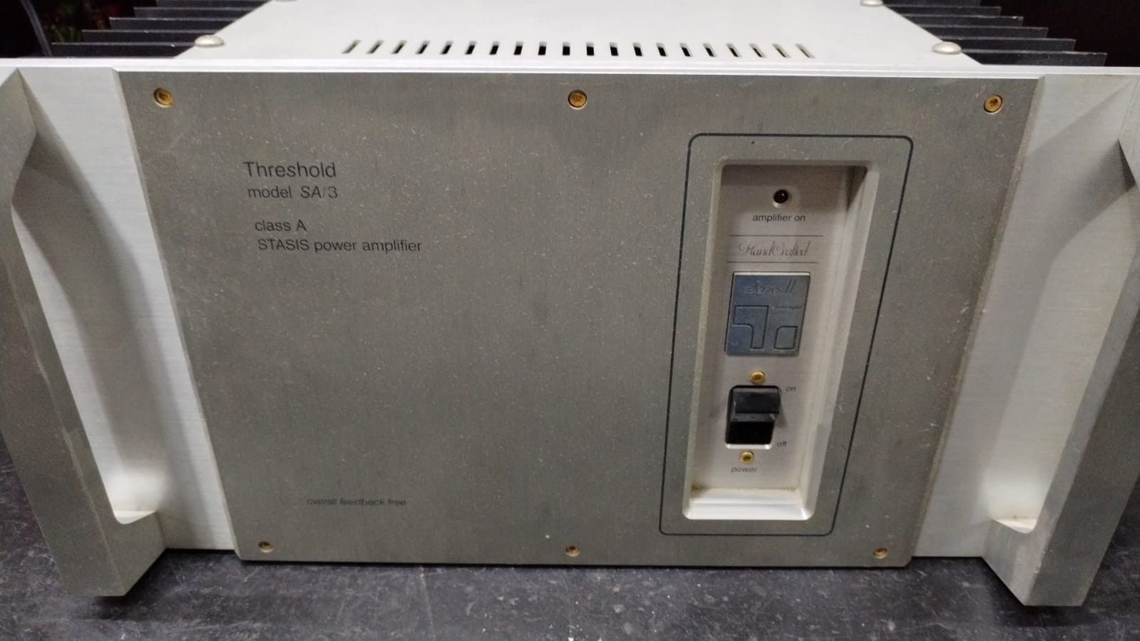

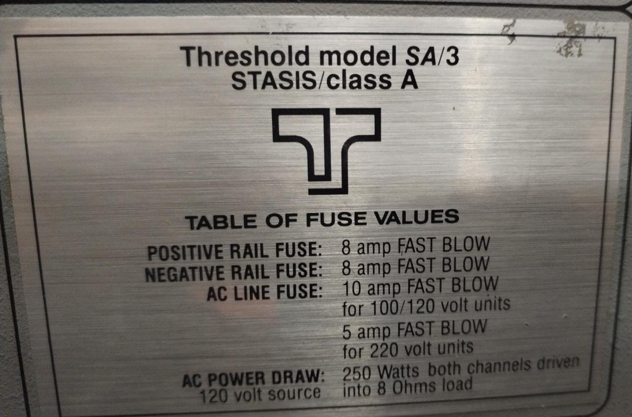

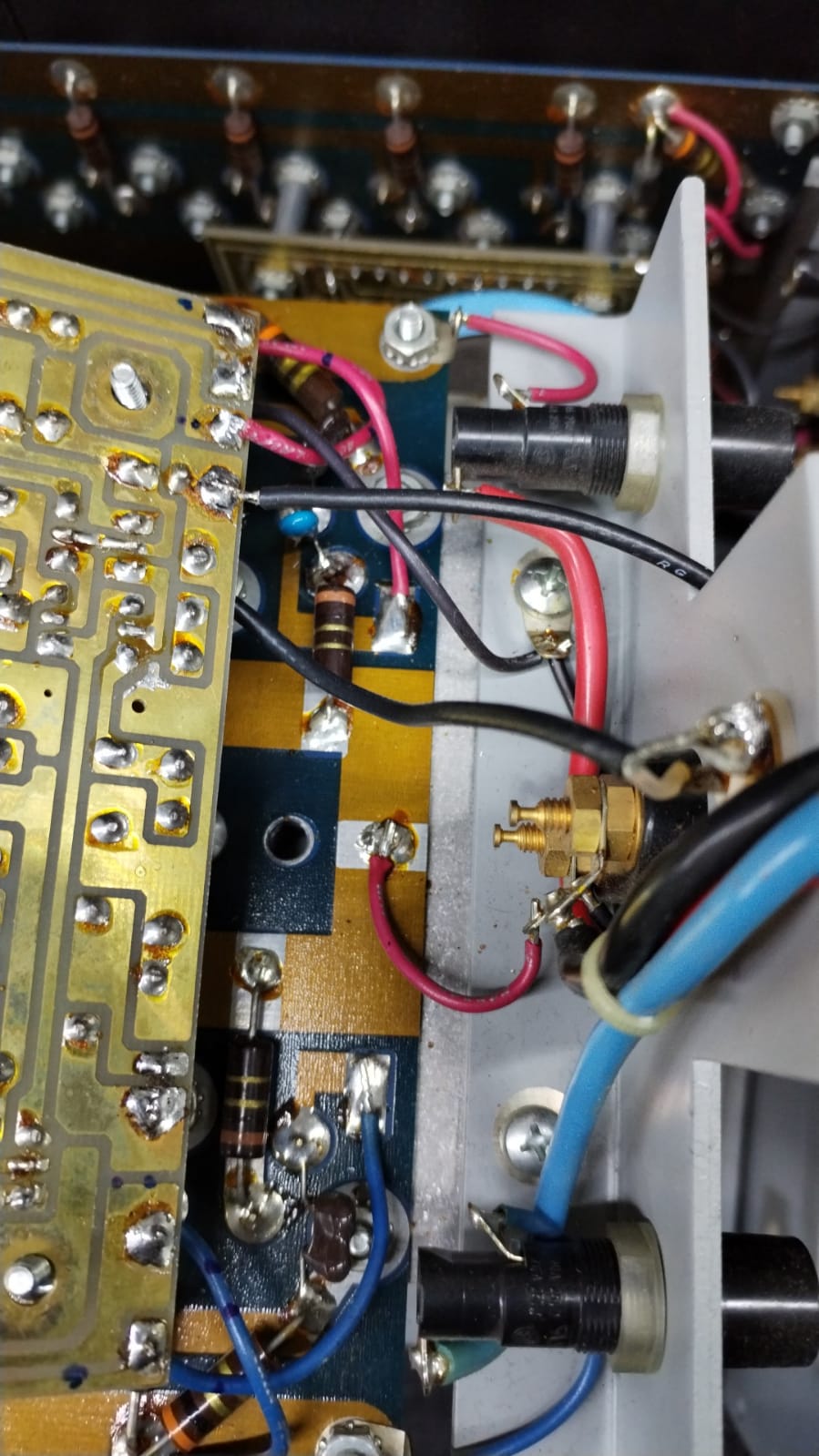

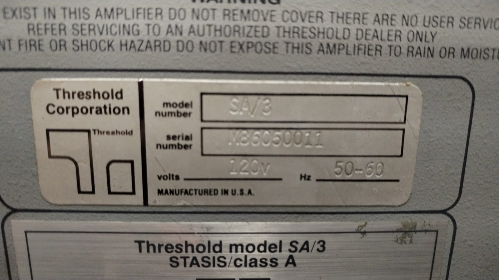

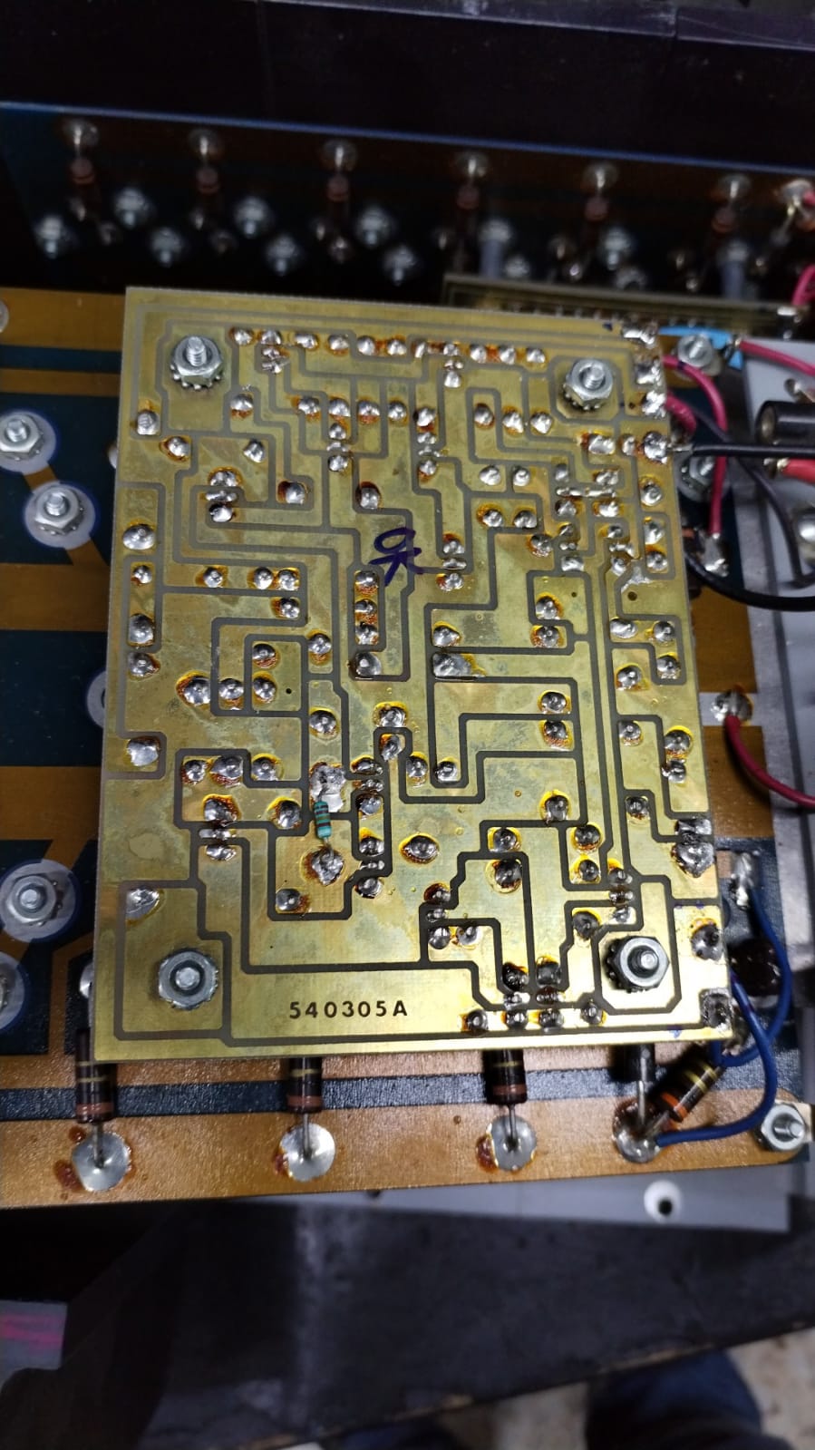

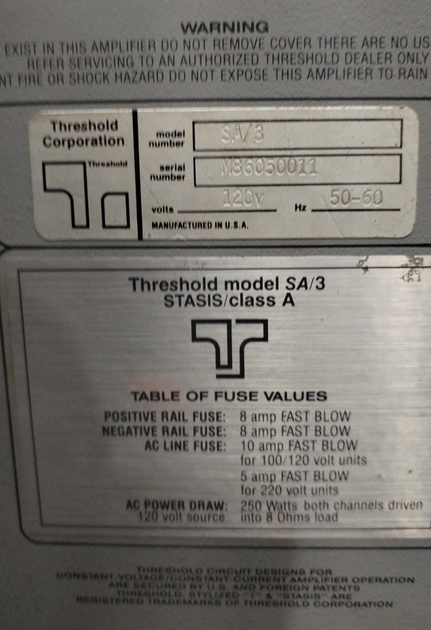

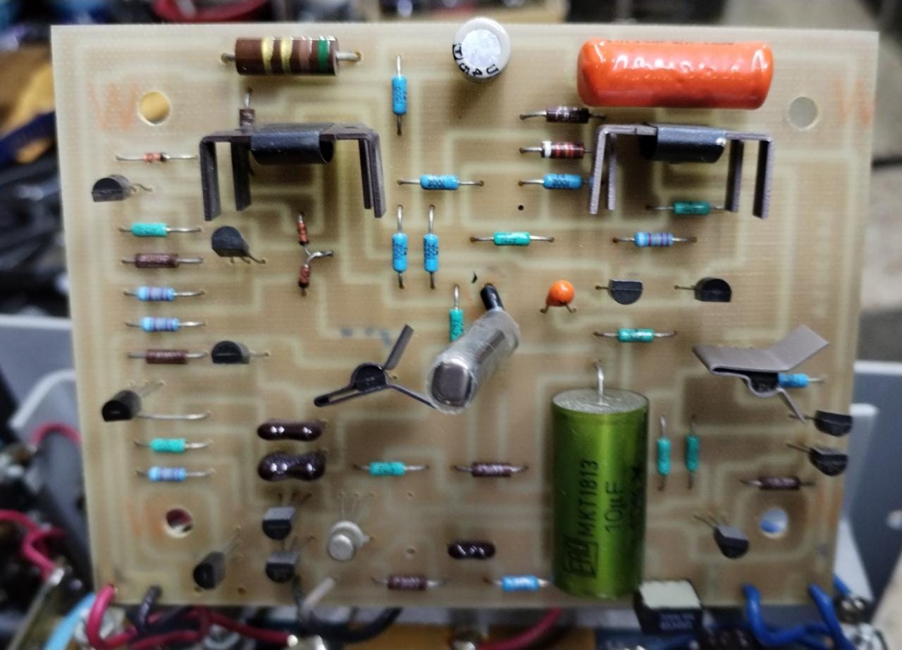

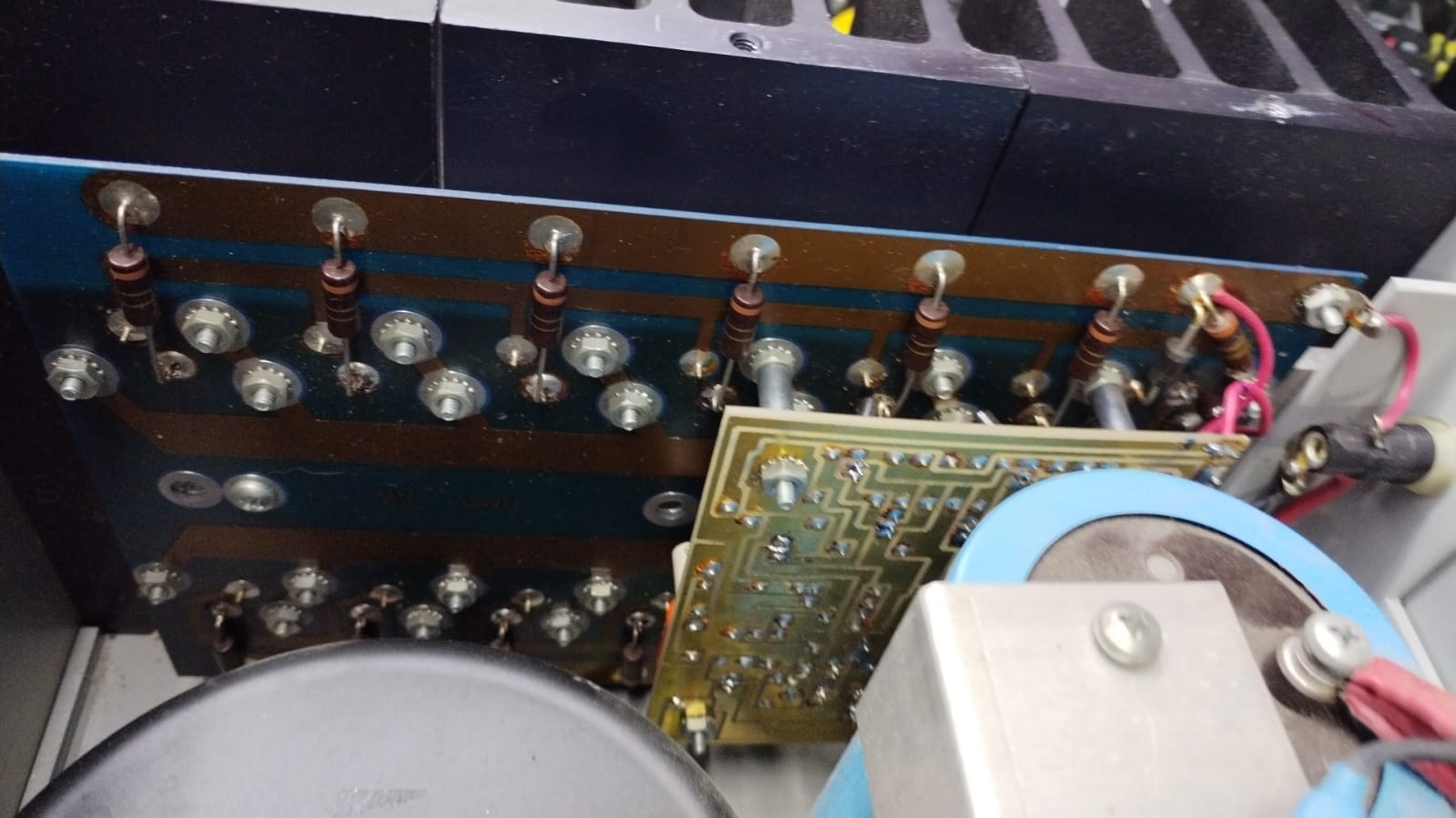

Dear All
Hello, sorry for the delay in sending the photos, I was out of town
Look, by exchanging the drive between the channel channels and changing the channel the failure, I come to the conclusion that it is the drive card where the failure is.
Please tell me if there are any additional photos missing.
Thank you very much for the support
Chema
Chema

I had the same issue. My was in the differential JFET pair. With that being said, you have a class A Stasis amp with 34v rails. That makes for a great recipe for a 2021 Stasis front end swap designed by the big man up above (post #13)
With your amp, you should be use it with the prescribed values only needing to fabricate a way to get the board onto the output stage and adjust the value of the oscillation cap as needed, if needed.
Let me know if that idea appeals to you and I will pull up some stuff. I will say that my old boards are repaired and I have no desire to put them back in. I originally had 80v rails and actually changed the whole power supply in order to get the rails low enough to accommodate the new front-end design
In that case we are in luck because A) this is easier to fix and B) I made up some new boards
for these.
for these.
