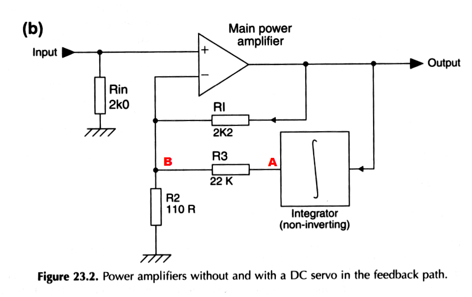

And if you would test a 1s time constant servo on a typical circuit, you will be amazed how much signal you see at its output, well above 100Hz.
Don't forget to attenuate the servo output by a factor of ((R2+R3)/R2) = 201X (46dB) because your oscilloscope is looking at node A, but the amplifier is looking at node B. See Figure 23.2 from Self 6th edition. Errors / distortions introduced by the servo, are attenuated by a factor of 201X.

Thank you for reminding; I am fully aware of that.
I do not want to see any signal at 100Hz, however small or low distortion, from the servo. Hence no servo, unless I cannot avoid. Else might just as well build opamp circuits or chipamps. No need to do discrete.

Then you might want to investigate T. Christiansen's 3rd order servo, which attenuates 100 Hz response (along with servo opamp distortion) by another 45 to 60 dB depending on details of pole location. It's probably the highest order circuit that can be easily realized with a single JFET-input opamp.
