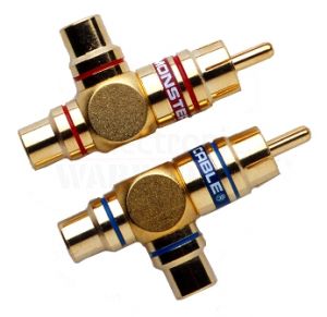

Most MC phono pre amps just have resistor across the input to load the cart, you can not go up but you can certainly go down by paralel connecting a resistor across the input with a Y RCA splitter and RCA plug with resistor from signal to ground.

Tubenut,you are right about the impedance set resistors.If it is easy for bulgin to identify these resistors,I think he can go up also,by replacing them altogether.Also,I think it helps for better sound to have a single resistor than a parallel pair.If with the thiner wire the cartridge impedance is around 15 ohm,using resistors around 300 ohm will give an ''optimum'' load for the cartridge.And,bulgin if there are parallel caps to the input resistors,experiment by removing them completely and see how it goes.Usually,to my experience,by removing capacitors either in mm or mc phono preamps,makes the sound less harsh,more open and sweeter,unless the cartridge in use suffers from really high lift at high frequencies and therefore needs certain capacitance to tame it.
