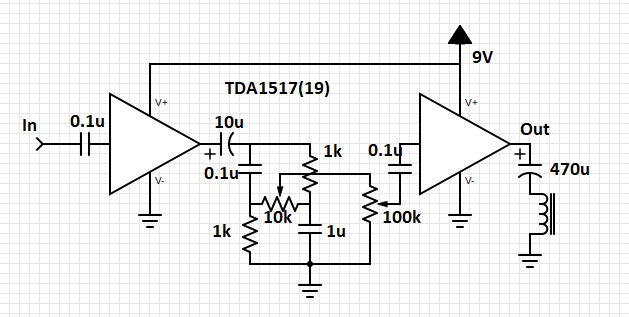

Guitar amp

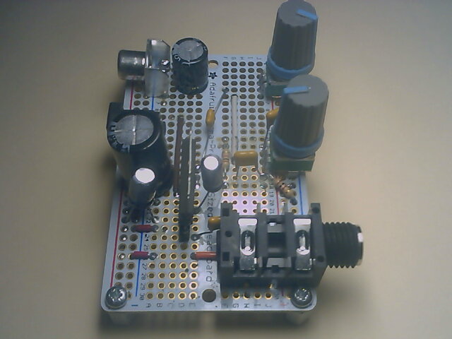

I realize its for a guitar amp. I thought you might put forth a better explanation. Looks like a basic buffer with tone and bass controls? Trying to change tonal quality to make the amp sound different? Why not go inside the amp and change several caps (values and manufacturer)
That's the total amplifier. The 1517(or 1519) are stereo power chips.I realize its for a guitar amp. I thought you might put forth a better explanation. Looks like a basic buffer with tone and bass controls? Trying to change tonal quality to make the amp sound different? Why not go inside the amp and change several caps (values and manufacturer)
I have tried with 1M input w/buffer. There is somewhat better highs, but for my purposeInput impedance is only 60 kohms - not a good loading for a guitar.
( part of which is the elegance of simple circuits ) the tone is OK as is .
