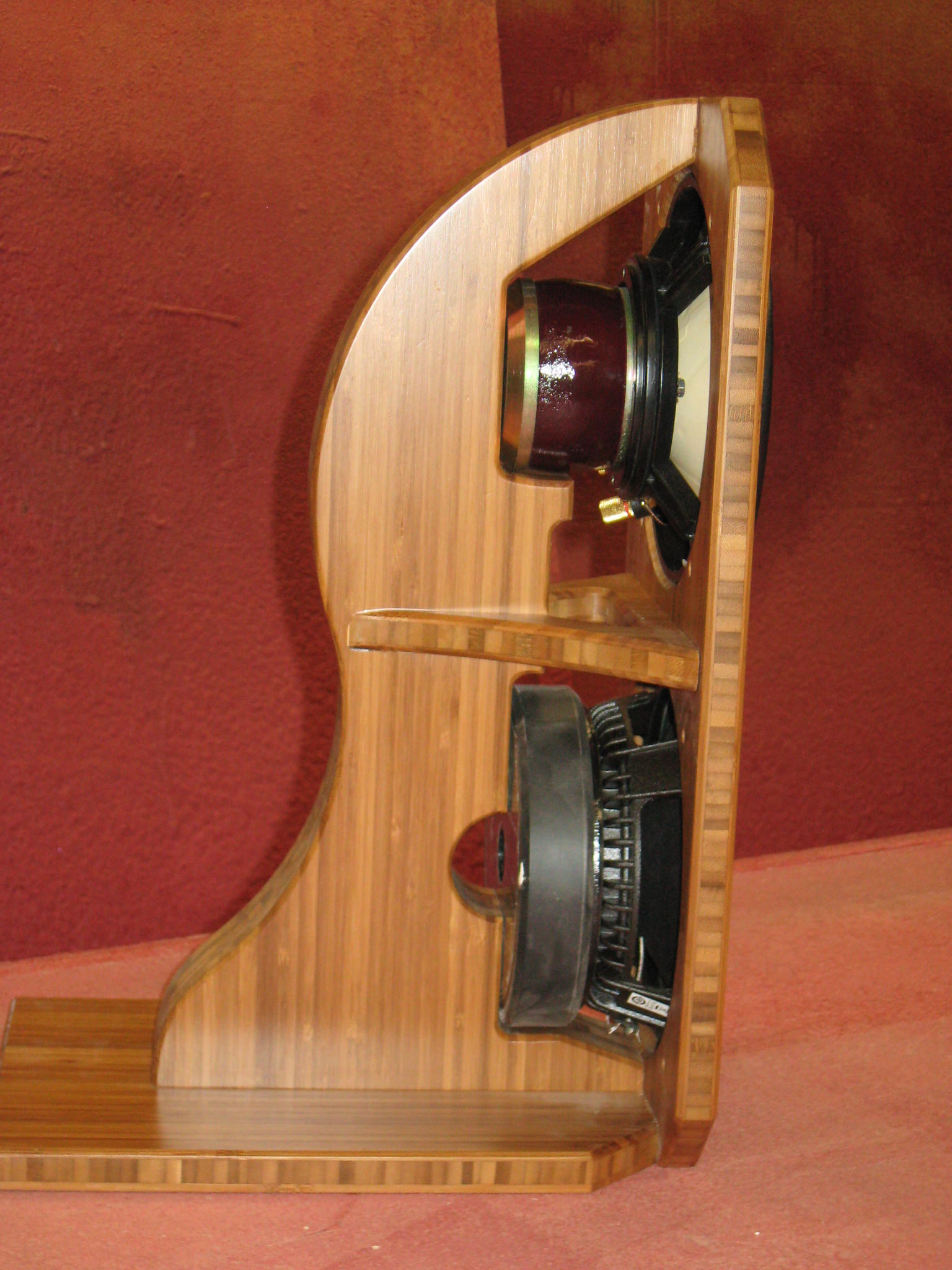

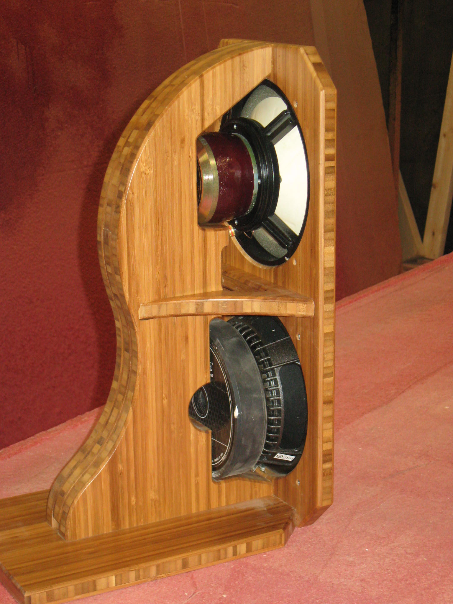

basically the idea is to fabricate some sort of cradle / bracket to clamp around the magnet / motor assembly - generally the most massive part of the driver, to bear the weight and attach to enclosure, and lightly seal the frame to baffle with foam / cork etc.
I've more often seen this technique used in open baffle arrangements.

I dunno about not being worth the effort, and never having tried it myself, can only assume it would be a bit of a bother, depending of course on the dimension / geometry of the motor / frame assemblies.
This is about as close as I ever got, which was fun enough, and don're really want to think about sculpting a full cradle mount for something like the Lowthers

Very impressive chrisb! ...love the idea of a "full ranger" OB combo. As I get more experienced/knowledgeable with this stuff, I'm thinking that design will see it's way onto my bucket list.
Are you limiting the LF driver passively and running the Lowther full range? What is the base driver?
system belongs to Bud Purvine - used with woofers consisting of dual SDX7s per side in TL enclosures
the lower driver in photo is Eminence Beta 8 - the exact details of XO I'm not familiar with (or maybe Bud has described it, but it when in through one ear and ... )
