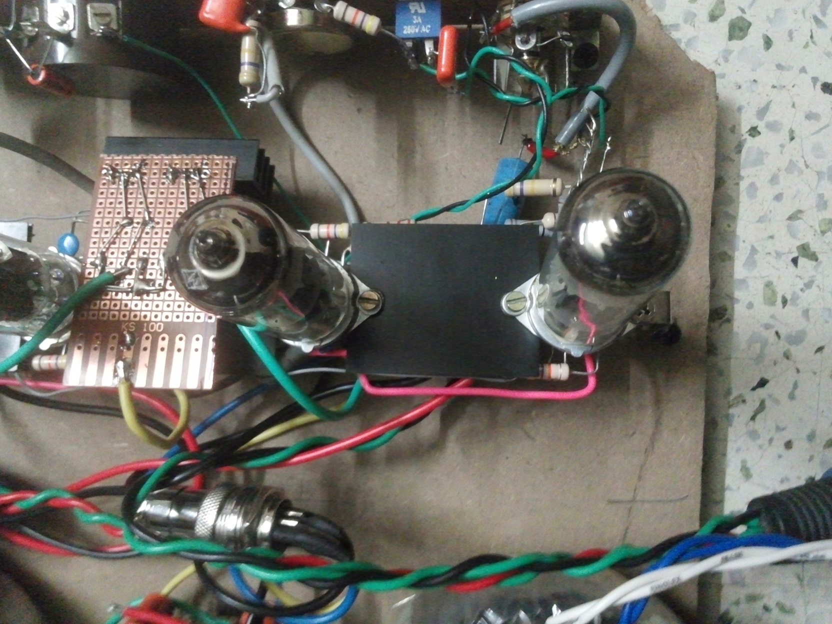

I managed to pick up a burnt out Laney LC15, which Im planning on rebuilding to resemble something like the Plexi 6V6 by Mark Huss:
The Laney is originally a 3 x ECC83, 2 x EL84 amp, so I'll likely convert the schematic from 6V6 to EL84 using the values from the classic 18 watt amp.
Now, my question. The chassis has large holes to fit the 9 pin valves through, and the valve sockets are soldered directly to the PCB, like alot of less expensive modern amps. I was thinking on keeping to a similar construction,
Ive got a 3mm tuffnol board (phenolic laminate) that I could easily drill for turretboard. So, my question is, can and should I punch / drill 22mm holes in the tuffnol board to mount the valve sockets directly? This would mean I could solder the entire circuit together on the turretboard, only going off board for the sockets and pots, which would be a big advantage in construction - the chassis is a bit pokey. Ive seen this done with preamp valves but never with power valves.
Has anyone ever tried this with power valves? It shold work just fine, but as always its a good idea to bounce the idea off those with more experience.
Cheers!
Mikey

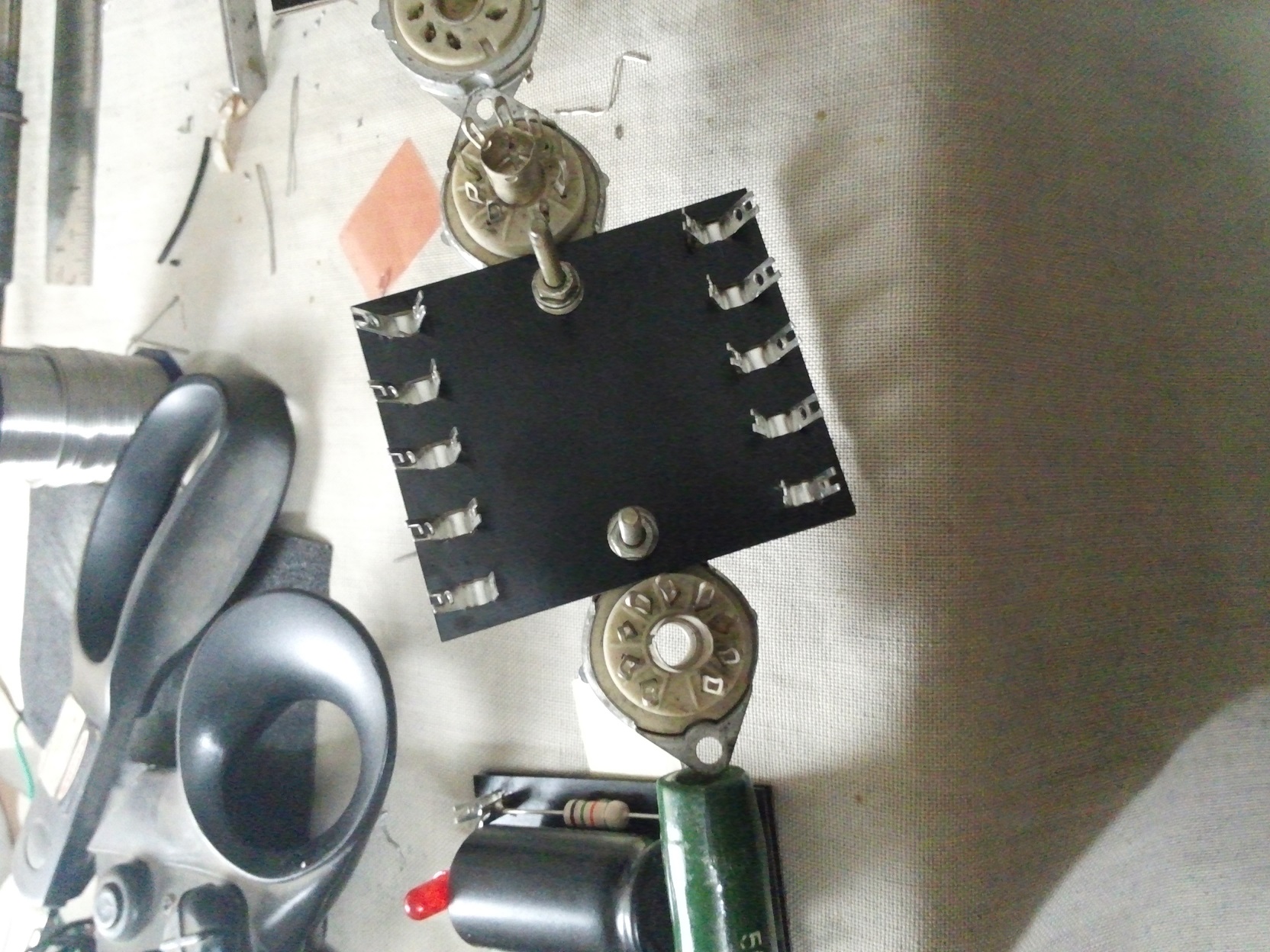

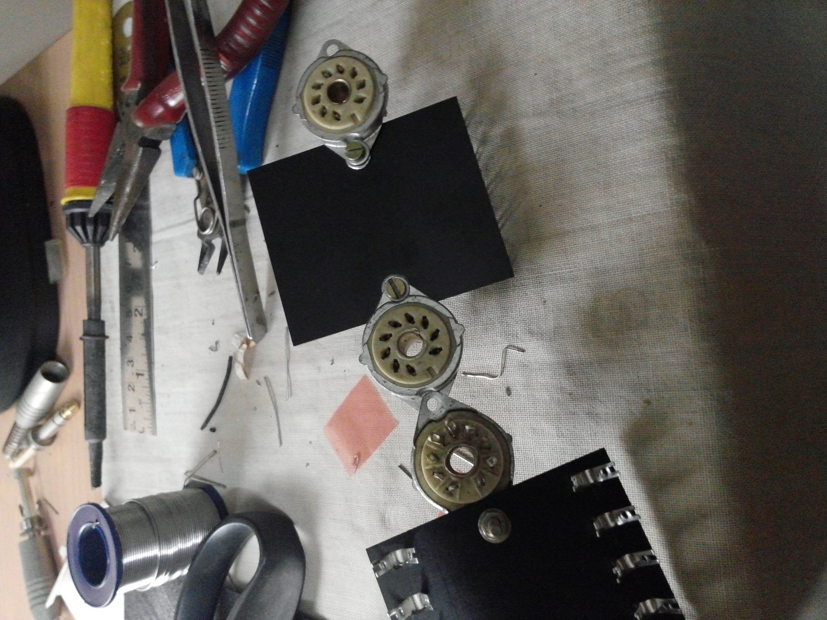

This isn;t quite what you are looking for, but I like these things for small 12AX7 circuits, but they make them in octal as well. Maybe it will give you some ideas. WOuld be no problem to switch the sockets to the other side of the board, for example.

Another source, whom I've used: Products
