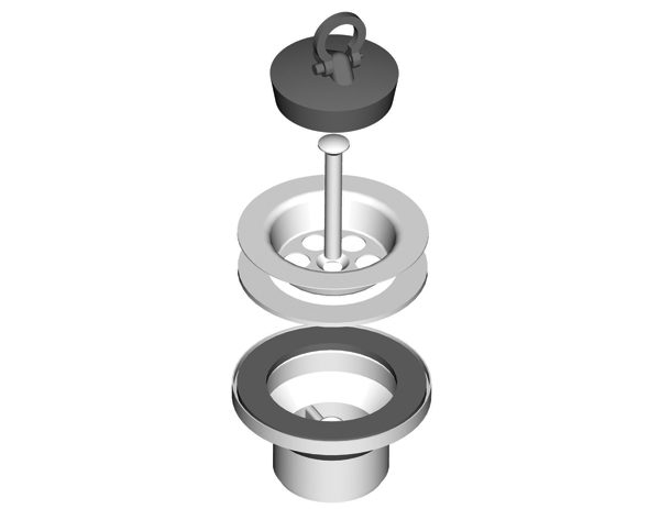

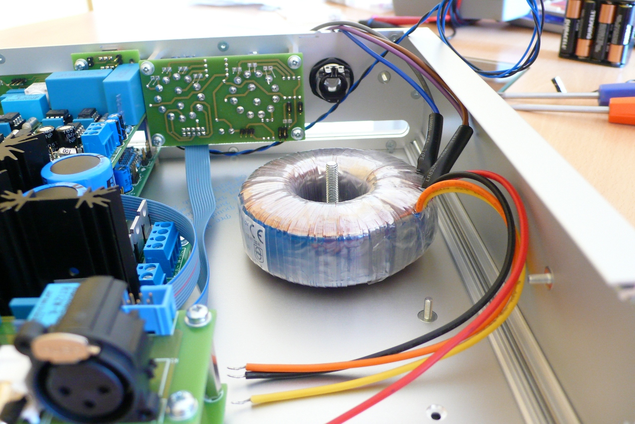

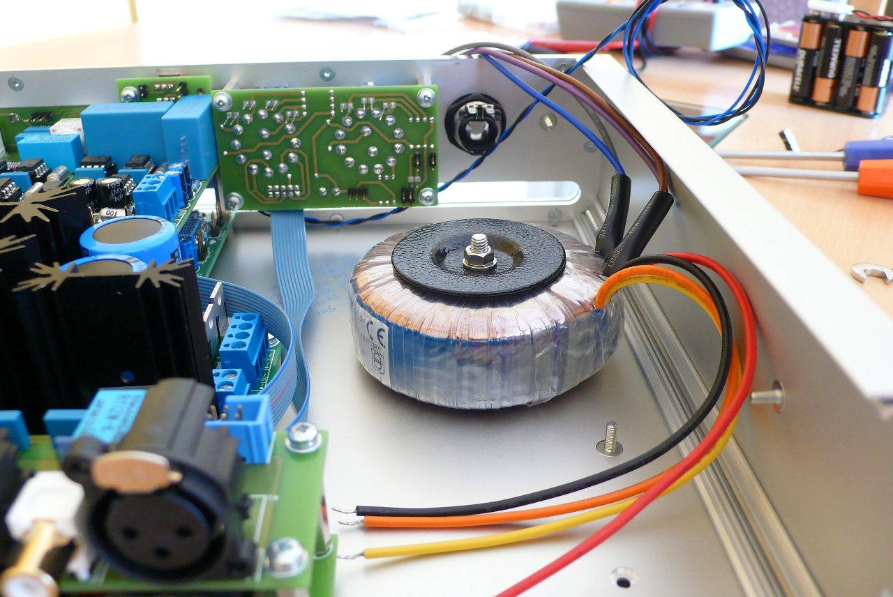

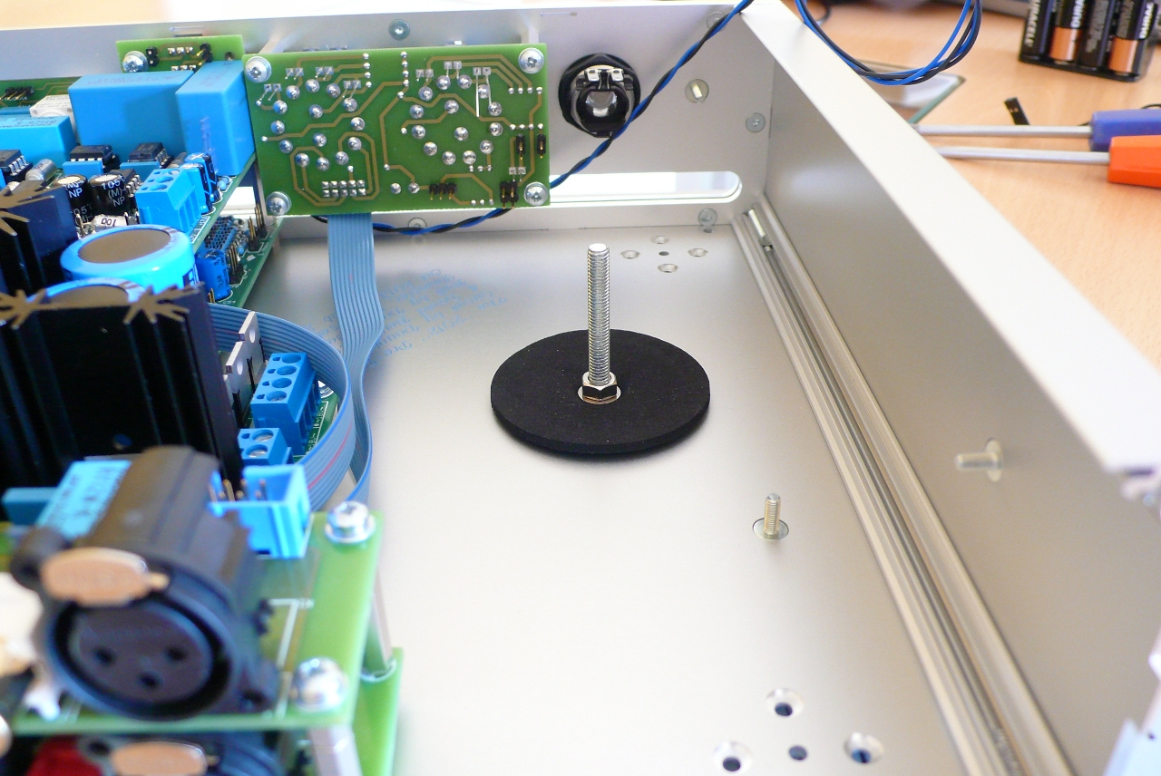

sink assembly parts can also be useful in this case 🙂
