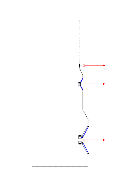

I didnt know if there would be much impact on resonance, having 25mm (baffle thickness) of the cone out side of the internal enclosure ,if I mount the cone from the outside (having to apply a foam tape seal) bringing the speakers more into alignment
I'm not the expert here and I can't help you with calculations but the tweeter should be mounted backward too if you're concerned with phase issues.
I know I have an example in some magazine but right now no time to search...
