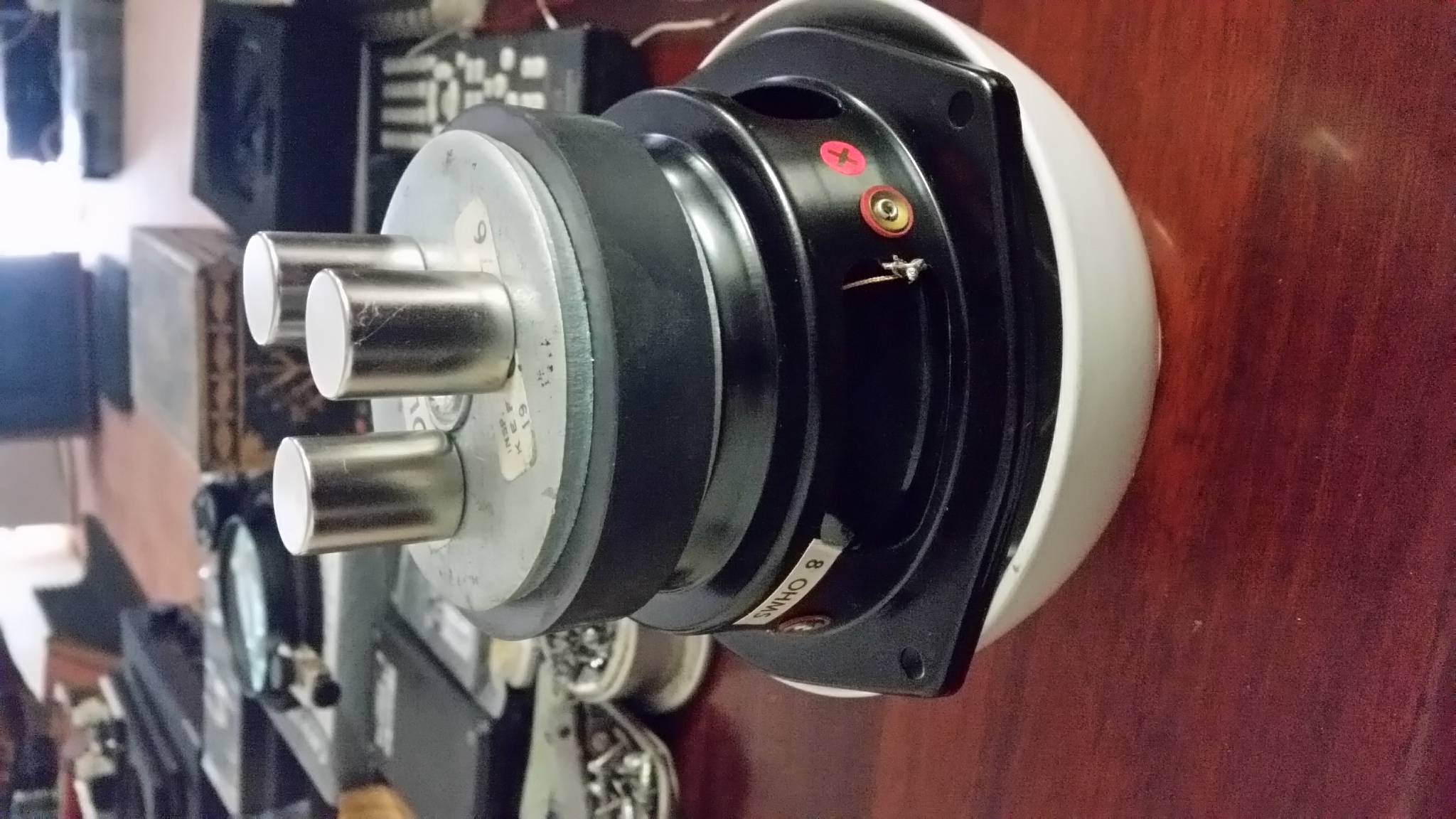

Up until around the early 2000's Scanspeak sold backing magnets for quite a number of their loudspeaker drivers. So why don't you contact Scanspeak Streten and tell them you are so glad that they stopped that idiotic practice of selling backing magnets to IMPROVE the performance of their loudspeakers.
Lastly I will add that I proved the lowering of the driver QTS with a pair of Vaf 151's. They were excellent speakers from the get go with Seas drivers & 2mm dia wire hand wound air core inductors. I took them to Adelaide speakers to see if they could be improved further. 3 Neodymium magnets were added to the bass/mid and a new crossover designed for it.
The new design lowered the QTS to the point where it no longer worked sealed and needed a small port.

The Neodymium magnets I can get out from China if I buy enough cost me depending on currency fluctuations & the price peaks & troughs for Neodymium between $5 & $7 Au landed per slug as pictured above on the B110. I have found quite the opposite to be true. But in the interests of keeping the peace I will refrain from answering any more questions unless it is related to assisting in answering the original poster & his magnet to magnet question that has been answered in full by previous posters. My sensei always said it is shameful to combat unarmed opponents
