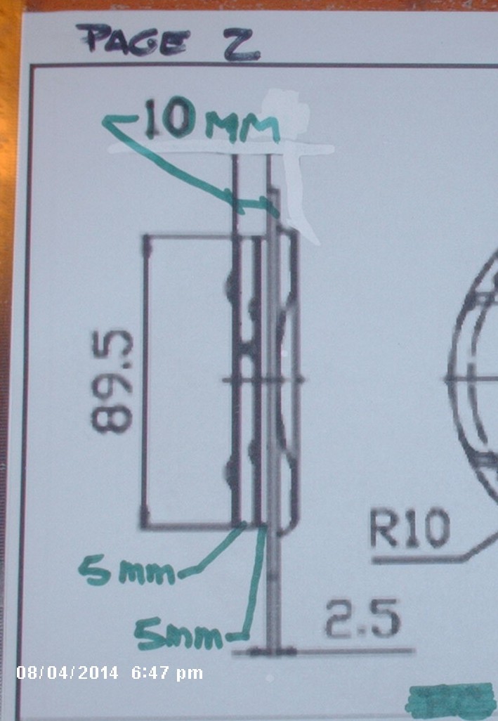

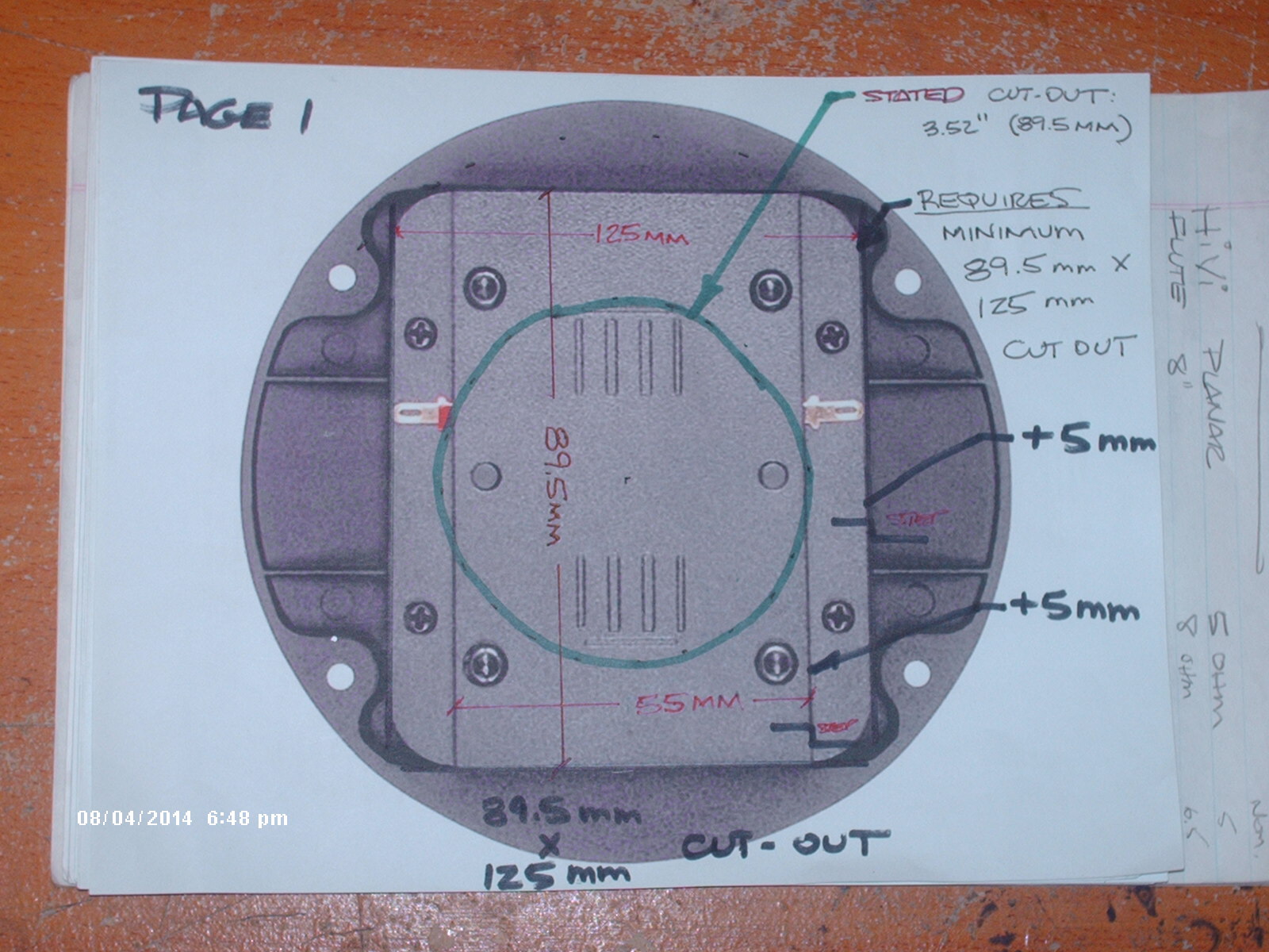

Can anyone tell me the correct cut-out to mount the HiVi RTC1-A Planar Tweeter?
PE says 3.52 inches dia. but that is not possible.
According to my measurements a cut-out would have to be 89.5mm X 125mm. or the gasket will not contact the cabinet. There are 2 (two) rectangles projecting above the gasket by 5mm EACH. The largest rect. is 89.5mm X 125mm.
What about the electrical connectors?
Please see pictures.
Any ideas appreciated. I am unable to get a correct answer from P.E. or Swan.
P.S. P.E. states the crossover point is 3kHz. Swan in all their literature require AT LEAST 4.5kHz crossover.
