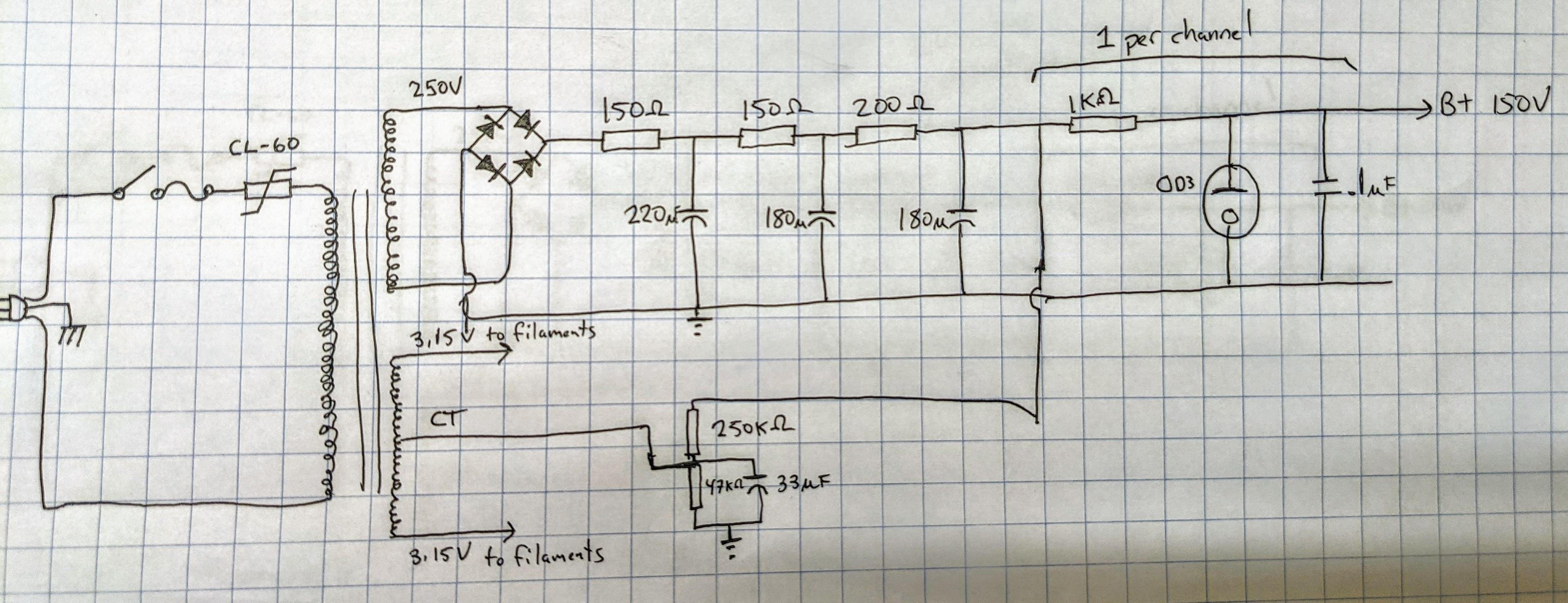

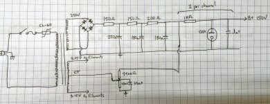

Each resistor is one stage of a 3-stage RC filter to deal with the ripple in front of an 0D3 voltage regulator tube.
When I was initially spec'ing out these resistors I based my order on the LTspice sim which overstated the dissipation probably due to the inrush current of the capacitors charging at turn-on.
I took some real measurements just now -- once the capacitors have charged the resistors are only dissipating ~3-4W continuously. That said, at turn on I measured the first resistor momentarily dissipating ~20W. The resistors are rated at 30W, 15W, and 10W, respectively.
Still learning as I go.
I've attached the power supply schematic for your perusal.

All three resistors have the same average current (Idc) flowing through them. So the 2 x 150Ω will dissipate the same power steady state, and the 200Ω one 25% more.
The AC ripple currents will diminish from input to output, but the ripple current have ±values centred on the average and don't affect the average current. In other words the ripple currents don't cause any additional power dissipation; only the average current value is important for power dissipation P = Iaverage x R.
Yup, I went overkill on the size of them. Lesson learned.
