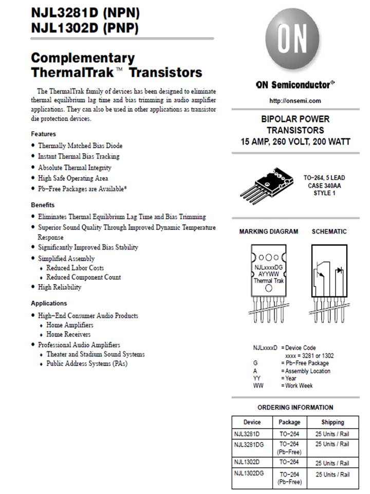

Can you still change to the On-Semi ThermalTrak transistor+diode? These transistors are used in many top rated amps. There are several good threads on how to optimize tracking with the attached diodes.
For TO3P packages you can use a large washer to clamp a small diode to the top metal tab. The diode leads need to be insulated, and the washer cannot make contact to the heatsink.
To minimize the thermal lag of a large heatsink, the diodes can be clamped or glued to the plastic back of the power transistor. A Dremal tool can be used to grind a grove into the plastic package for a small diode. Some engineers use a large aluminum bar running over the back of all transistors as a uniform pressure clamp which complicates this type of diode-package attachment.
That's a cool product!
I think I'll stay with my current output devices, NJW0281G, since I already have a number of them on hand.
But that's good to know such a thing exists, thanks!
