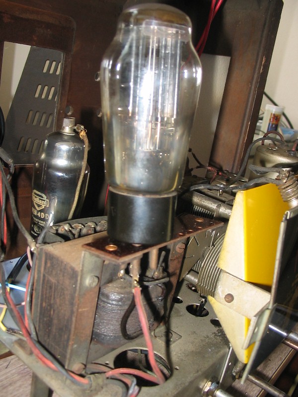

Back in the vacuum tube TV set era, they often used power transformers that had, on the top bell, the rectifier tube. A power transformer with a rectifier tube sticking out of it on top. Saved chassis real estate, and inside a TV set cabinet, vertical space was plentiful. Also it placed a heat source up and away from other parts of the TV chassis. So what you are thinking of doing, placing your rectifier above the toroid transformer, should work fine. Just give consideration to heat and insulation. Stray 60Hz magnetic fields wont matter to a rectifier.
